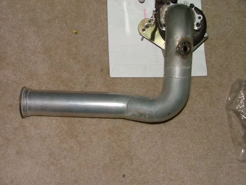

I'm making all of mine... borrowing a welder from work. and it's increadably hard to make tight bends like the S-pipe, mine will be one 90 degree turn, and 2 45's
in my head lol theres a similar photo of somethin simalar I am going to do in an FS thread... I'll try and find it.
I will be welding the bends since I ont have the equipment to bend 3" tubing and the brackets to atach to the mid pipe will be like the ones on th stock setup.
FYI that is a setup the LinuxRacer may be selling, it is for a T3T4 setup with MAM exhaust mani.
