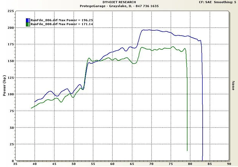

I forget who's car this was or what mods were on it but it gives you an idea of the gains. You do take a hit in power for the lower rpm but the high end more than makes up for it.

Dam since I got kens attention. I heard that you feel less restirction and it picks up better??? When I install it. Is there anything I should look out for????
