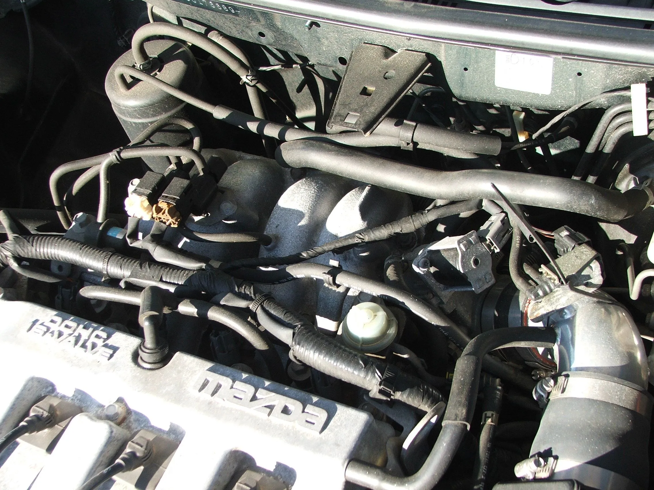

mine is a pre-2000 also. there is a way to modify the stock fuel lines to accept the old style fuel rail. I'm curently running injectors from a MX-6 with bosch jetronic tips on my stock manifold and fuel rail. yes I know that the old style injectors flow a little less than the newer fs-de injectors but on a 1.8L it is an upgrade. the injector solinoids are bigger too. same injectors in the picture
I still have a haaard time telling the difference, between the 626 manifold and the stock 323...
Does anyone have something like a picture or the likes to compare the two...?
Its hard to see anything on my picture with all the wires and crap, but you get the idea of its shape/size.

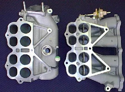

like a lot of things its whats on the inside that counts. the 626 manifold is a one piece straight through manifold. the Protege (323 in your case) is a two piece manifold with buterfly valves (for VTCS and VICS). How many performance based cars have a system to cause Turbulance (resistance) in the intake to heat up the motor faster with Two ####ing cats pluging up the exaust. Zero. These FS motors are SULEV (super ultra low emissions vehical) compliant and these are cheap grocery getters. now they can be modified to be hardcore performance monsters but they NEED to be modified. stock manifold is crap. the 626 manifold is better. but a Properly flowing manifold with a large plenum and high velocity runners is best. or a good set of I.T.Bs with an airbox like bmw uses on all of there M cars. (american S50 and S52 E36 M3 motors not included)

Soooo...do you take out the VICS as well.... for the stock intake manifold? It seems tho that the vics ports...the air lead to nowhere... whats the deal

no you wanna leave the vics ones....at higher rpms they engage and give ya more air

Oh, that picture is spot on. Thanks.
Regarding the VICS, I seem to remember it being used more in the US, than in europe, but I may be wrong. Other than that, my FP-DE doesn't have it...
As far as I know, its only the 2.0 FS that has it, so I should be going after a 1.8 626... right?
