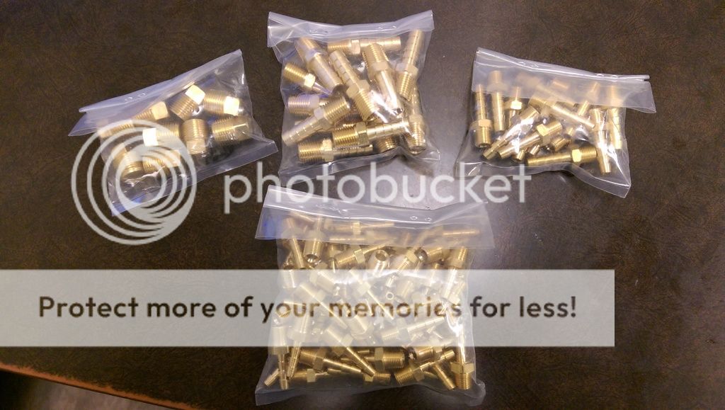

EGR Kit includes remote mounting bracket, valve flange, in/out hoses, fittings, and hardware.
