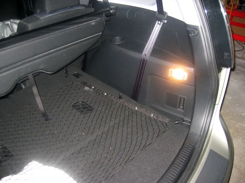

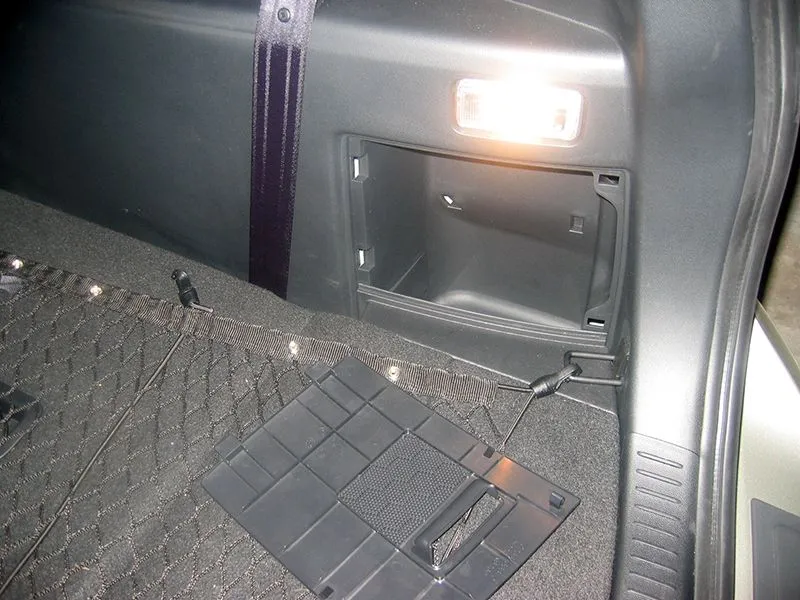

Here is the 5 (which may have a different compartment than the 3 or Protege) It's at night so may not be as visible but should give you an idea. It's about 8"-9" wide. I think the 6w0 would fit in there but I just don't know where to start about making the enclosure.

I could get an 8" in there and it would probably be the same amount of work as putting an 6" in. You would have to fiberglass the entire compartment to stiffen things up, and then fasten a baffle to the front made out of 1/2" or 3/4" MDF that would replace the current cover. If you mount the woofer from the outside it will give you an additional 3/4" mounting depth bringing the total to roughly 5.5-6". That is more than enough for something like an Image Dynamics ID8v3.
If I went with a 6, I could maybe get the cover to go back into place and keep the look clean. Granted it may or may not be a rattle issue, but as a family car I don't want an exposed 8" woofer in the rear where groceries, heavy items, bags, toys, etc may be flying around.
If I were to go with the JL audio 6.5" (depth is about 4"-5" and 6w0 only needs 3.5") and built this out of fiberglass, where do I start? Also, I assume the fiberglass would then be a permanent part of that compartment as I can't see how I'd get it out. If so, I'd want it to look at clean as possible. I've bookmarked a few fiberglass websites but if you can pass along any tips that would be cool. Great job on your box btw. I also need to know where to get all the supplies, fiberglass, bondo, fabric, baffles, etc.
My overall goal, while wanting full, clean rich sound is minimal or zero intrusiveness. I don't want a sub box taking up room and I can't have exposed amps or woofers. So, any way to have a sub in that compartment it would have to be hidden and protected. Ideally, I'd use the same cover.

AS for the 6" sub...not unless you are gonna use 4 of them. THey will leave you wanting more. In short, you will barely even hear it. Not to mention, you will have to build a custom fiberglass enclosure to install it in that compartment and that kind of time and material cost is a big waste for a single 6" you won't even here. Do yourself a BIG favor and make a small test box out of just MDF for the 6" first and get it hooked up. This way you will know exactly what to expect for sound from it.
I would go with 2 8"s. or even a single 10" instead in a standard box that will fit up against your seats. They don't need to be in a large box and they only need 125 watts rms or so these days for the entry level stuff. Plus you just buy the box/sub as one peice and plop it in. No major time or money wasted.
