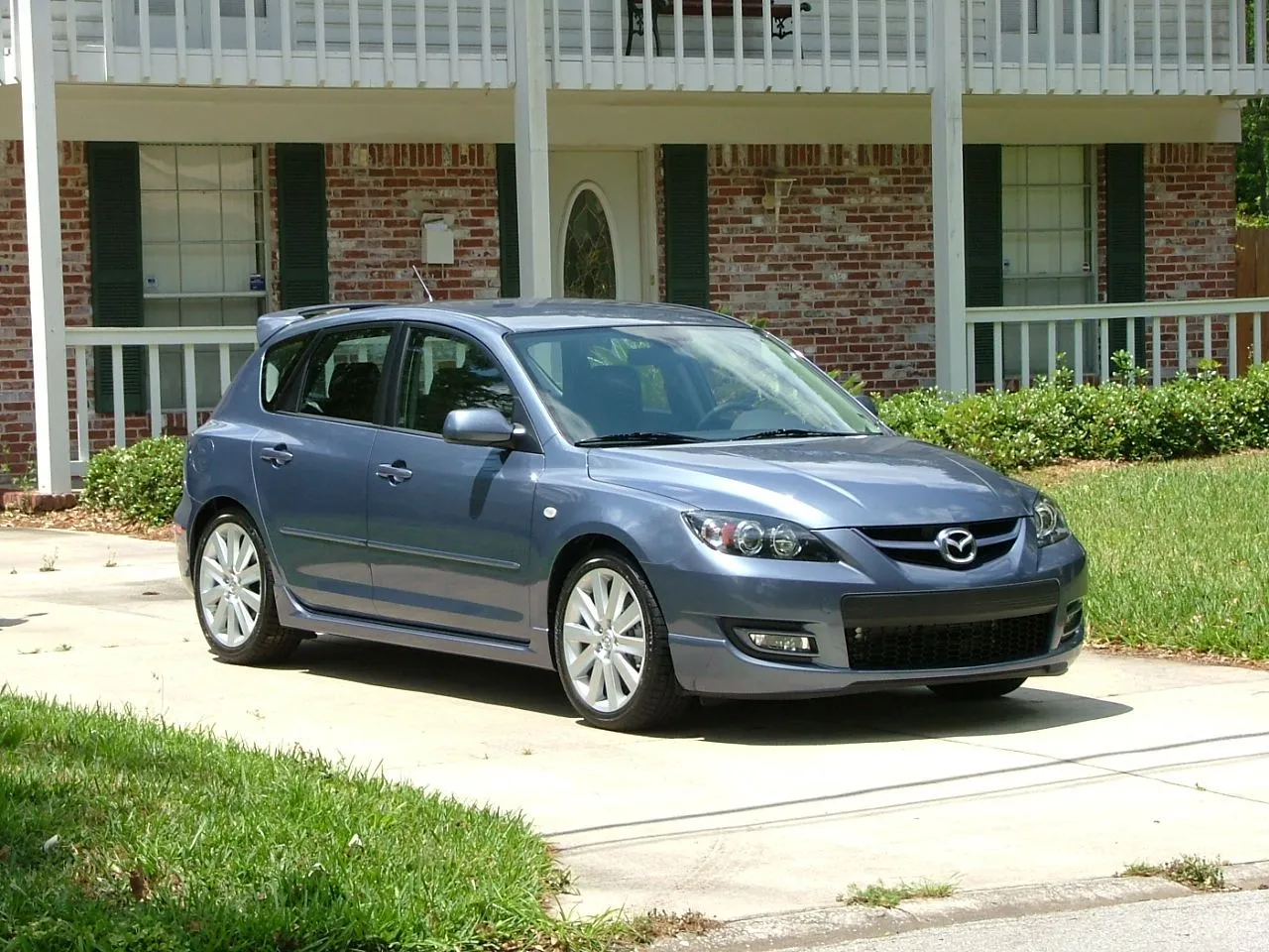

I have the clear bra and love it.
ummmm, i dont see much, but as long as it helps to keep the nicks off, ill get one. where can i get one?
That's the point. It's 8mils of clear teflon adhesive. It completely works and the kit comes complete with sections for the kick panels and mirrors. I will say one thing however, wash the bugs off in a timely manner or they will be a b**** to get off.
