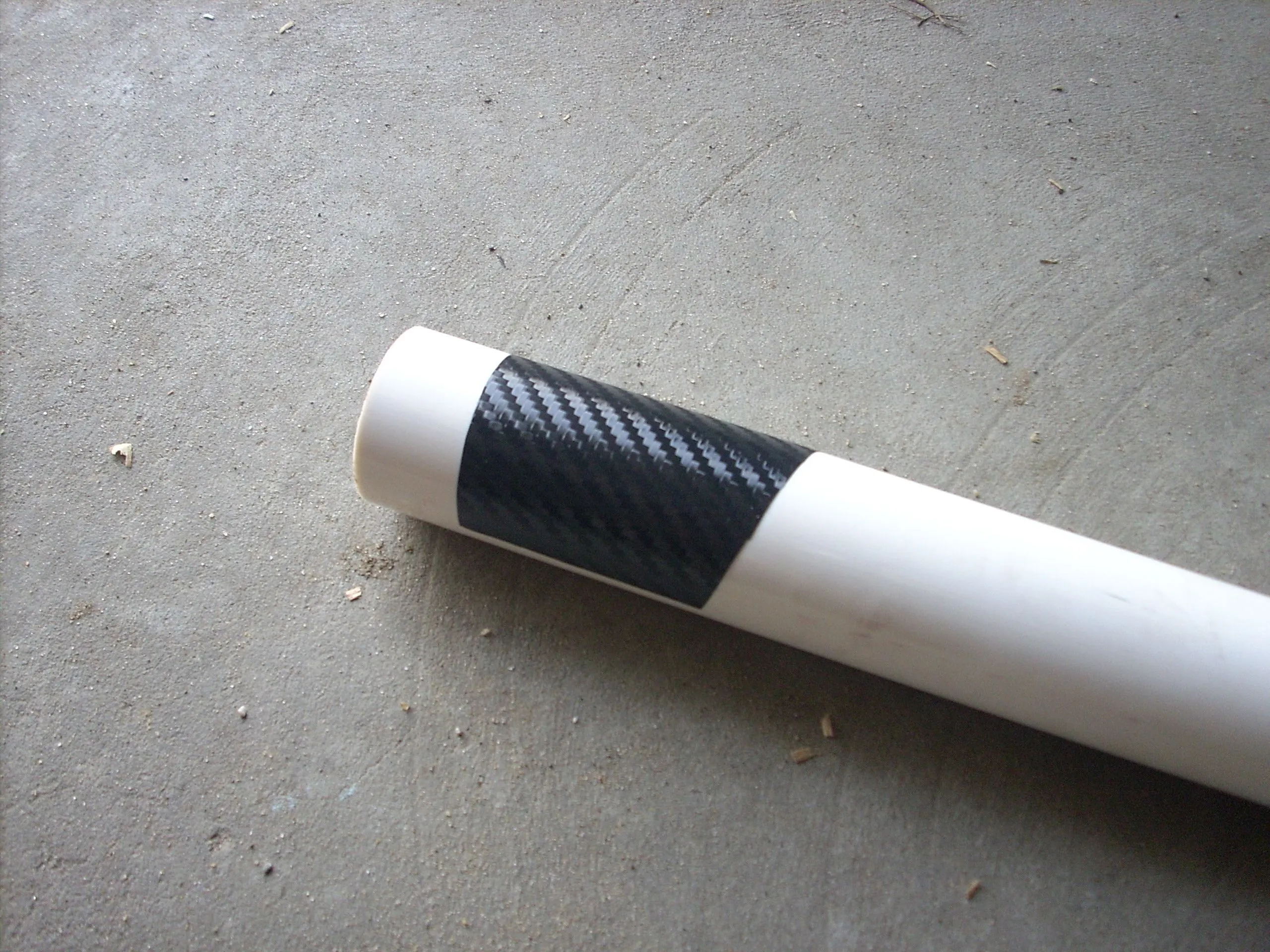

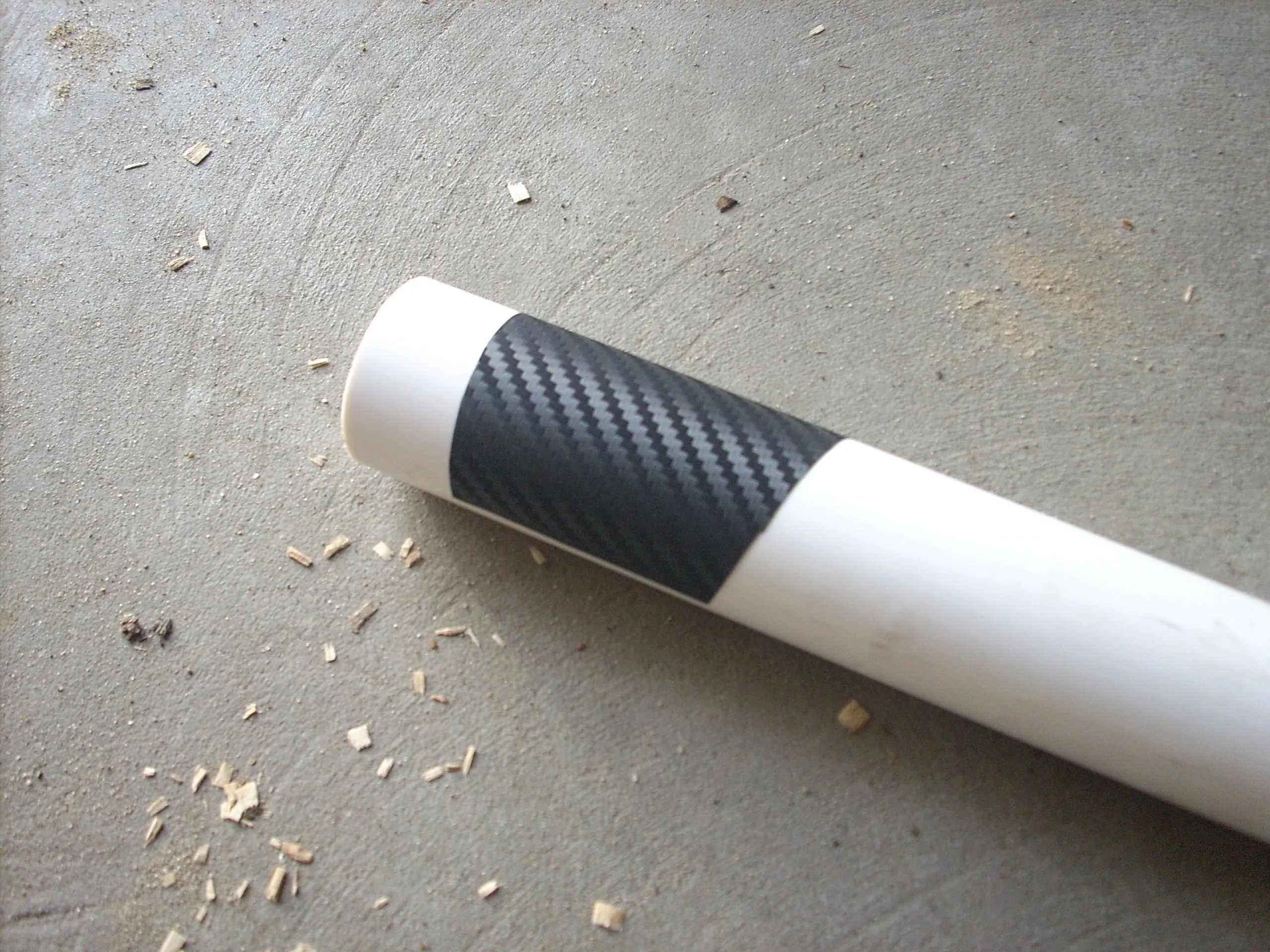

OK so here is the stuff with one coat of Duplicolor Protective Wheel Clear Coat
First pic is regular 3M second is with clear coat
