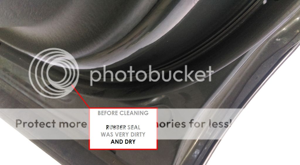

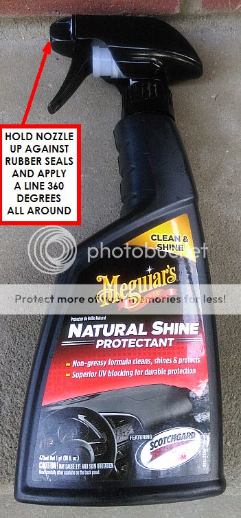

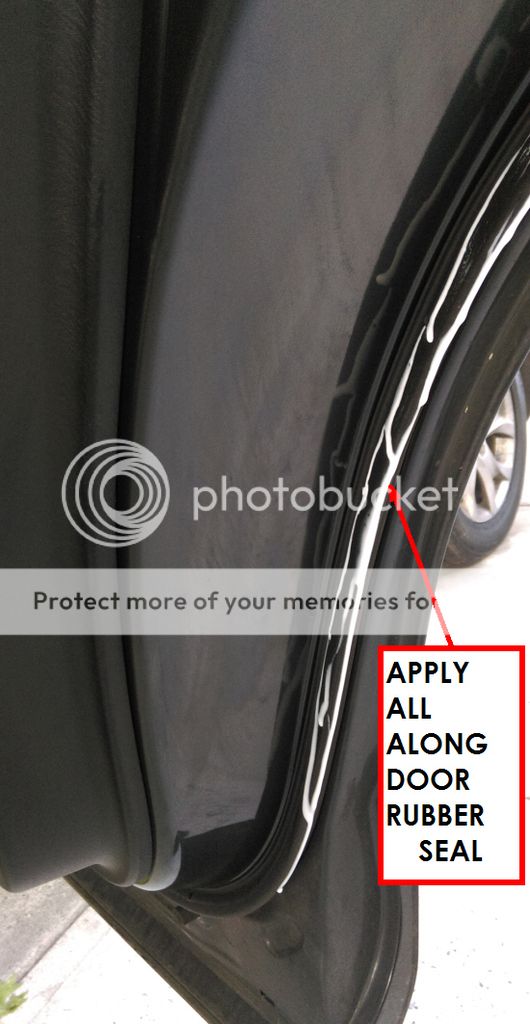

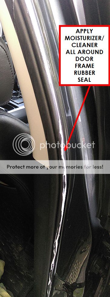

I ran the Meguiar's protectant all along the door AND frame seals on all four doors then wiped it with a microfiber towel, while I was doing this I noticed how dirty, dusty and dry the rubber seals were, and thinking to myself maybe my buddy does know what he's talking about...

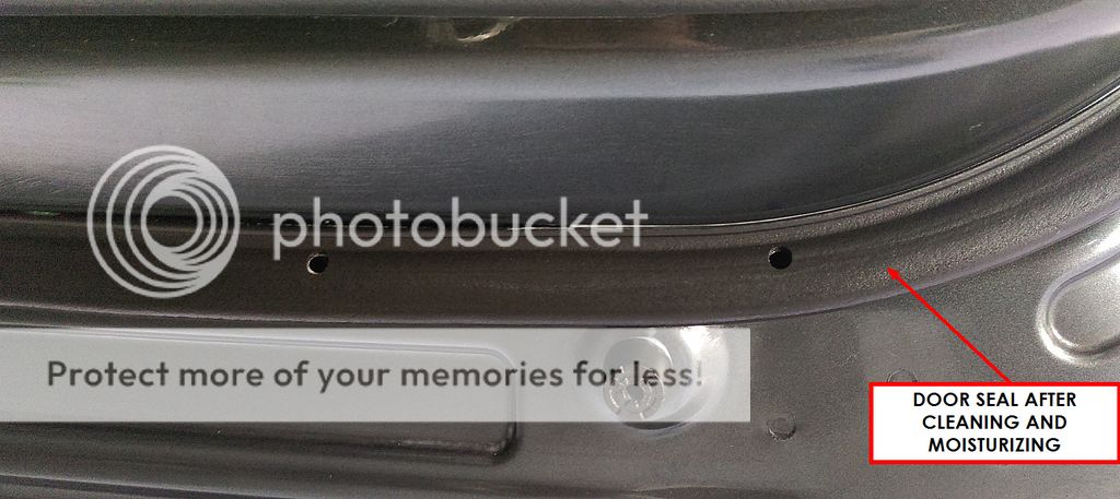

Anyway, after doing the procedure , I WAS SHOCKED ! there's definitely a noticeable reduction in noise and eliminated
the wind noise I was hearing. Also noticed how the dried rubber seals looked brand new again after cleaning and moisturizing them.
Don't expect it to be Rolls Royce quiet but it was like when I picked up the car for the first time "brand new car quiet" and boy the Bose system never sounded better.

NOTE: DON'T use WD-40, just stick with the Meguiar's Natural Shine
I found a YouTube video online showing the same thing but he used a silicone lubricant,
I find the Meguiar's to be better and easier to apply
