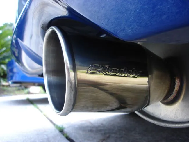

Well if I can get anyone to please post some real life pictures of the Greedy SP2 installed and before on the MSP that would be great. So far this is the only exhaust I like that has a stock muffler look to it.

Thanks to MP3Architetic for the pictures he provided...Trying to get some under neath the car to see the bends and what it comes with (i.e. resonator if anything else)
iirc, the greddy sp2 has two resonators. the bends follow the same path as the stock exhaust. you may wanna look into a magnaflow universal oval muffler. you could keep the stock look that way.

The 1st design had 2 resonators. It was sold that way for about a year. Now the Greddy is sold with 1 resonator.
