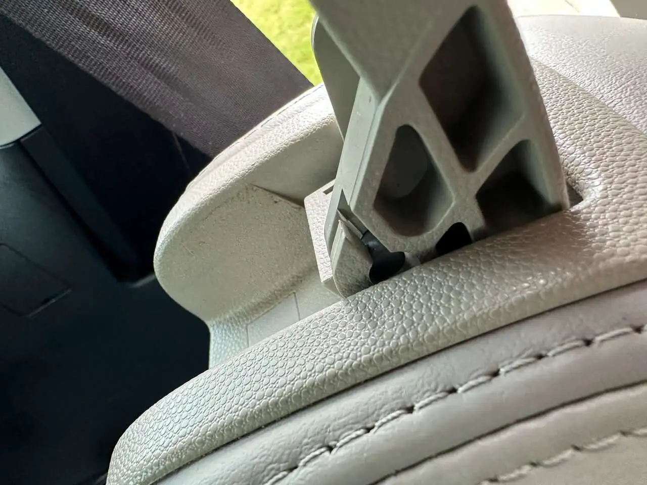

My 2015 CX-9 2nd row fold down handle quit working (the one on the top of the seat back). I removed the plastic handle to find the collar holding the release cable had broken. Thought I'd found the problem but it seems the cable quit working, hence the broken latch when someone pulled it.

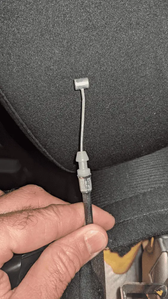

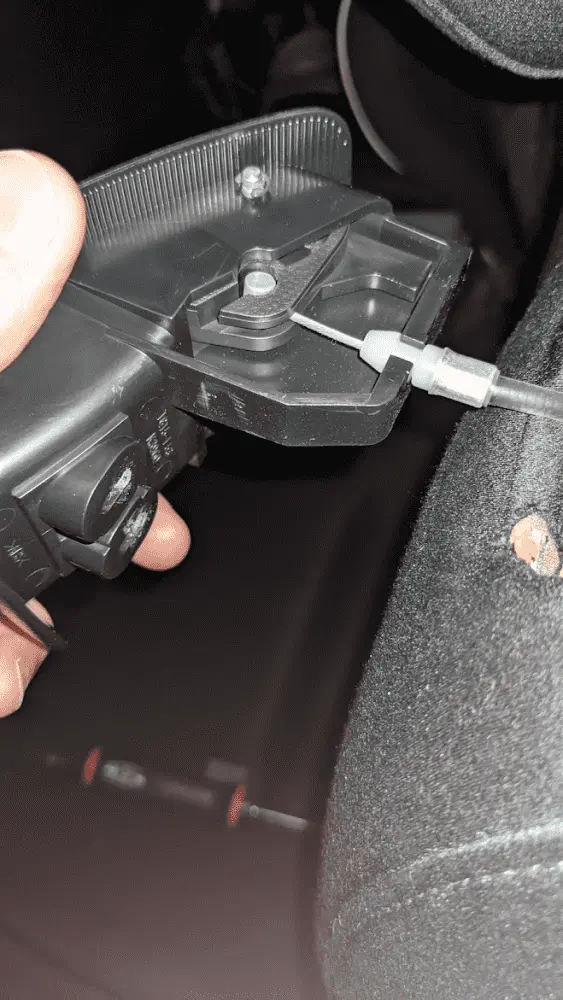

I know this was posted a while ago, but this sounds like the same issue I had and I'll share how I fixed it for my 2013 CX-9 Sport.
The biggest problem is that Mazda doesn't sell this cable. Their catalog suggests that they do (TDaa-88-287), but it's not the same one. It is too long, the snap in connectors are the wrong length, and the end is an S shape instead of a barrel, so it won't fit into the handle. Neither of those were things you can work around with the cable they say is the right one. After working with two dealerships and Mazda directly, I was told I had to buy a new seat back that would come with the cable.
I was able to find a simple solution at Advance Auto Parts. I got the Dorman cable stop assortment pack for $5 and one of them was the right size.
I did take the entire seat apart to remove the cable when trying to fix this and it wasn't bad to remove and put back together, but if you have the same issue as me with the cable breaking at the handle at the top of the seat, you probably don't need to take the seat apart at all.
Attached are pics of the cable stop that broke off and how it connects to the handle. I don't have a pic of the replacement after I put it on, but it worked like a charm. 6+ months later and my kids haven't re-broken it.... yet.

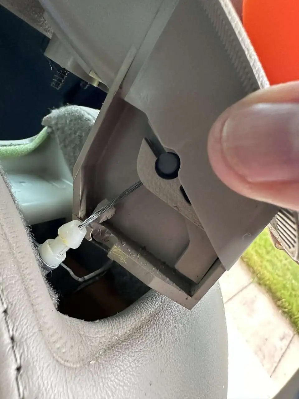

Thanks for the post! Both my 2nd row seats won't fold flat - I started taking apart seat using guide in the service manual but turns out I didn't have to.
In the first photo below, before removing the lever it looked to me that all is good since you can see the end of the cable seated into the plastic lever. But if you remove the lever (its simple; two screws) then you'll see where the end of the cable housing seats into the lever is broken.
I ordered these parts - hope they are correct! There was some confusion at the dealership because the drawings are terrible:
TD11-88-2G7-34 Passenger side; in "Sand" Color
TD11-88-2H7-34 Driver side; in "Sand" Color
You can also just remove the lever and pull on the cable to fold the seat - the parts above were $77 each! I'd debating keeping it that way since the car is 13+ years old at this point.

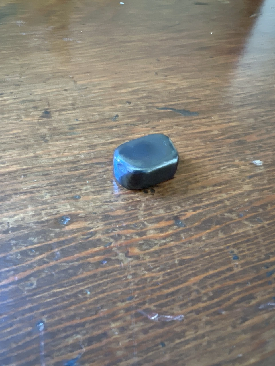

Thanks to everyone for this thread. I couldn’t get my 2nd row seat (the smaller one) to slide forward all of a sudden. I tried checking all of the cables, I lubricated the moving parts, but nothing helped. I couldn’t see anything wrong, anything obstructing the track. I couldn’t find any info on how the mechanism works, and what I could see looked normal. Anyways, this post helped me take another look
I removed a small cover to prepare to remove the seat, and I got a different look at the rear mechanism, and sure enough there was something stuck in the channel!
What was just the right size to fit in the channel, dark enough to miss, and metallic to stick to the track and resist removal? My son’s magnetite rock! See the photo
Grabbed that out of there and smooth sliding returned!
