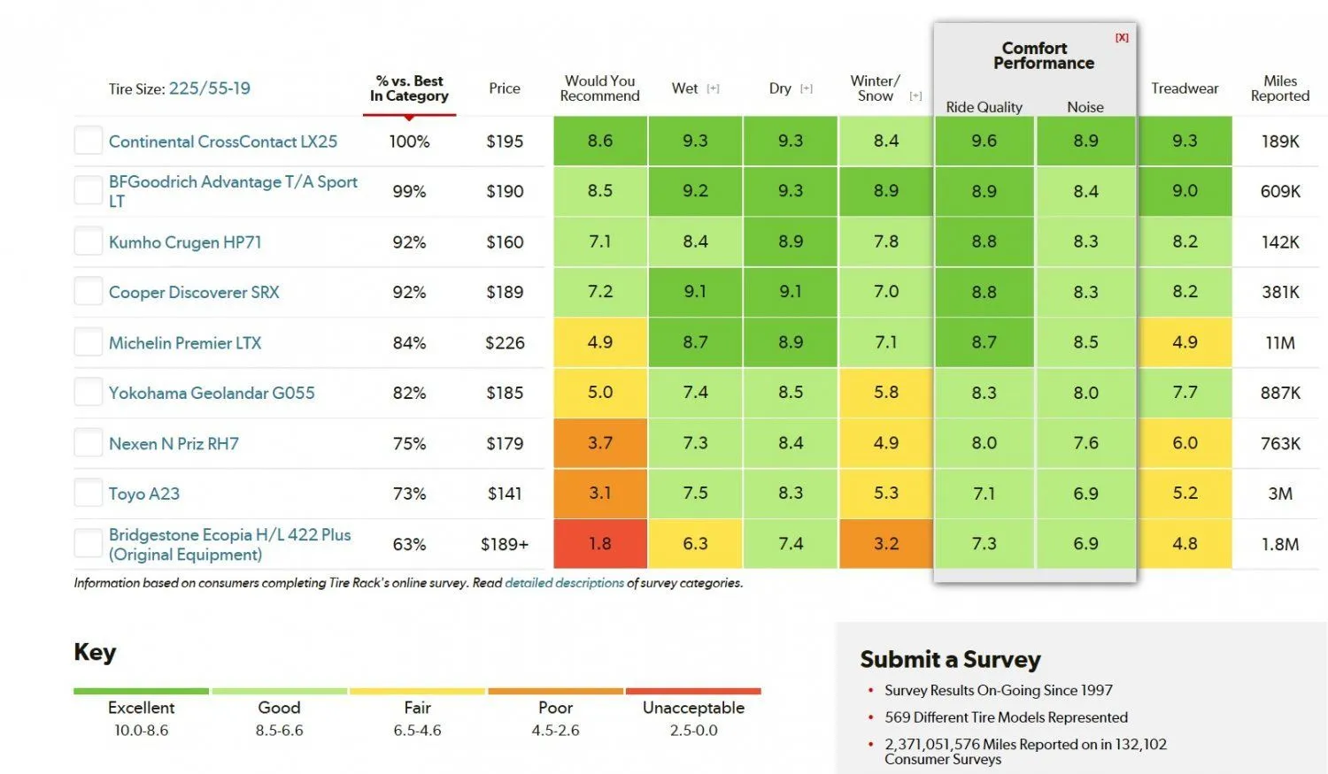

BFGoodrich Advantage T/A Sport LT 225/55R19 is Crossover/SUV Touring All-Season tire
Based on specs on BFGoodrich Advantage T/A Sport LT, I personally don't like the "700 B A" UTQG, lower 44 psi maximum inflation pressure, and heavier 30 lbs. tire weight.
It also performs absolutely dismally in the rain, and I'd never buy them.
https://www.tirerack.com/tires/tests/chartDisplay.jsp?ttid=229
Just look at that wet pavement stopping distance!

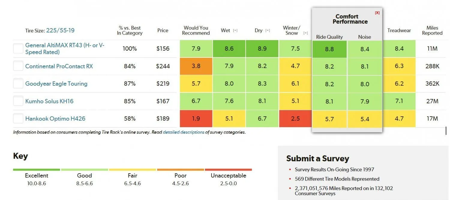

For 225/55R19 tire, many here like Continental CrossContact LX25 ($194.99 each at Tire Rack but there’s manufacture $70 Visa Prepaid Card by 8/31/2020) and General AltiMAX RT43 ($155.99 each at Tire Rack). Both rated number 1 on Tire Rack's Tire Ratings Charts for size 225/55R19 in different category, and both are better choice on performance and cost for size 225/55R19 IMO. Do a search on both tires in this forum and you’ll see many comments for your information.
Here are a couple of Tire Ratings Charts on size 225/55R19 from Tire Rack:
Tire Category: Crossover/SUV Touring All-Season
Tire Category: Grand Touring All-Season

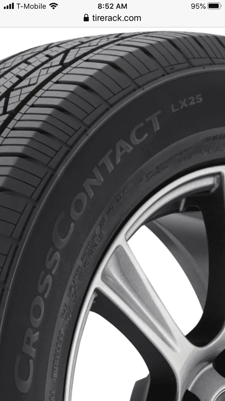

Are they LX20 or newer LX25?
No idea. I just looked at the sidewall and didn't see either LX20 or LX25 marked on it. It's possible it's on the inside of the tire though.
That’s very strange. If the “LX20” or “LX25” wording is on the inner side of tire, it seems whoever did the tire installation did it wrong. The “LX2_” wording and the tire “date code“ should be visible from the outside.
Found the reason why. On the Mazda they are True Contact not Cross Contact. Still very happy with them.
