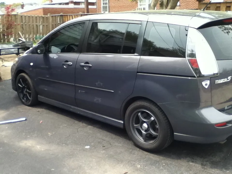

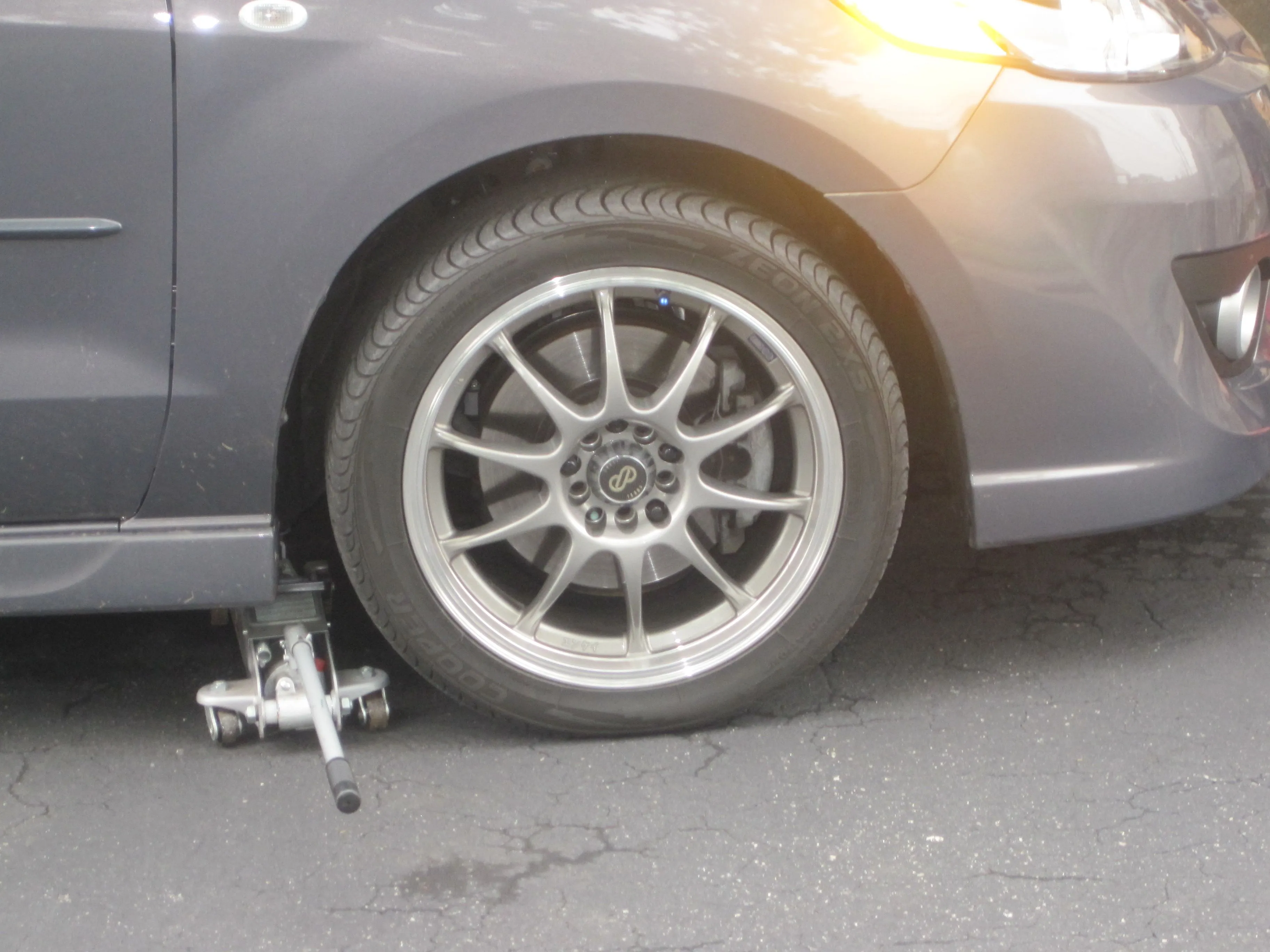

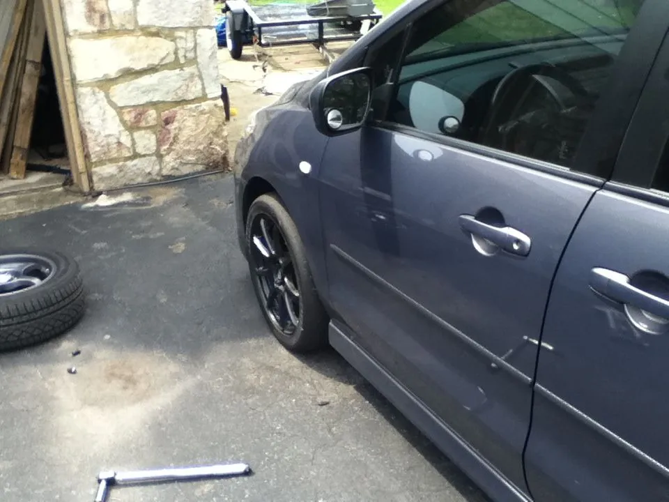

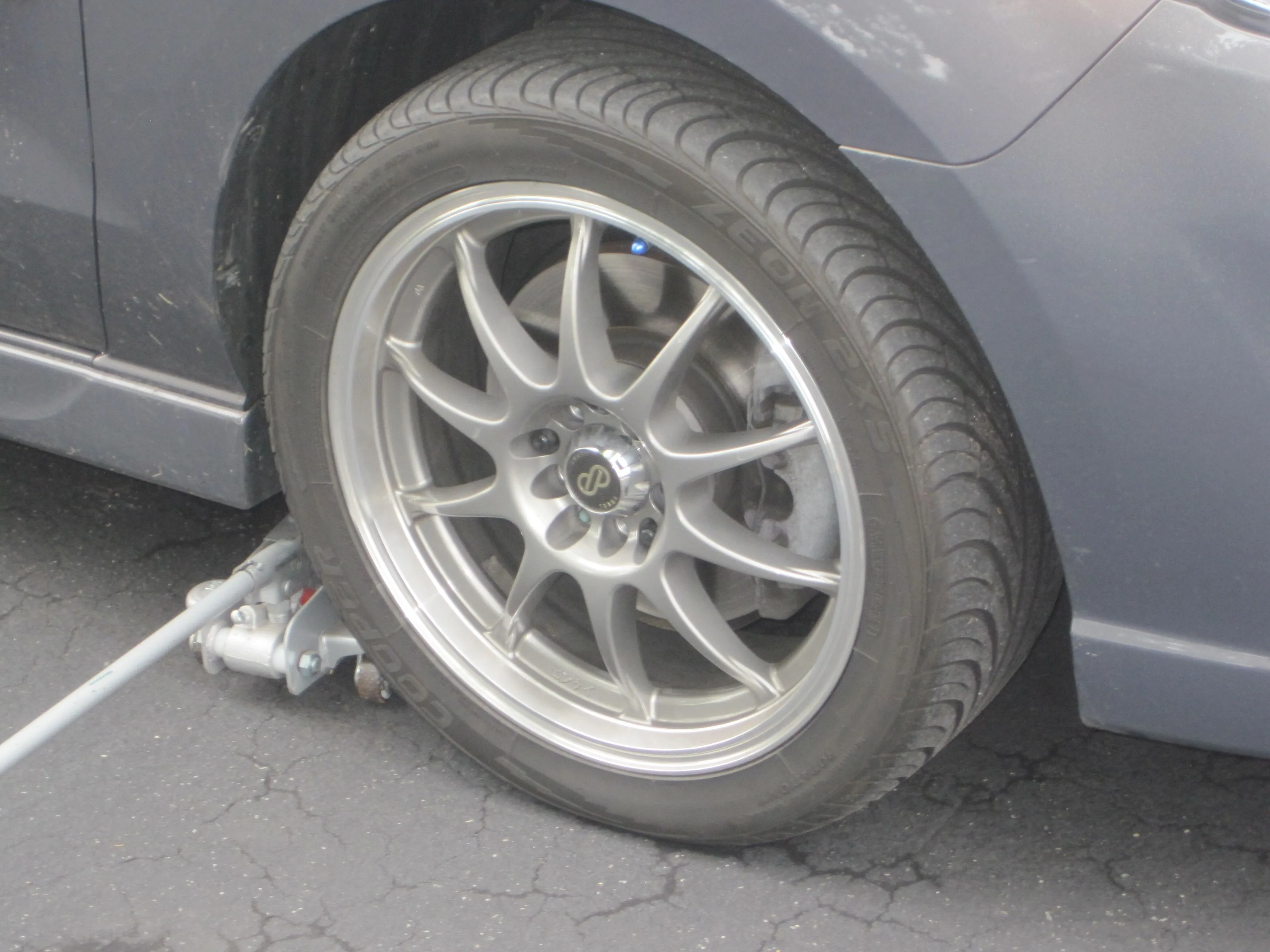

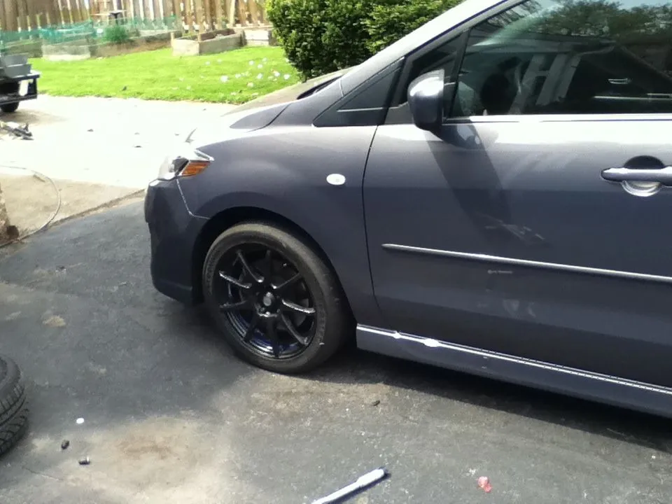

Had enkie j10's on 17x7 42 and they stuck out an inch in the front with 215/45-17 cooper zeons on them from my old si, currently running mb comp wheels 16x7 +43 with 215/55/16's cont dws's and they also stick out 1/2 inch or so on the front. getting some webs sport 17x7.5-17 +52 with 215/50-17 512 in a week of two, have to repaint wheels as they were auto crossed last year. They are about as flush as you can get. will post pics as soon as I figure out how.
Sorry new to posting... above pictures are the webs sports with comp slicks on them 225/45-17s big and fat and sticky. rim is exactly at edge of fender even with the 52 offset. will post more pictures soon as I hopefully switch the tires. these are the j10's...

I was forewarned about that. Sticking out a bit doesn't bother me (you should see my Jeep and it only has 31X10.5 on it) but being even with the rear I might find more annoying. I'll deal with that when I see it depending on how bad it is.
I'll be sure to take pics showing fitment.

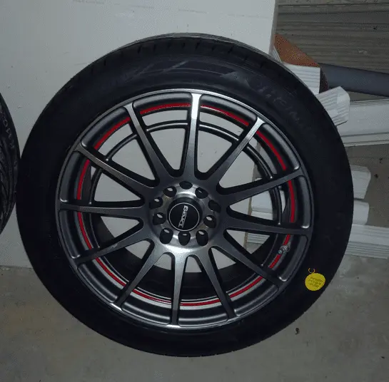

Got them in, but am working tonight so I probably won't get to put them on until tomorrow sometime. However the overall finish is actually a lot better than I anticipated. Drag being a sort of budget "house" brand of DTD, I was figuring I'd be giving up quite a bit of up-close appearance/quality for the price, but it's pretty nice. They look much better than even the enlarged images on DTD's website. This makes them all around better looking than I expected.
What I like least about them [so far] is how good they look "on" (in front of installed rims) the MS3! But having the same, or very similar, wheels on the two would be pure cheese.
What I like best [so far] is the overall rim+tire weight. They are lighter than expected. Our bathroom scale isn't certified of course, but the one I've totally unwrapped was 40.6 lbs. Considering the stock rims with original Toyos on my 05 MSM weighed 39 - 42 each I'm not upset about that. The MSM's being 17X7 with 205/50s and the new rims being 17x7.5 with 225/45s. If the tires are reliably 24lbs as their specs indicate the rims are actually less than 17lbs. Cool.

I did take pics off the car. I tried lining them up but it looked stupid, so I'll just have to wait until tomorrow (later today). I took a direct shot and a glancing shot so you could see the spokes level out at the rim but angle inwards a bit. Also on DTD the spokes and inner ring looked too thin to support a vehicle. You can see their thickness better in that picture. Also the edge between the machined portion and the grey paint is more rounded and smooth. Again the DTD stock image didn't do the rim justice.
Right about 40 lbs a corner (wheels 16-17lbs, tires 23-24). I just changed them this morning, but I haven't driven yet and will take pics after I move the 5 around and resettle the suspension.
They are _definitely_ lighter than the stock rim/tire combo. I noticed the weight difference right away when I was moving them around so I grabbed the scale again: 45 and up for the stocks. So I saved 4 - 5 lbs per corner and got wider wheels and tires. Not bad!

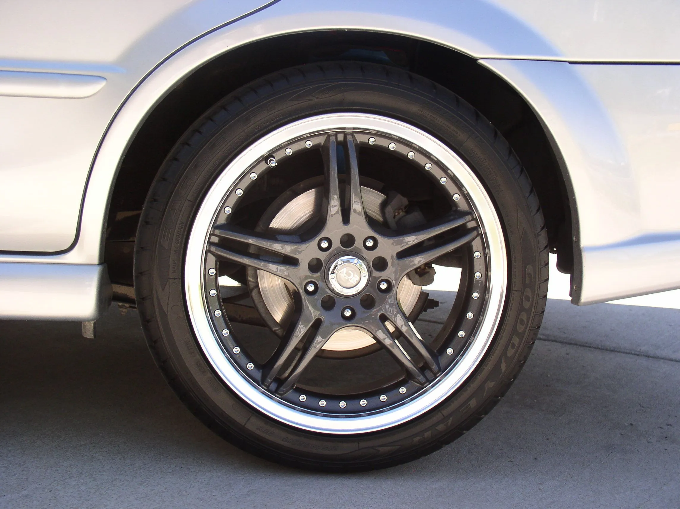

I was running Goodyear GS-D3s (205/45/17), changed to 225 Conti ExtremeContact DWs (23#) on the P5. Better ride, stickier, better dry/wet, turn-in and more expensive ($500/set). I'd get another set. As for wheels, I like the ADR Battle (17D/7.00W/40 OS/23#). Makes a heavier combo than I'd like, but works well with castor, camber setup, MSP springs, Blues.
Tire shown is Goodyear, no updated shot of Conti which fills the well better visually.

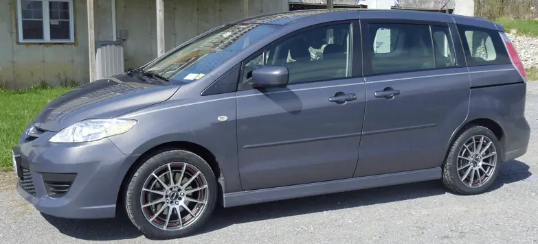

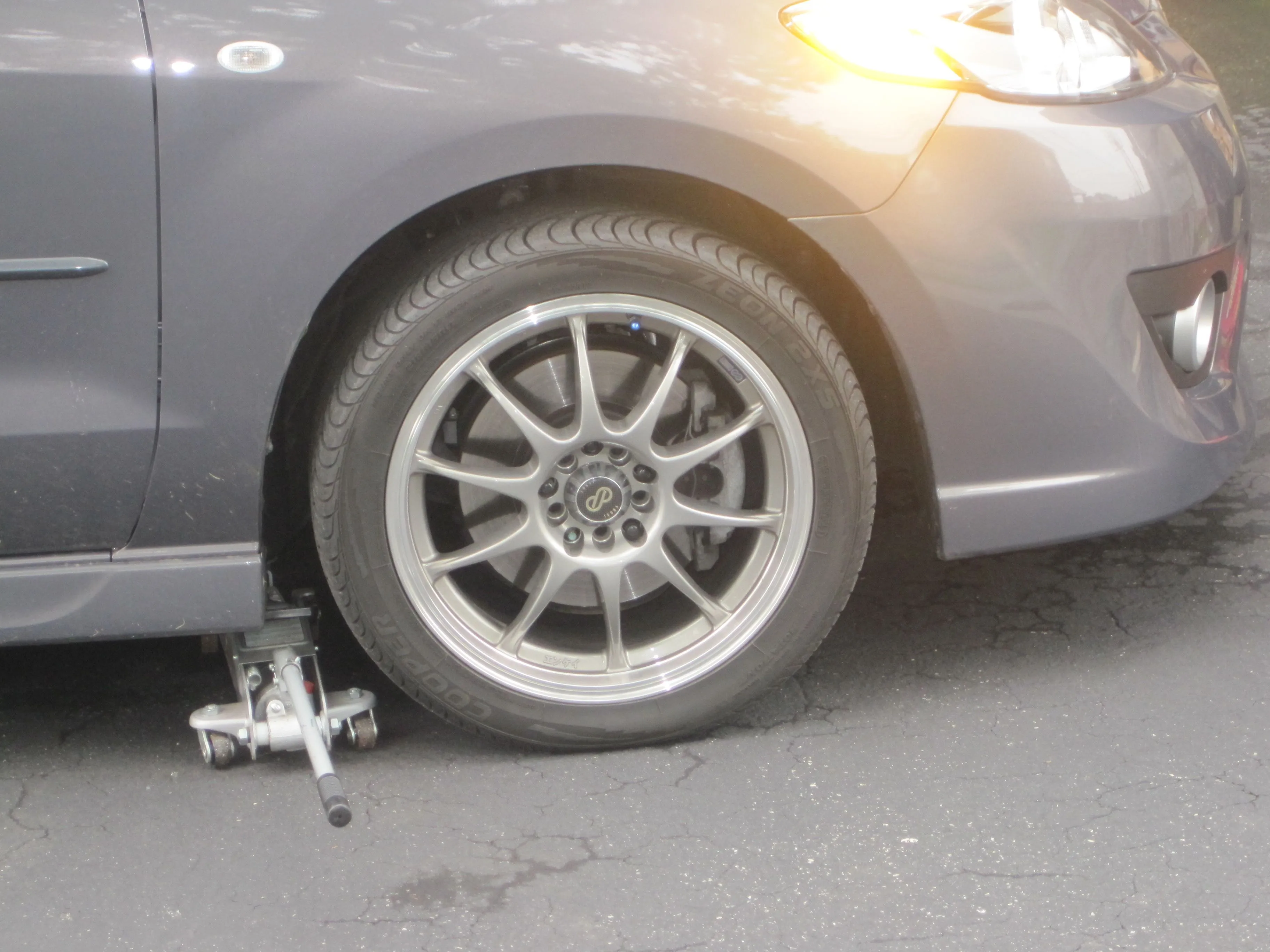

And... Here are the pics. I took a side shot for "glamour" a close up of the rear to see how there's still some fender room there (so not flush or "over flush" yet) and then a "down the side" shot to show how the fronts just peek out and to be able to compare with how the rears fit.
Looks great! I would have thought that the 225's would have stuck out more. How much psi are you running? Any problems with the sidewall height or rubbing in the front? I'll try to post pics of mne with j10's tonight, the fronts stuck out to much to run... Looked good though. Am definitly going to paint the webs sports and mount asap as I feel they fit almost perfectly. May go with 215/50-17s though for a little better ride. More pictures! any rubbing inside fender wells? Tint is great by the way... I have a 2 1/2 year old girl that appreicated not getting sun burned touring the pennsylvania countryside.
Thanks, man. Fits well so far, but I haven't bottomed out yet. I'm a bit concerned about that. At full extension and at "normal rest" there's good clearance to suspension parts. Actually there's a bracket that either the ABS sensor or brake line goes through that, it seems, would be the first to catch, but it's tough to tell with your hand. In any case doesn't seem to have any problems.
