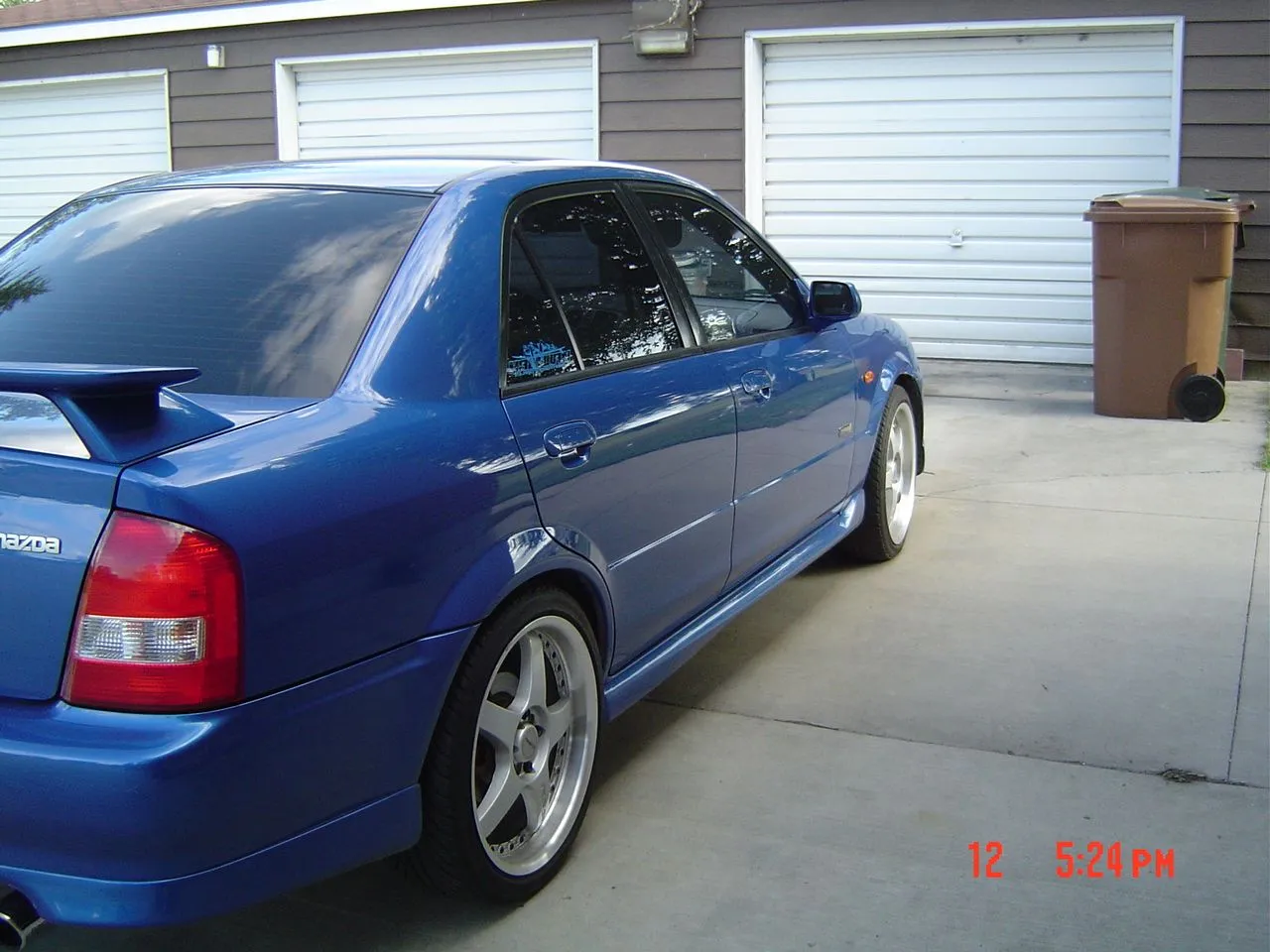

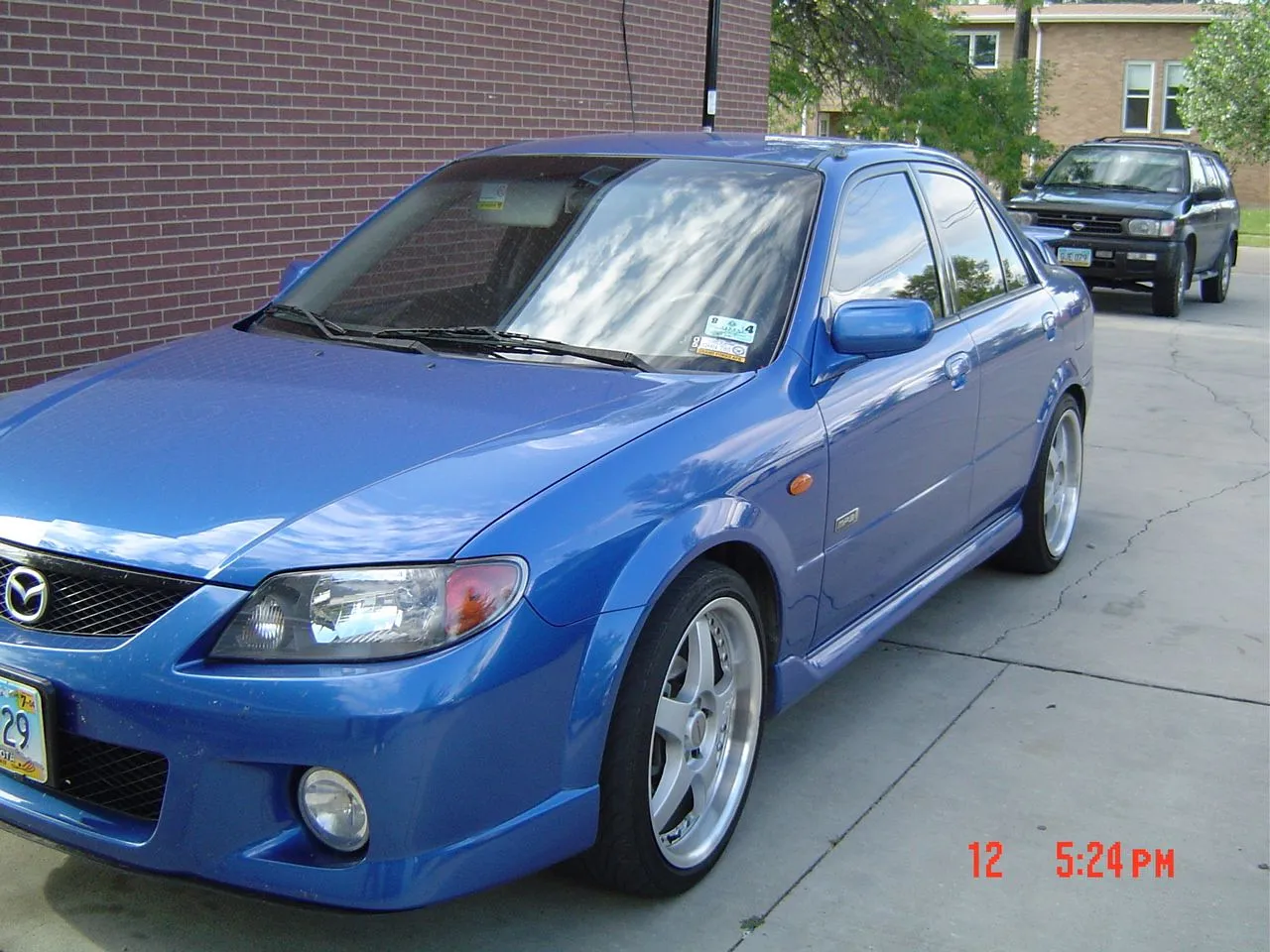

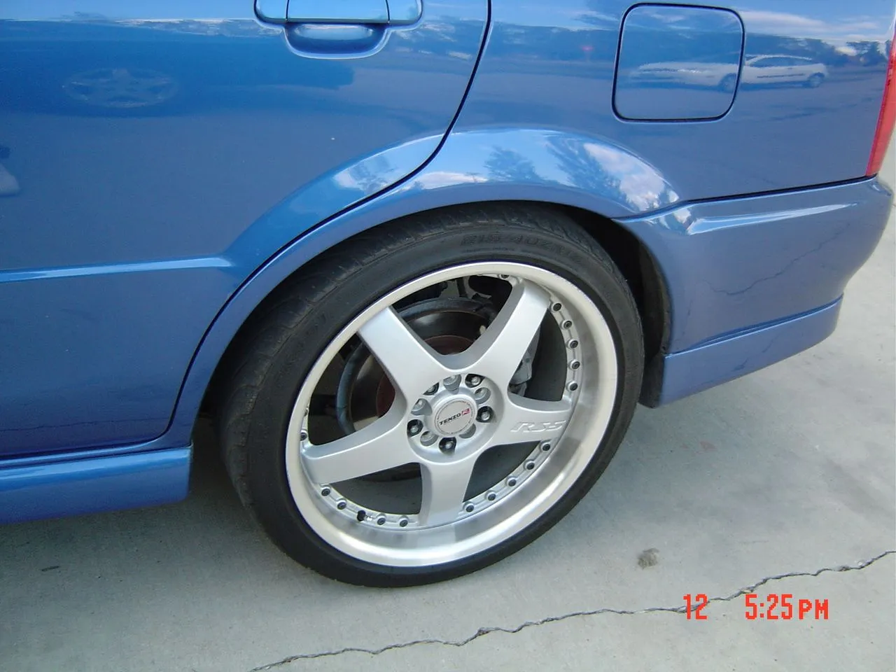

Here is mine with 215/40/18. The fit just right without any problems, even with turning. Sorry that the picture is so big.
