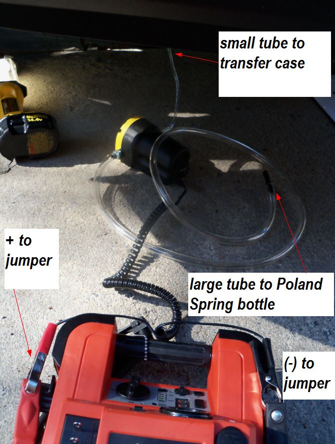

the thing worked liked a champ!! much faster and cleaner than the sunction gun, with the sunction gun, I had to suction three times and dump three times, very messy, with the electric pump just had to hit the switch and let it run, see video

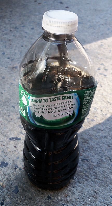

the amount of old oil sucked out was also about 30% more using the electric pump than the sunction gun,
it almost filled up the whole Poland Spring bottle, I was never able to get that much out both times using the sunction gun.
I hooked up the pump to my emergency jump starter and just ran it off that to power the pump as shown here:

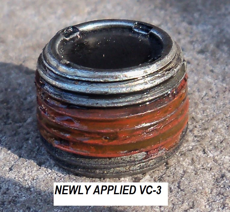

also since this was the third time I did this, I had to add new VC-3 sealant:
