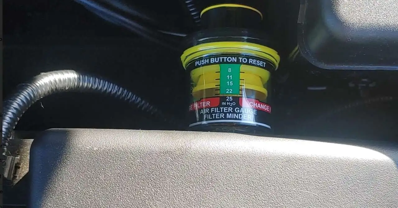

Today I installed a WIX Filter Minder, FM, a gauge that measures the pressure drop across the air filter box inlet to the clean air side of the filter media.
I installed a WIX part # 24801. It took longer to find my 11/16" drill bit than to install the gauge.

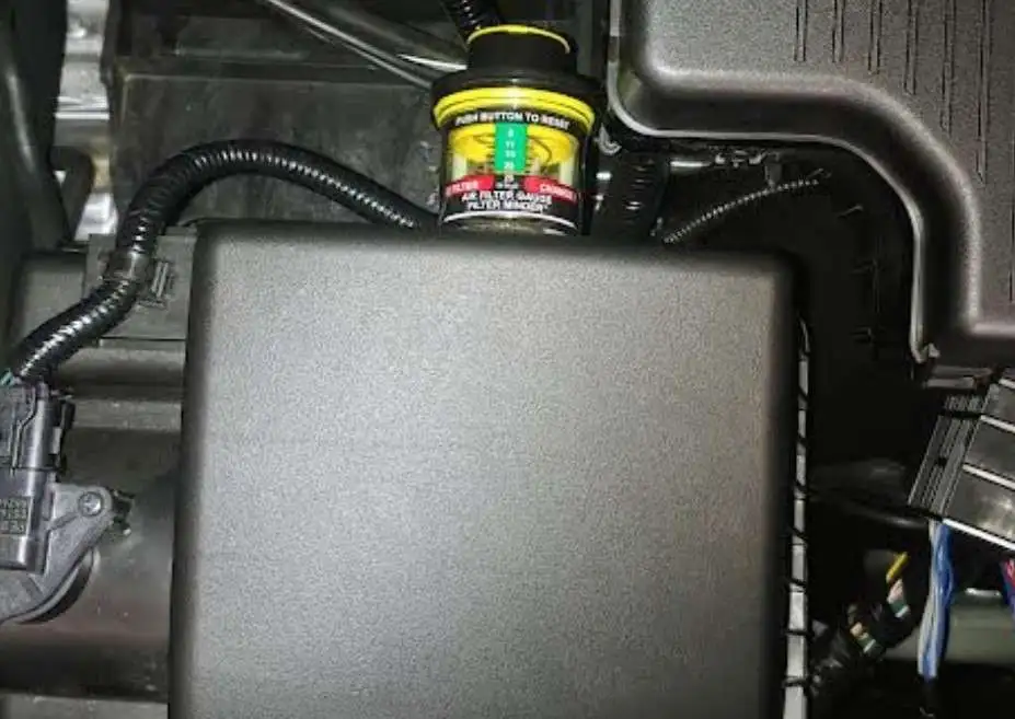

The first pic is driving around town, didn't move the gauge and the second is WOT in second gear to 5000 RPM measured +15" wc pressure drop.

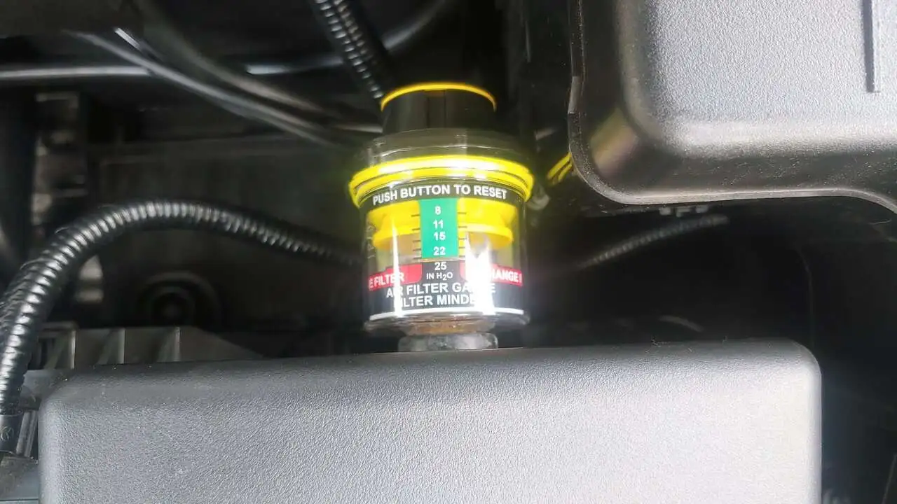

Update:
I installed a new air filter, no change on the FM at WOT, 15" wc vac.
Removed the air filter. Wot was 11" vac or 4" pressure drop across the new filter. See pic below.
That points to pressure drop across the air inlet and dap, dirty air plenum.

Good test.
Also shows how relatively little restriction there is in the element itself compared to the full system.

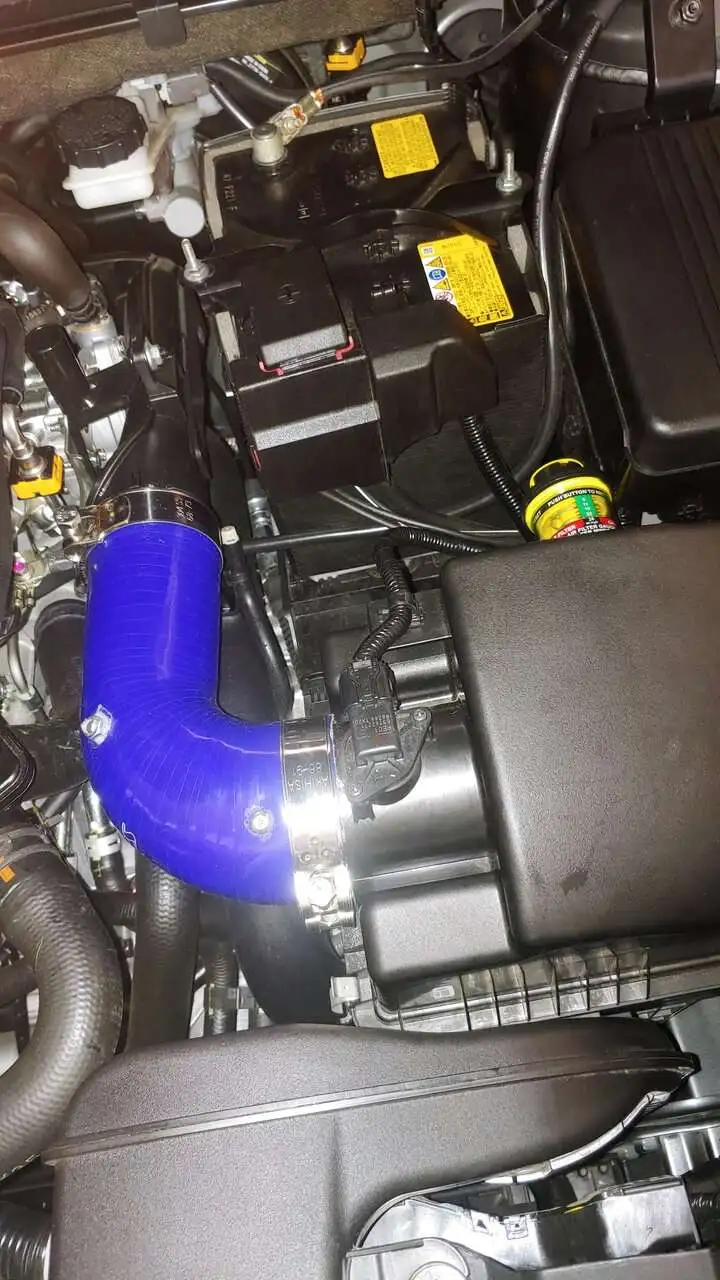

I improve FE by 4.5 mpg by installing a turning vane and smooth bore in the first 90 after the air filter box. Less restriction helped. I started a thread showing my progress.
Turbo work best with low intake restrictions. More restriction, slower spool up, higher exhaust temp, lower FE. Notice how drag cars stick the turbo facing forward so as the car goes faster it pushes the air into the engine.
On my Cummings turbo deisel we improved FE by 30% with a tune and bolt on mods. We have improved intake flow across the rpm range. We added turning vanes, more air into the air filter box and other tweaks. We have a community of folks who work together, sharing ideas and helping all who want more FE.
I have a smooth silicone hose and see no change in fuel economy. Just as a data point.
