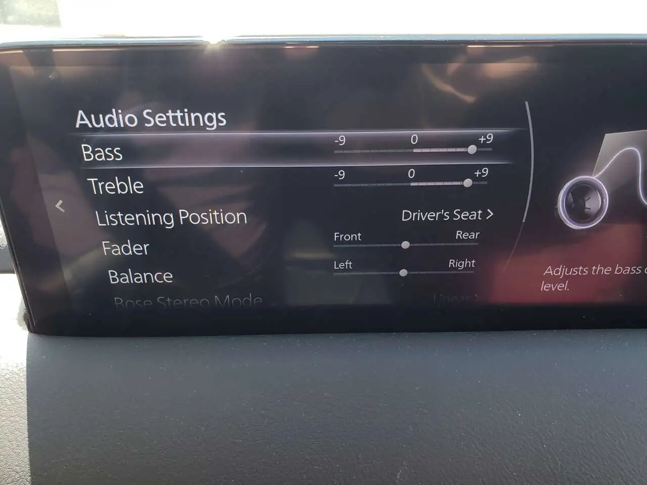

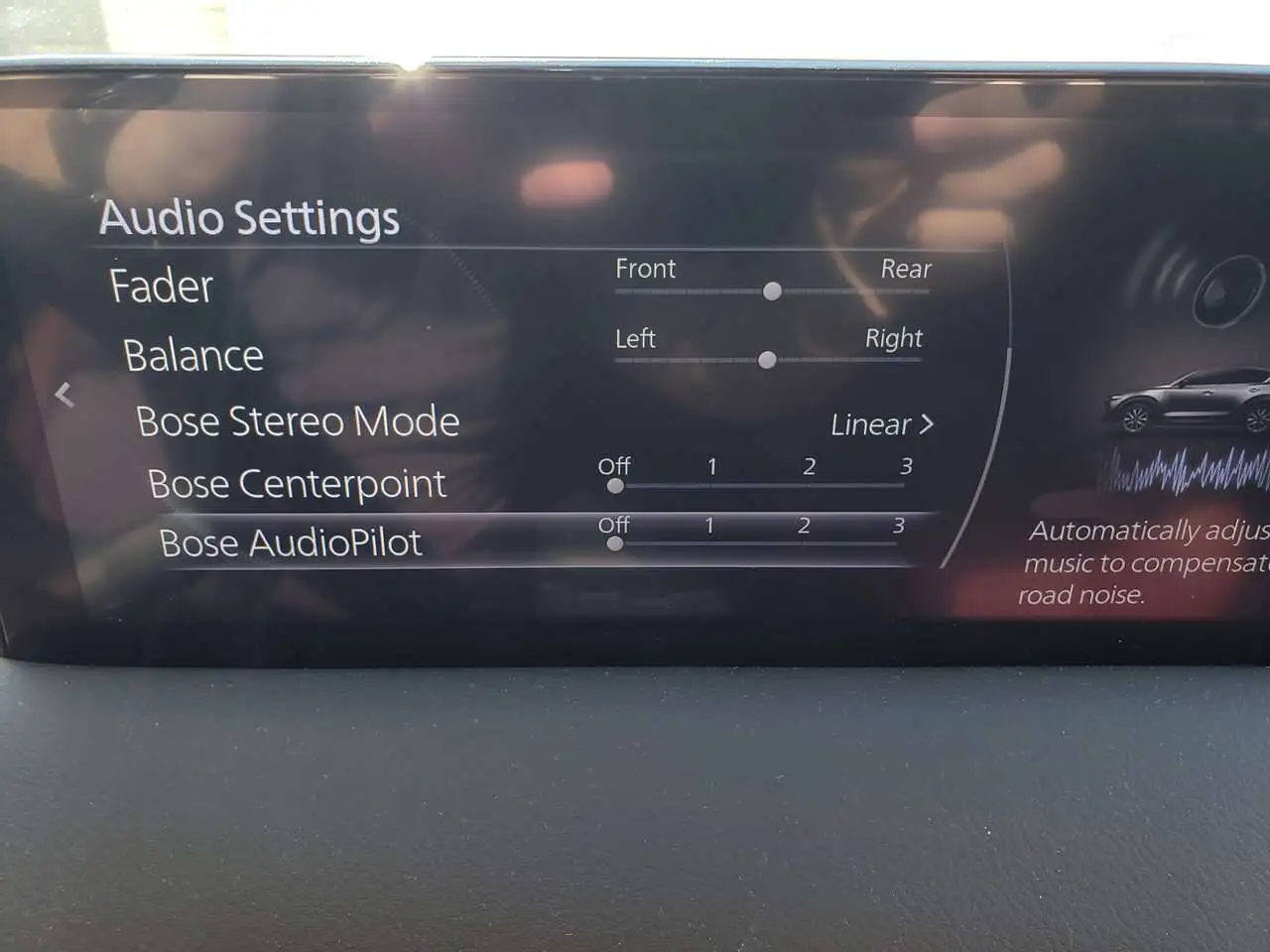

for anyone interested, I'll post my settings here. i have the 2023 carbon edition cx5 with bose. for what it's worth, I'm a part time audio engineer and review audio equipment (mostly headphones) on YouTube. just to say I'm familiar with a lot of sound science and have heard many playback systems in my life.
i have a fondness for studio quality sound, meaning the sound of a well designed acoustic studio space with flat measuring studio monitors. you can easily get into debates on what that means and objective vs. subjective sound preference. but my point is just to say I'm not just voicing a completely uneducated opinion. I'm not claiming my settings are the best or anything, but just that i feel they most closely approximate what i personally perceive to be a neutral sound in my experience.
I'll start by saying the bose system does some things very well and some not as well. and that no matter what you do it doesn't sound completely perfect, but it is fairly capable for a car system. in fact, it does more right than most imo when tweaked.
I'll list each setting and explain my reasoning.
first, i start with all enhancements turned off.
audio pilot is just volume auto adjustment based on road noise. that's a personal thing. not for me. choose what you prefer.
centerpoint off. this adds a surround sound style quality which can be cool. any setting beyond 1 ruins the stereo image imo. but even turned on 1 the sound becomes wider but much less distinct. it also changes the subwoofer relationship to the speakers. so off for me.
fader and balance default 0. these can be adjusted to taste, but with my settings, 0 will give the most neutral frequency response.
listening position set to driver... screw all the passengers: :p but really, this gives the sound a more direct and precise imaging akin to speakers in a room. and it is not a drastic difference to passengers.
here's the biggie. stereo mode set to linear. this is big because the bose setting is essentially an eq that gives the sound more bass punch and treble sharpness. it does this at the cost of mid frequency accuracy and gives the sound a"V" shape eq tonality.
it may seem counter intuitive but with linear stereo mode it sounds much thinner and weaker. however, you need to set bass and treble to +7. this brings back bass and treble presence while retaining more mid range than the bose stereo setting. you can tweak up or down a point to taste, and passengers will affect the perceived response, but this sounds good to me.
make sure to disable any eq or enhancements on your source player. once you get used to this it can be further improved with eq in an app like poweramp by increasing lowest sub bass to taste.
again this is to mimick a neutral speaker response as much as possible. if you like the enhancements that's cool. I'm just going for response and imaging accuracy.
with these settings, what i find the bose system does well is overrall smoothness of the response. there are no major peaks or dips in the response. nothing objectionable. it is very resolving and smooth.
what it doesn't do amazingly well is bass impact. it's very smooth and clean bass, but to get sub bass punch and fulness you need to ruin the mid bass accuracy. so i opt for these settings. granted, to me they still sound great and bass has nice sub bass extension and hits well enough. but there's just always a certain oddness to the bass or mid bass. almost an out of phase quality. but these settings minimize the issue the most.
so that's my recommendation. give it a try and see what you think. i haven't spent a lot of time yet so i may tweak things slightly, but this is what i have settled on initially.

i will add that if you have 4 passengers, the centerpoint set to 1 will make it sound a lot better for the rear passengers. with centerpoint off, the focus is on front speakers presenting the full sound with rear and sub playing lows. this is aimed for front seat listening primarily. with centerpoint on, more full range sound goes to the rear speakers.
so off will make the back seat sound more bassy and muffled. on will sound more normal. just something to consider if you have 4 people enjoying music on a trip or something.

Life and music are in the midrange. Your settings still recreate the obnoxious smiley face ("V") response curve. You need to do some testing. You can use FM inter-station hiss and an app called Spectrum Analyzer to adjust for approximately flat response (crash cymbals not louder than hi-hat, bass F not louder D/E, unless played louder).
"Impact", from the kick drum, is above 90 Hz and above most common bass notes. Adding 7 dB at 40 Hz buries the impact. There is no "impact" from low bass. If you have a Blose system that reproduces any low bass (below 40 Hz) it will be the first in history.
The Blose system I had was far from smooth in any frequency range. It earned its name.
Upvote 0
You have an obvious issue with Bose. But your griping doesn’t really help anyone here. Fortunately for you, you don’t have to ride in my car and listen to my stereo. Besides most every day drivers have no clue what you’re speaking of. If it sounds good to them, then so be it. It’s still better than any stereo I’ve heard at this price point for an OEM option, and while it’s not an audiophile’s wet dream, it certainly is “good enough”
Upvote 0
as i had said, it isn't perfect. the system is geared towards that V shape sound. no adjustments will completely eliminate it but i find my settings help. it is all a compromise.
more correct mid range will make the low bass disappear on this system. and there isn't a good mid point eq to adjust. i wish they'd add a third eq point with firmware. still wouldn't be perfect but would give so much more control. I've been using custom EQ on my source player lately. i was considering measuring and posting a custom EQ. if anyone is interested i can try. i have the proper gear to do so, but without getting into super detail, the process isn't fullproof. but it would get it even closer to neutral if that's your thing. just not sure when I'll have time...
