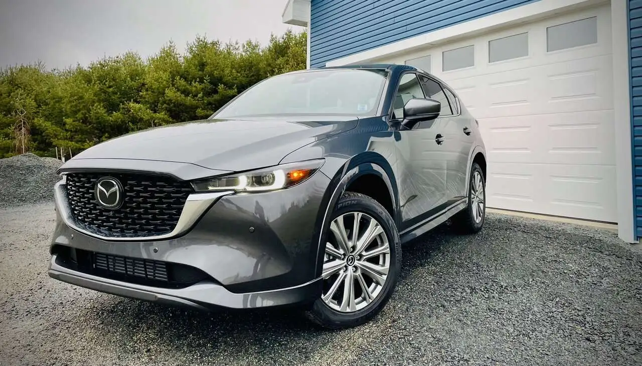

I just picked my '22 Signature up yesterday. Had a '20 Sig. before.
I will say I can notice right away there is some sort of improvement with harshness when hitting potholes/bumps. There is a noticeable muting of the sounds and harshness now.
I haven't really noticed anything new with the seat. Maybe the middle of the seat is squishier?
I have noticed some changes in the transmission but I suspect it's still learning my driving behaviours.
I do really like the styling. I wasn't keen on the rims but they are already growing on me. So happy they updated the exhaust tips on these as well.
Huge improvement in the Infotainment. Although it reset itself on my test drive, it's so much more modern and there are some things I need to learn on it.
Also, the Traffic Jam Assist is an interesting feature. Because of that button on the wheel, it moved around a few others I was used to so I've gotta get used to that now.
The headlights are brighter as well, I noticed the pattern on the garage door is more spread and more intense. I recall reading that there are more LEDs in these or something to that effect.
Also, the telematics stuff seems a bit gimmicky. I am excited to have remote start, however.
Due to the Easter long weekend, I won't get to take it on my commute to work until mid next week. I can update once I get more seat time.
