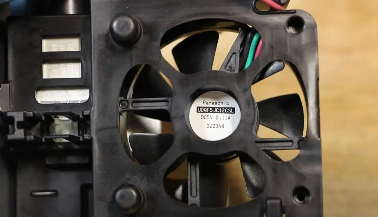

The sound might be coming from the cooling fan, which is a part of the bi-LED solenoid, integrated into the harness. This is how the fan looks like.
If its confirmed that its the fan, then the bearings might require some oiling. Nevertheless, I would suggest you to insist on the dealer to replace the entire unit, since you are in warranty. Mazda's signature lighting has a horrible configuration for its DRL. It always keeps the headlights on, no matter the conditions of the day. This will reduce the lifespan of the headlights and will cost a fortune to replace them once the lights are out (estimated price for both headlight unit replacement is $3000 to $4000)

I was thinking same thing after seeing the tear down video of cx60s system. I wasn’t sure if the cx5 had something similar in regards to cooling fan. This confirms. @larfy budz any updates?

It was the levelling motor as per dealer. They replaced the whole unit under warranty
Took in our 22 CX-5 CE CPO yesterday to address a vibration at 60-75 mph and noise in driver side headlight. I thought I heard fan noise on the driver side headlight, but Dealer indicated that the passenger side leveling motor was having issues and replaced the passenger side headlight under warranty. I'll have to keep an ear open and see if I still hear anything on driver side.
They also balanced the wheels, cause they were off and we agreed to the recommended alignment that they said was not covered under warranty. After picking it up, took it out on the highway and fortunatly the vibration was gone.
