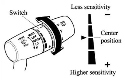

Have you "messed" with the sensitivity settings? With these, I would think the Auto Mode could perform splendidly to anyone's liking.

You could try the sensitivity settings to alter the wiper's over-reaction. It has worked as intended and I only turn the auto mode off when I'm washing the vehicle. That's exactly why I wonder why the intermittent options are even offered. The intermittent wiper function is merely a rudimentary form of the auto mode as it was intended as a totally automatic method of wiper function. And the sensitivity was a way to adjust to personal preference.

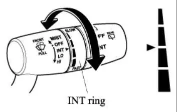

You're right. I totally screwed up here. I saw the HI/LO as sensitivity settings. But they are just the traditional constant HI speed LO speed settings. The AUTO mode sensitivity setting is the ring that has the older Intermittent settings. I still feel the Auto mode is better than the INT modes.
I'd love it if the sensitivity of the rain-sensing choice could also be halved, or even more. No idea if all the Mazda models and vintages are a tad aggressive on the rain sensing. Had a Mazda3 that worked fairly well, but this CX-5 truly dislikes even a little bit of rain on that sensor.

@lutky you can turn off the auto wiper function in the settings. That will make the auto mode into the old school intermittent setting and where turning the sensitivity ring change how fast the intermittent speed is (I do that every winter). Maybe that will stop your 2 second activation issue.
