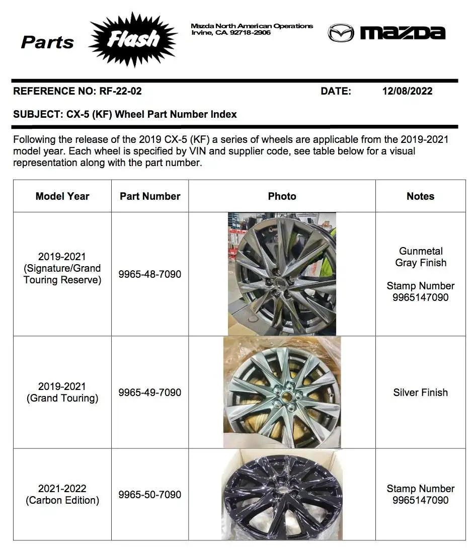

Oh, I think I may have found the answer, oddly enough, on the NHTSA website!
I believe the attached photo, an official document from Mazda headquarters, indicates the color is officially called "gunmetal gray" and the part # is 9965-48-7090
As can be seen from the document, the same number, 9965147090, is stamped on all of the wheels of this style and is therefore not sufficient information to order the correct finish, even though a number of places told me it was.

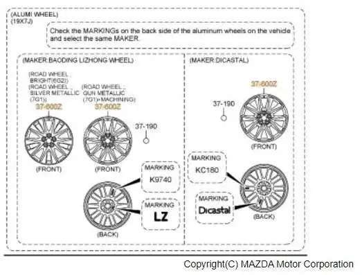

Ahh, the plot thickens. Now I think I know why the dealer needs to see the car, as Mazda has two different vendors for this wheel, Dicastal and LHMW, and the vendor code is also stamped on the back of the wheel. In which case, if that is the only reason they need me to bring the car in, I'll just pull the wheel and send them a photo of the vendor stamp...
I may even be able to find the stamp without pulling the wheel off the car:
