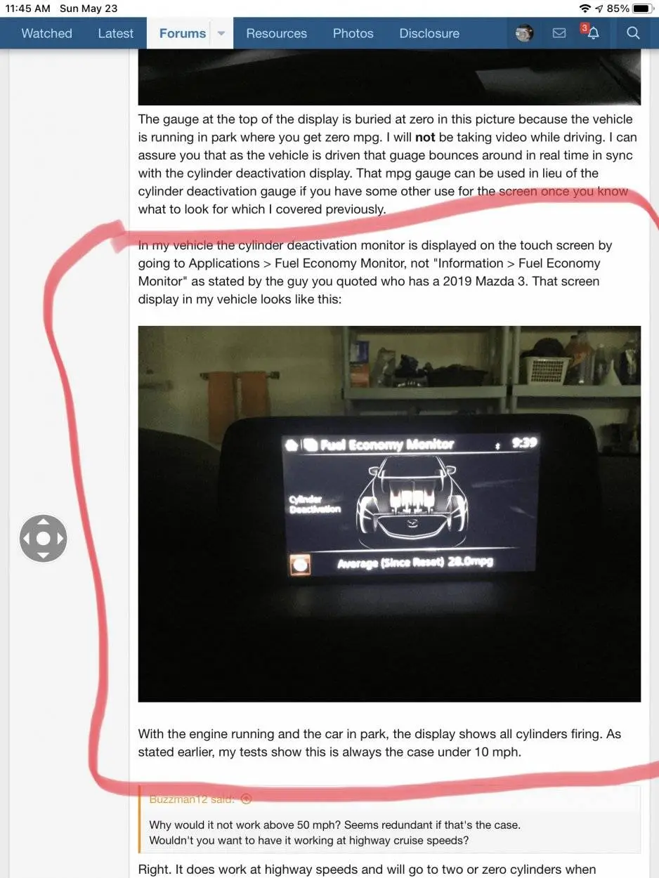

The Touring trim has the standard 2.5L engine which does, depending on model year, have the cylinder deactivation (CD) feature. You should have a screen available that will show the engines CD status at any given time. My wife has a 2020 CX5 GT WITH CD and does experience the same symptoms at speeds at or just below 20 mph. Using this monitor screen, You should be able to see the engines real time CD status as you drive slowly to recreate your hesitation issue. If the hesitation, jerking motion occurs while the CD is going on/off then you will know the source.

Right on. I’m going to check that now. Thanks.

Thanks everyone! I took a look at the CD display and noticed the feeling coming and going when it was activating and deactivating. I still don’t think it’s exactly normal and more likely a design flaw that hopefully can be remedied with a simple software update. I’ve got some time before I head in for my first oil change with the dealer.
