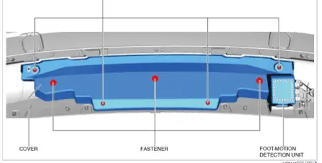

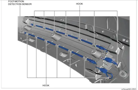

The sensors looks like two parallel cables, they are under a cover behind the bumper. Not sure if you can see them without removing the bumper or not. Replacement instructions calls for removing the rear bumper first.
