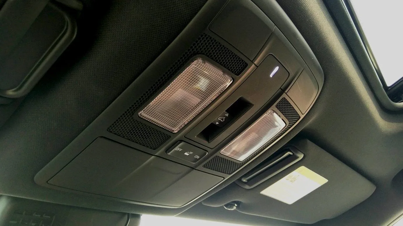

So I took a picture of the overhead map lights. How do I pry the lens open to change the bulb? It looks like its permanent.

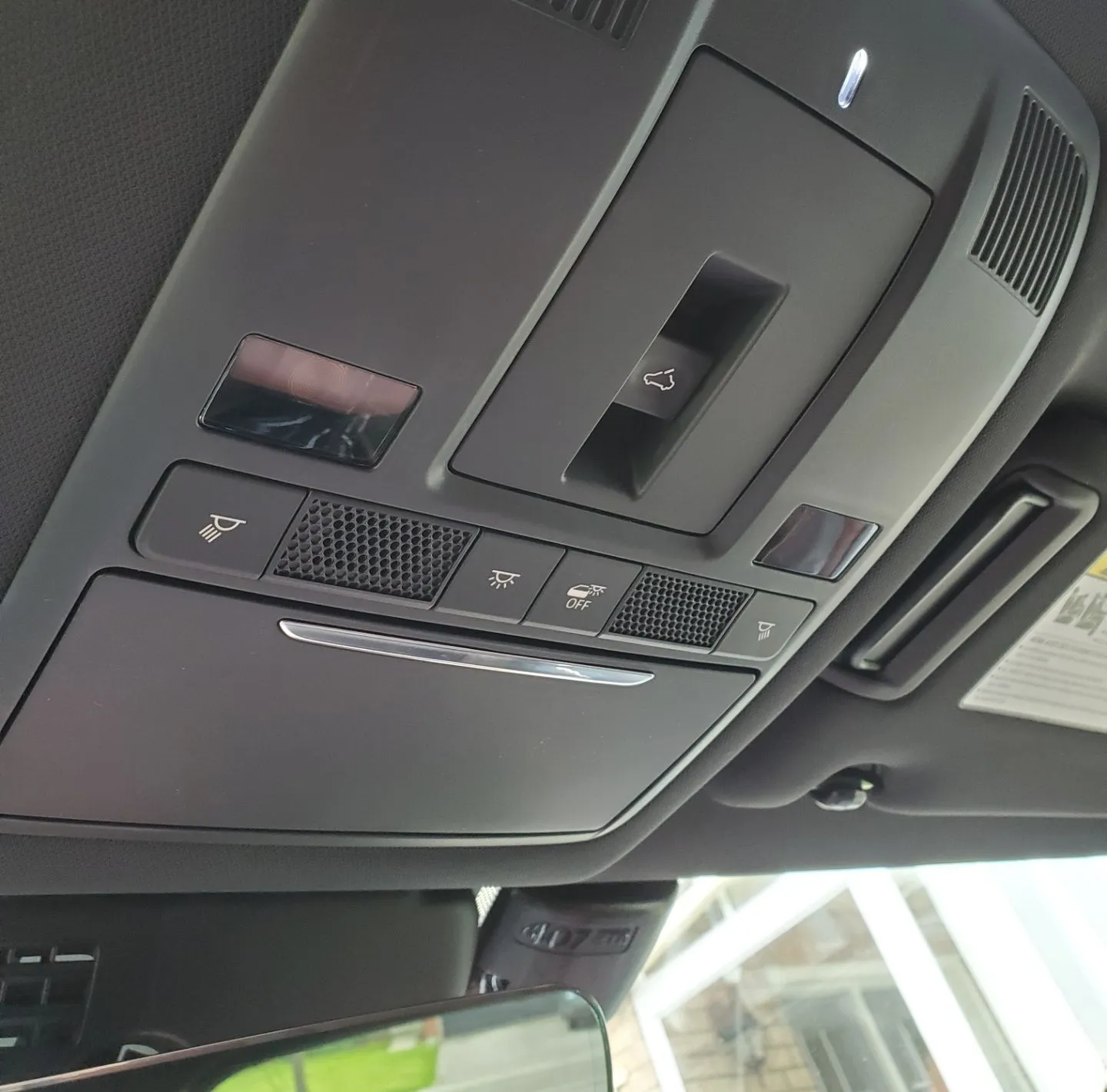

Interesting. It looks like there are two different overhead consoles for 2019 models, Type A and Type B.
Trixstar's (Type A)
attachment.php
Mine, a 2018 Signature (Type B)
attachment.php
I think I prefer the look of the 2019 over the 2018, so nice job Mazda. Unfortunately it looks like the Type A console has integrated LEDs instead of LED bulbs. Here's what the manual says:
"The LED bulb cannot be replaced as a single unit because it is an integrated unit.
The LED bulb has to be replaced with the unit. We recommend an Authorised Mazda Repairer when the replacement is necessary."
