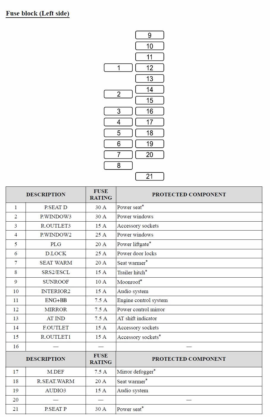

Before I take it over to the dealership thought I'd reach out to make sure it wasn't simple I was missing. The rear USBs (2.1A in the 2nd Row Console) are not working. Any ideas?
Phillip
Check the fuses box inside the cabin. Look at the number 15, R.OUTLET1
Thanks, went out and checked it, still looked good. went ahead and checked the other two (R.Outlet2 is under the hood)and they all checked out as well. Stuck my head under the seat but all the harness connections that I could see seemed connected well. Afraid this is going to have to be a dealer fix :(
Well, in that case, you should. Hopefully it's something easy to fix by the dealer.
