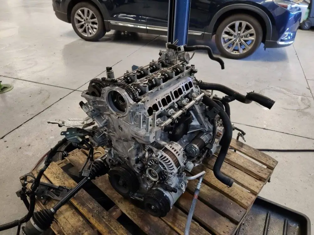

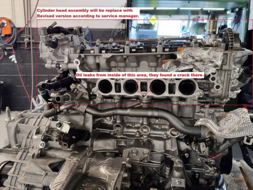

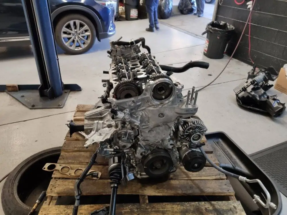

I went into the shop area and took some pics. Service manager located where the oil leaks for me.
Thanks for the pics. I was surprised to see the dealer actually had to remove the entire engine and transaxle from the engine bay for the cylinder head replacement. The crack causing the coolant leak seems to be happened on the exhaust port area between Cylinder #2 and #3. Unfortunately most wordings you put on the picture are too small for me to read. :geek:
Fantastic pictures. That job is like a million dollars lol. I guess pulling it apart is cheaper than putting in a new engine. Maybe there is a shortage of engines, who knows. The carbon build up doesn't look bad, and your engine is nice and clean.
I guess they will reuse the valves and timing chain and everything else, and install them into the new cylinder head and you will have an almost like new engine. You will have to drive it easy at first as it breaks in.
