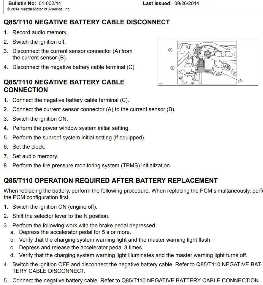

I recall that there is another step that is needed when changing out the battery in an i-Eloop-equipped Mazda. I'll have to check my owner's manual but I know it is not as simple as changing a regular 12V battery in a car with no super capacitor.
Lots of info, here:
There are special procedures for jump starting, disconnecting and charging the Q85 battery. An i-ELOOP equipped vehicle can be jump-started, but the vehicle must not be driven until an in-dash i-ELOOP warning display turns off. Before disconnecting an i-ELOOP equipped vehicle's battery, a "current sensor" must be disconnected from the negative terminal. Failure to first disconnect this sensor can cause false sensor readings and set diagnostic trouble codes (DTCs). When reconnecting the battery terminals, first connect the positive terminal, and then the negative terminal without the current sensor connected. Finally reconnect the current sensor to the negative terminal.

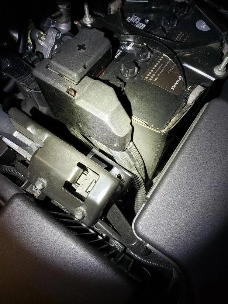

There are multiple cables connected to the positive terminal and it makes sense that one is the current sensor. This photo shows them. I have not yet changed my Mazda3's battery (dealer did it the first time), but I am hoping to swap in a far less expensive one when this one gets tired.

then I followed the procedure to disconnect the current sensor as outlined above.
"Before disconnecting an i-ELOOP equipped vehicle's battery, a "current sensor" must be disconnected from the negative terminal. Failure to first disconnect this sensor can cause false sensor readings and set diagnostic trouble codes (DTCs). When reconnecting the battery terminals, first connect the positive terminal, and then the negative terminal without the current sensor connected. Finally reconnect the current sensor to the negative terminal".
