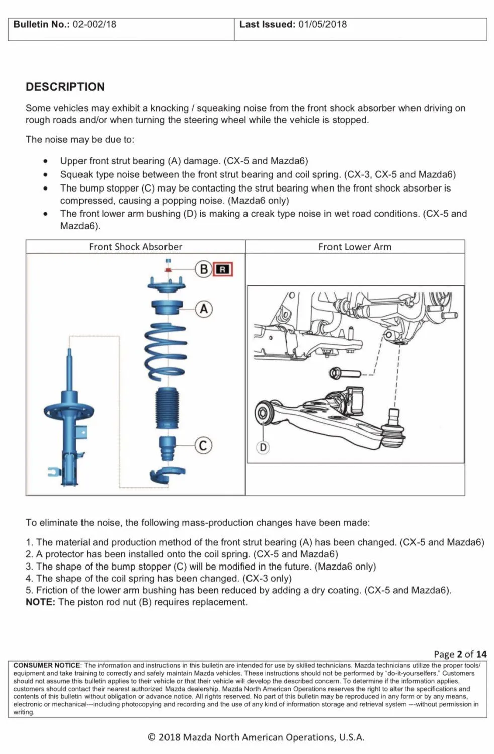

There’re multiple issues which may cause front suspension noises on gen-2 CX-5. Check out this thread and the TSB 02-002/18:
Click/ Clunk/ Knock sounds 2018 CX 5 AWD

And remember to bring a copy of the TSB posted in post #7.
