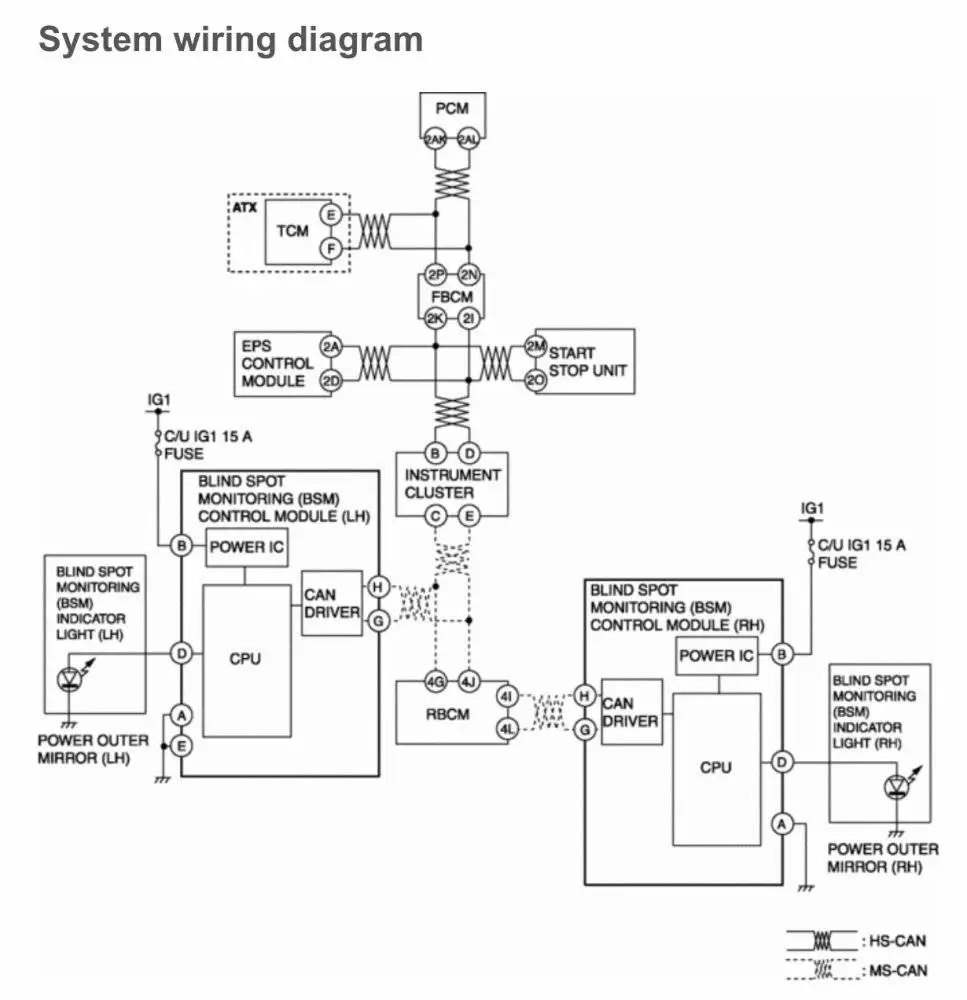

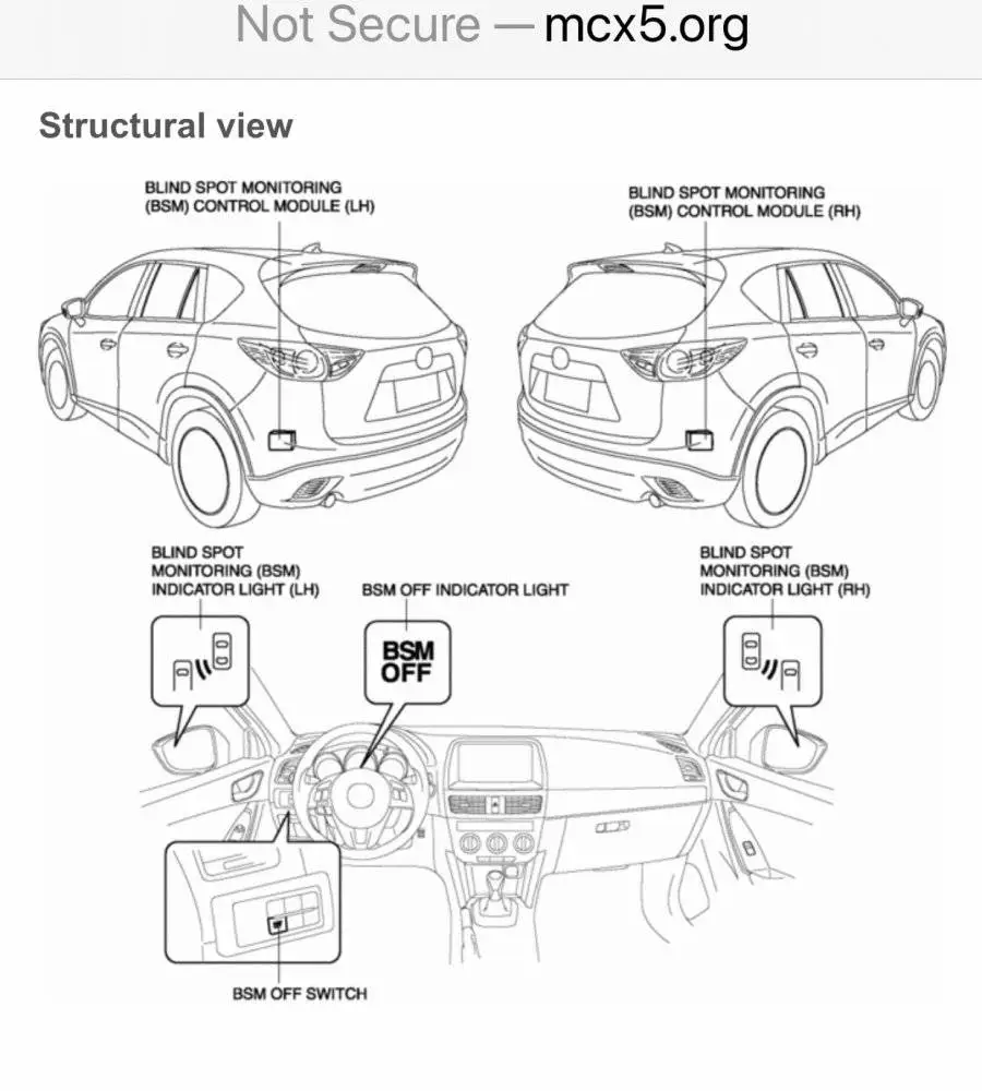

There’s nothing for BSM on the side view mirror other than a LED to light up the BSM icon. There’s nothing to recalibrate when you replace only the side mirror like GAXIBM said. When you said the BSM is not working, do you mean the BSM icon only on the replacement mirror doesn’t light up? If that is the case, I suspect the wiring didn’t get connected correctly by the body shop、the wiring got damaged、or the after-market mirror you got is defective.

The outside rearview mirrors have only the LED BSM icon indicator and has nothing to do with BSM’s functionality. I don’t believe you need any ”reset” to BSM control module just because you replaced the mirror. Since you replaced the mirror by yourself, you should still have damaged original mirror. If you can’t turn the BSM on after the side mirror replacement (“BSM OFF” indicator in dash keeps on), you can always try to connect the old mirrror with only the wire connector and see if the BSM can be turned on again. Make sure you not only turn the BSM off, but also disconnect the negative on the battery during the process.
If you verified your old mirror can work with the BSM, you should contact the vender TRQ or 1A-Auto questioning their mirror. The OEM outside mirror of your type is not much more expensive. It’s $159.13 Door Mirror - Mazda (KB8C-69-121A) at realmazdaparts.com.

Understanding that the side mirror only has the light for BSM is helpful. Now I’m confused as to why BSM just stopped worked after hitting the mailbox. There must be some connection to the side mirror? Perhaps an error was tripped?

I have a similar issue with BSM. Turns out my used 2019 CX-5 has aftermarket mirrors, discovered by Mazda dealership. They say the mirrors do not have correct resistive values, so the BSM will not talk to them. They say many aftermarket mirrors have this problem. I agree with others that there should be nothing more than a dumb light, but there are something like 9 wires, so I can believe there is something more complicated going on. Anyway, dealer recommends getting either used mirrors (except junkyards don't have any these days), or new ones ($$).

As with the last person who posted here, I did ask the dealer finally and got the same response. Difference in resistance causing the bug and only solution is to replace with dealer OEM part. I passed but someday may change my mind and look for a used junkyard part. But even if you find one, what’s to say you don’t get bad luck with another aftermarket part?
I have two CX-5's a 14 and a 15. and both have damaged mirrors and both have the BSD. The aftermarket mirror as long as you can see the indicator is in the mirror and it was sold as one with the indicator, one test is a diode check on the weirs leading to the LED or just swop the two weirs in the miniy connecter once the color tinted back cover has been removed . In my unit the led has a black and white leading to a green and black so i re pined the green and black as they are simpler to extract
