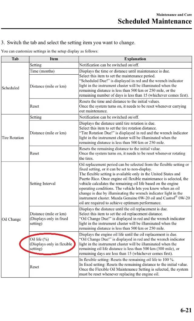

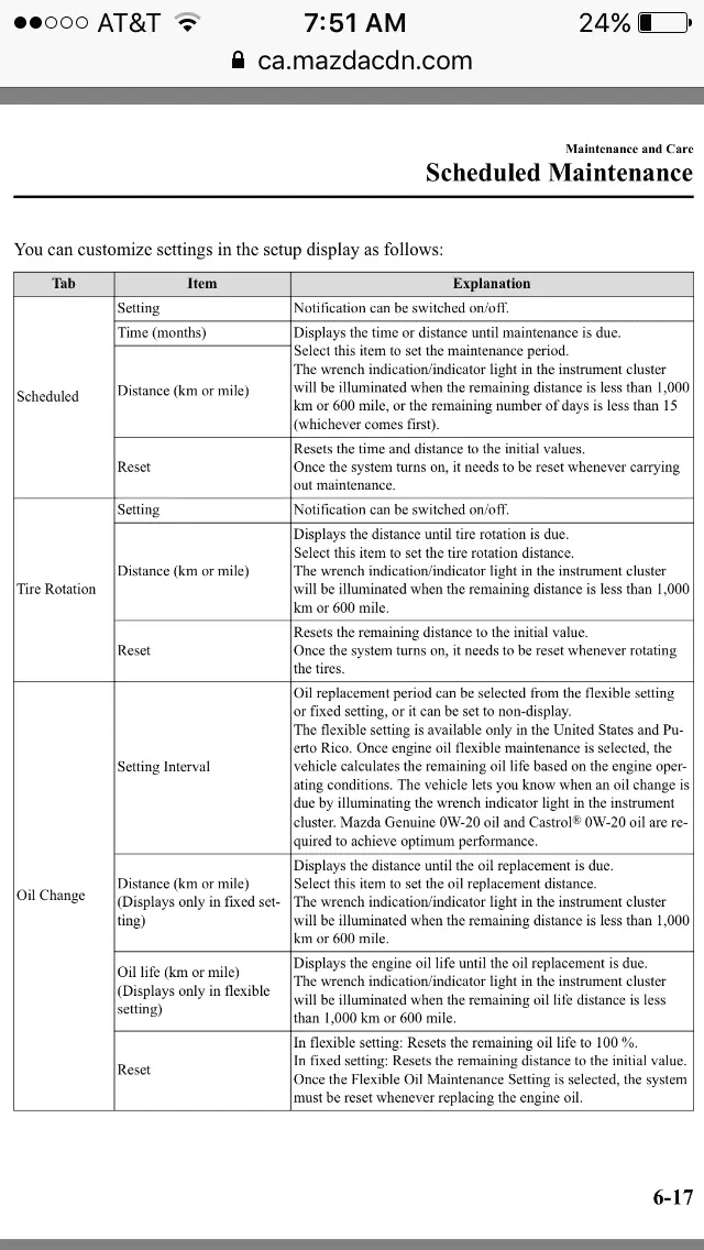

Compare to the wordings between 2016 and 2017 Owner's Manuals, you'll see Mazda does mean displaying km/mile instead of percentage on oil life left under Flexible OCI for 2017 MY. Yeah I also hope Mazda will feature Apple CarPlay and Android Auto as promised in the near feature for US customers!
2016:
attachment.php
2017:
attachment.php
2016 Mazda CX-5 Owner's Manual Flexible OCI.webp 2017 Mazda CX-5 Owner's Manual Flexible OCI.webp
Thank you SOOOOOO MUCH....for clearing that up!!!! NOW I get it!!! I still thinks its ridiculous....but now I understand. I had no context without going back to the older manual.
