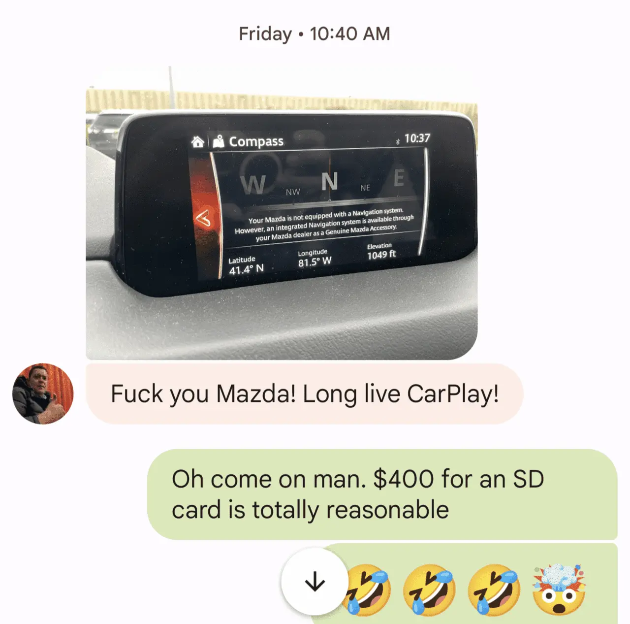

At this point, he's pissed that Mazda wants $400 for a new card. I'll let him tell you.
