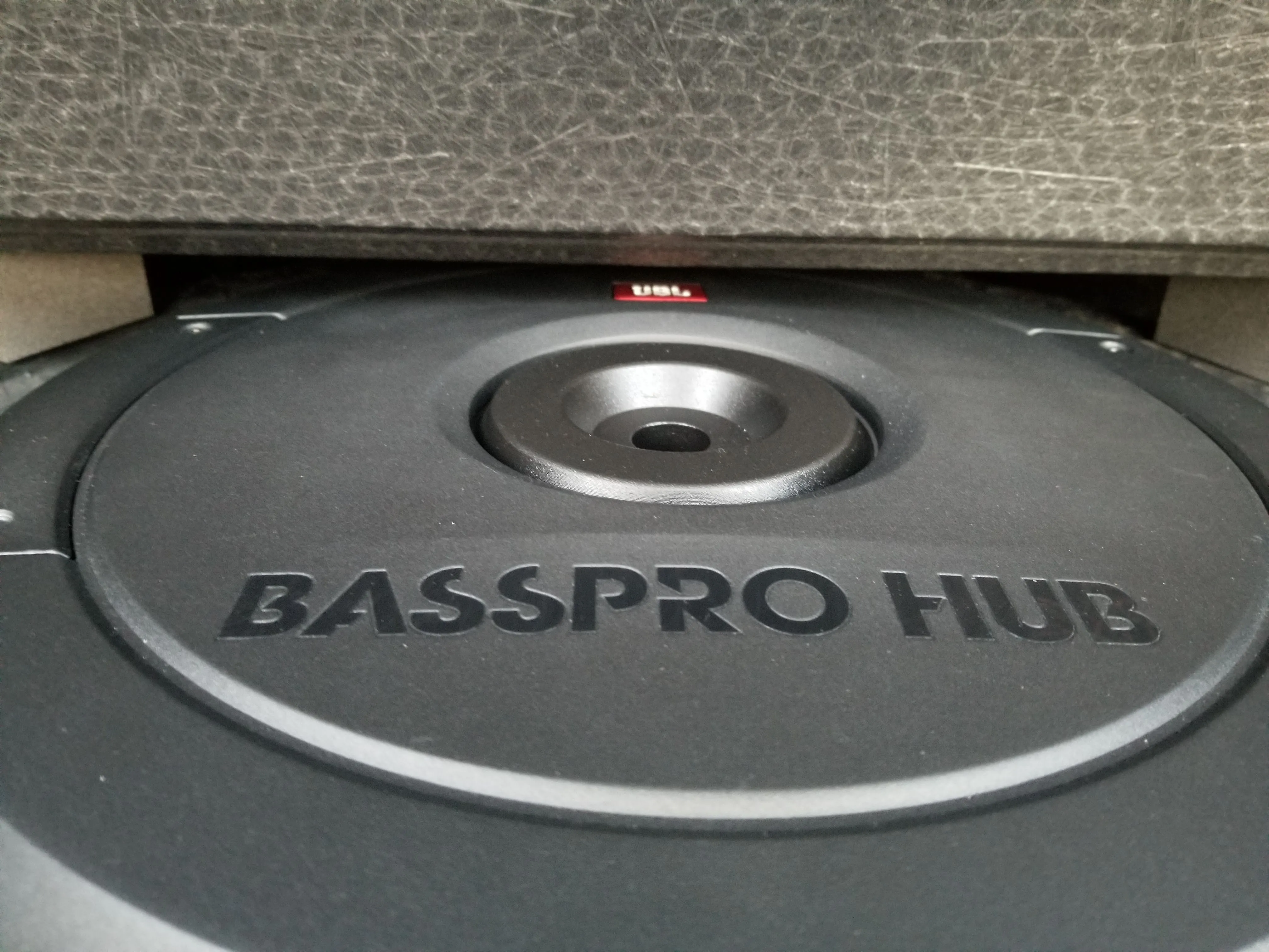

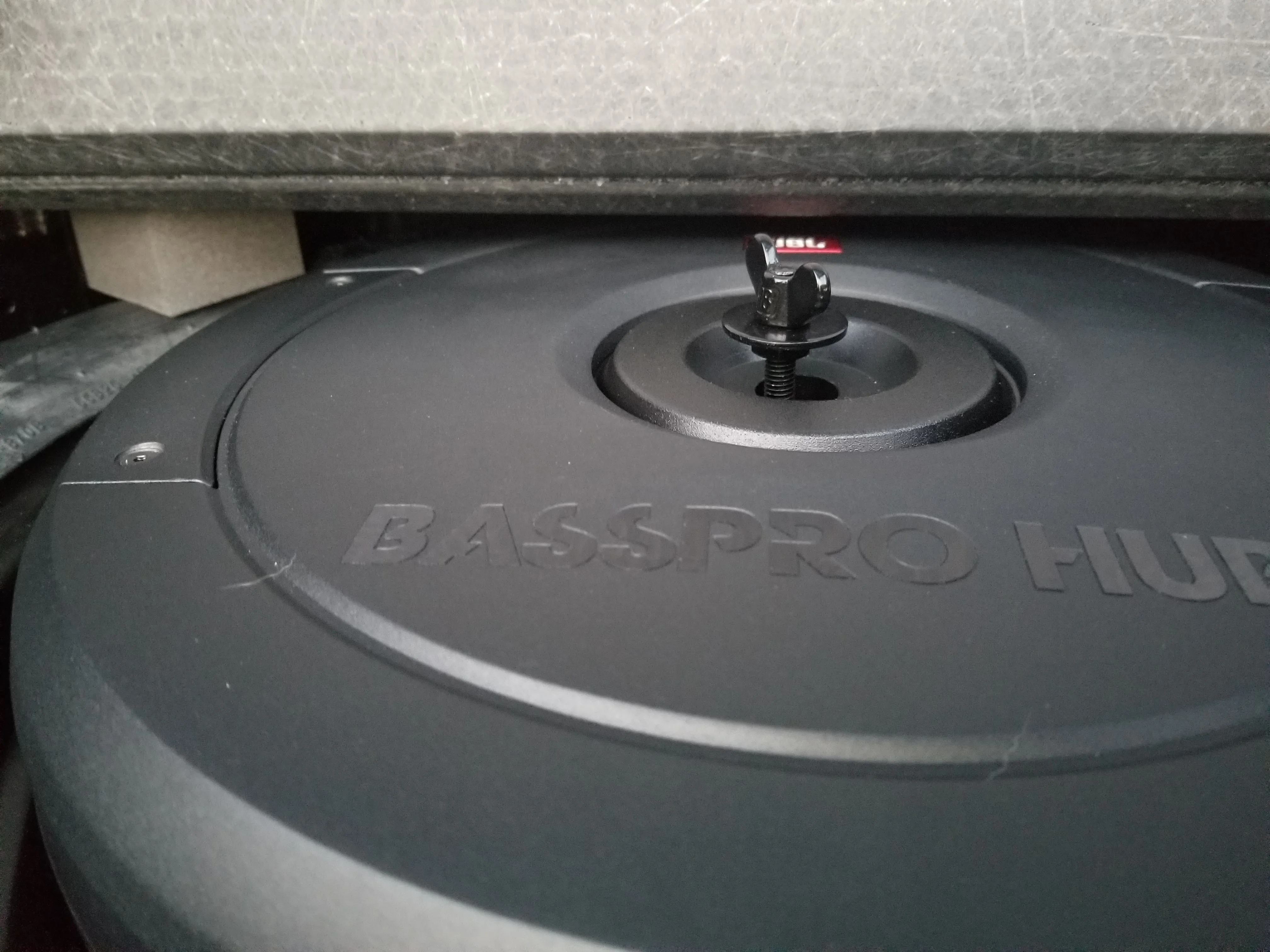

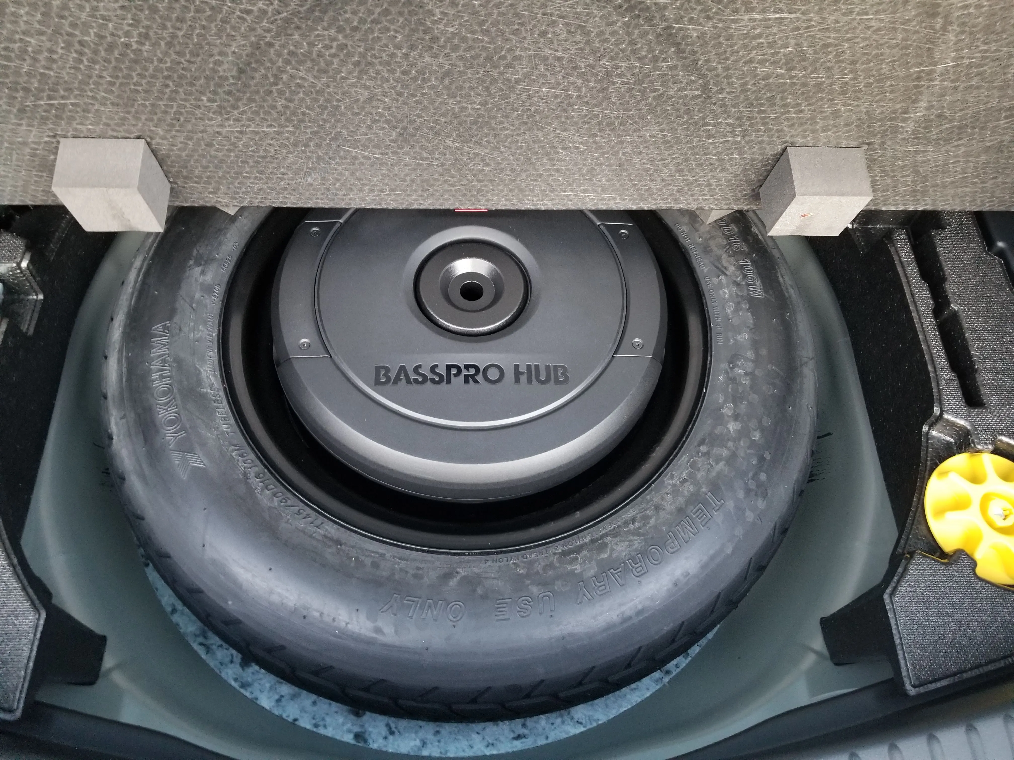

Good news, JBL hub fits with half inch of space between the cover. Bad news, screw rod needs to be cut an inch. No biggie, an easy fix. Can't wait to get this baby installed.
So you have the bolt screwed all the way in/bottomed out, yet it isn't making contact with the new sub?
If so, then I would NOT cut the bolt.
Just go to the hardware store and buy a large washer and rubber grommet(s). Slide the grommets over the bolt, then the washer. This will preserve the bolt, secure the sub, and the rubber grommets will help minimize vibrations.

Too late, I already cut it. But I'm looking for some kind of rubber washer to help with the vibration.

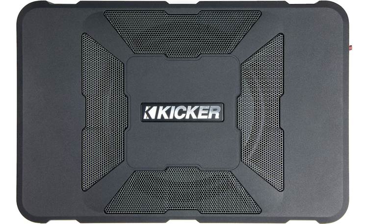

Having spoken to a Crutchfield associate, they said they didn't have anything that would replace the stock Bose sub. He recommended the underseat option but wasn't sure the dimensions would work for our car. The factory sub is a dual voice coil with 4 total wires so that can be connected with bare speaker wire directly to the kicker for the signal. So you if it fit (I never measured), you would basically just be adding another sub and grabbing signal from the factory.
