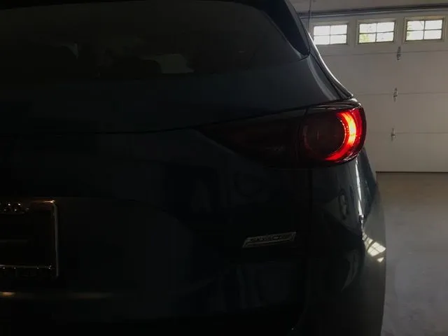

Has anyone else noticed how inadequate the non-led taillights are on the 2017/2018 CX5's? The taillight assembly in the liftgate doesn't light up at all and the only part that does light up is on the curved surface. Seeing how Mazda has all these nice safety features, it's amazing they didn't get the most critical safety feature right (visibility!).

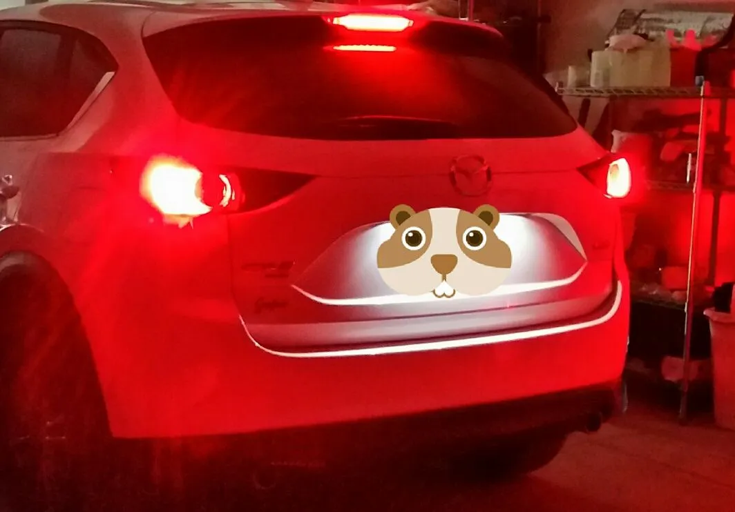

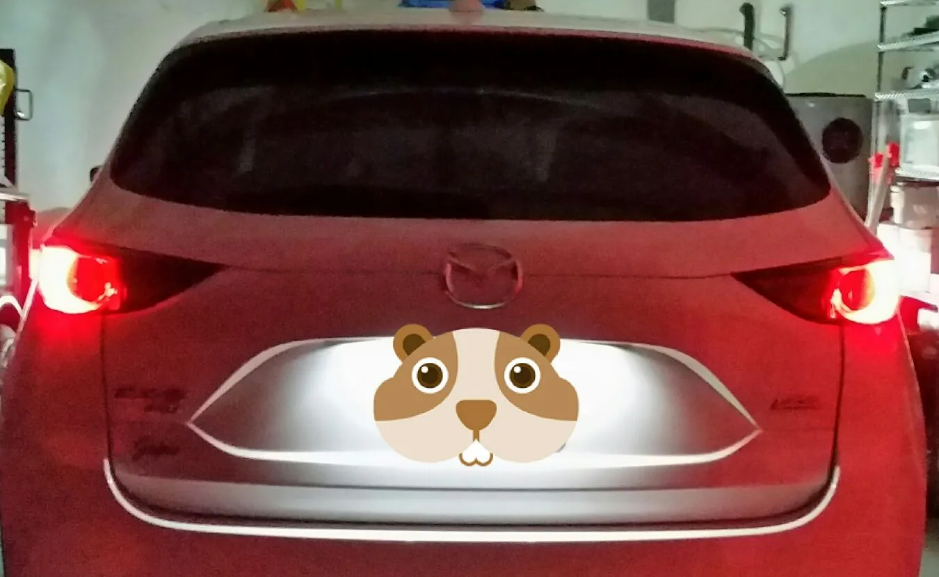

I upgraded my lights with LED brake lights. It made a BIG difference vs OEM incandescent. The 2 bulbs were $80. Not cheap but great quality @ 510 Lumens.
I also updated the license plate lights to LED to make the rear more visible.

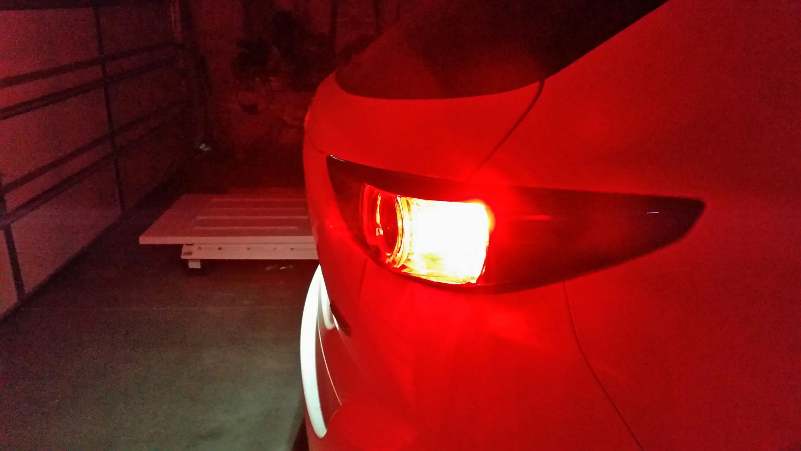

I agree. The quickest and easiest thing is to replace the bulbs with LEDs. Other than that, you would have to install GT taillights which is costly and involves more labor. Plus the LED plate lights help light up the back end.
