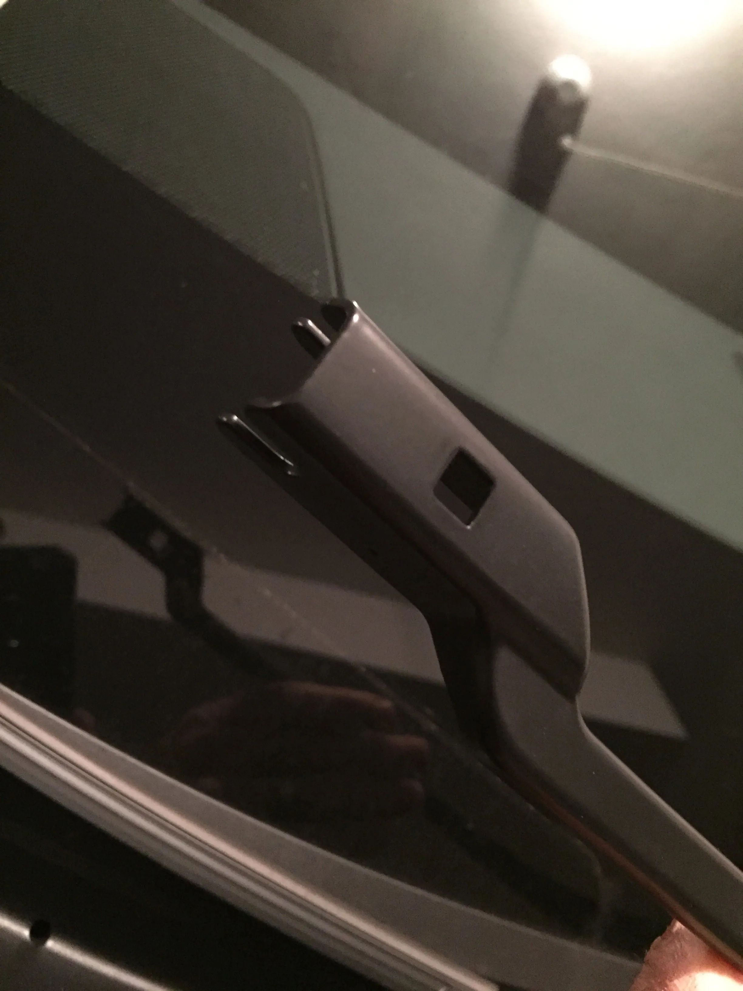

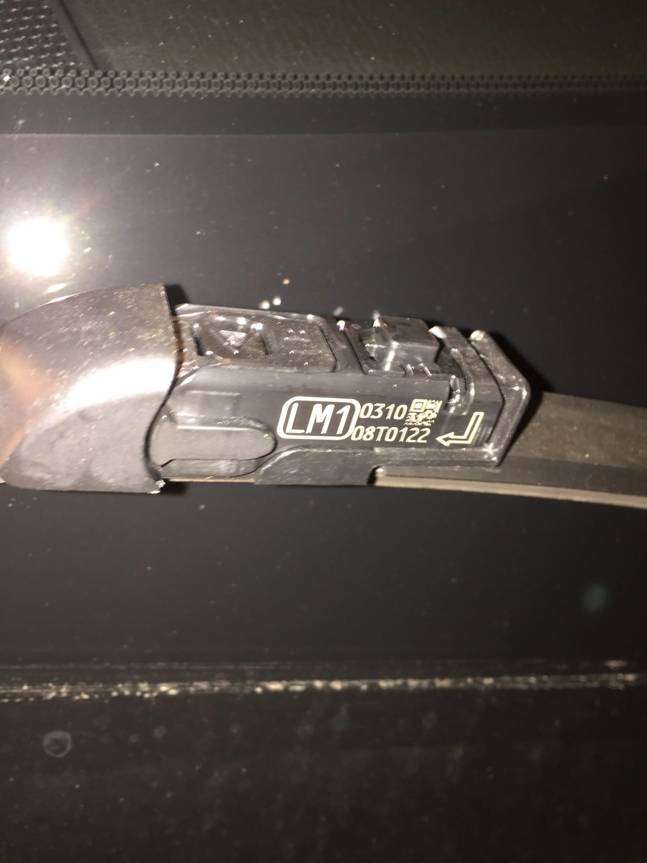

Just went to swap in a pair of Winter blades and discovered a completely new arm blade connector style. Never seen this before! Just did little research and found it looks a lot like a Top Lock style but there's an open channel onto side which is not in any pictures i see online. This should make finding aftermarket blades difficult.
Anyone else seen this type of connector and have advice where to find aftermarket blades which fit?
The guys at AutoZone said they've never seen this type of connector before. They said it looks like a BMW Top Lock, but the channels on the side are not the same.

I saw that Bosch has the TopLock, however the Mazda has a alignment channels on both sides of the arm. Not sure how the blade will hold in the Mazda version. See my original photo uploaded or here.
According to the Bosch website, the ICON winter blades in the appropriate sizes are NOT compatible with the 2016 CX-9. No explanation is given.
Additionally, neither Trico nor Anco list front wiper blades for the CX-9. Anco lists only one for the rear.
