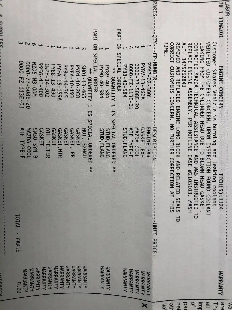

The head gasket was the problem, however Mazda replaced the entire engine because it was still under warranty. (Dec 2020 engine). I love this car. So I hope it was a first run problem.

That's interesting. Someone here said they need to remove the engine for a head gasket. I'm wondering if that's because they would need to machine both the aluminum head and block. That would also change the compression ratio (unless a thicker gasket can compensate). Maybe that's why they replace the engine as a head gasket job changes the engine somewhat.
Back in my Supra driving days, the 7mgte motor was kinda known for blowing head gaskets. A new head bolt torque spec from Toyota supposedly solved it. Those that blew a head gasket would often replace it with a metal one, but that required machining the aluminum head and was fairly expensive. We might be facing something similar here.
Upvote 0
What do you mean by Dec 2020 engine? Is that the date the new engine was installed, or manufactured?
