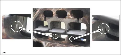

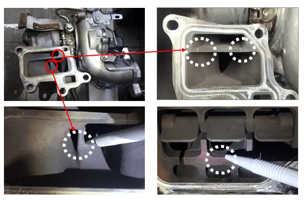

Unfortunately the Exhaust Manifold Gate in 2.5T becomes defective with age....needs replacing.
This is why engine lacks power.

Yeah, one guy has posted that on a RX-8 forum and nobody else on any other board has done so. The issue here was a faulty fuel pump.
Yep, those pictures have nothing to do with the loss of power reported in the original post.
For posterity's sake, here is where the pictures came from. The TSB states that the cracks do not affect performance or cause noise.
Time AFTER that original 'issue' Mazda NAO Bulletin, Mazda said the manifold 'cracks' do not have concern for performance and not to replace said parts with new ones.

Sorry not sure what you're trying to say here.
The pictures you posted were screencaptured from the same TSB linked above (dotted lines are the exact same). Regardless of timing, the point is that they have nothing to do with the power loss mentioned in this thread, and in fact have no impact on power or noise period.
@AdzamOZ got your message, I understand now. To clarify for any future readers, AdzamOZ posted those pictures from an internal Mazda service alert, before the TSB was created. At that point in time, the cracks had just been discovered, and nobody knew if they might have affected performance.
Some time after, the service alert became a TSB, which explains why the images are identical. Apologies for the confusion, @AdzamOZ.
With that said, it appears that the original issue has been traced back to the fuel pump, and has now been resolved. Thread closed.
