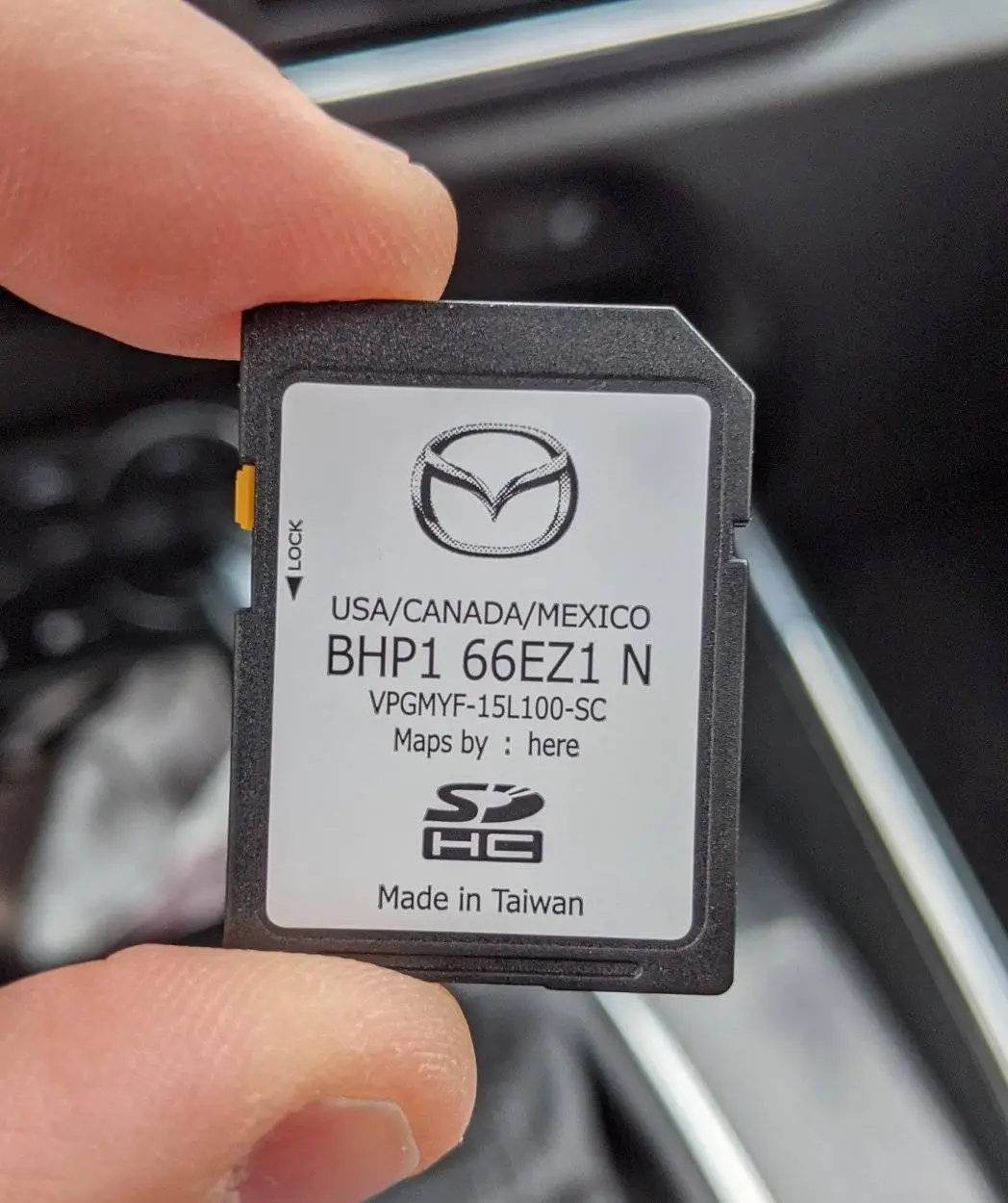

Mazda replaced my nav SD card under warranty. They even gave me the latest nav card that just came out recently (ends in "N" I believe). Now, it hasn't been -30C since I got is, so I might need to wait until next winter to verify that was the fix. Here's the TSB for it: TSB 09-18-01

thank you so much for the info. Mine was no longer under warranty.. They (svce dept) said I could contact Mazda and see if they would help with a new SD card but since I haven't had any more with the Bluetooth and rarely used my nav, it just wasn't an expense I wanted to deal with, lol....thank you again for information
You can copy the oem sdcard to any other sd card. Copy all files and folders as they are currently to a pc. Insert new sdcard format it if needed and copy everything as it is to the new card. I did it with a 16gb faster sdcard and it works great. Now the oem is a backup.

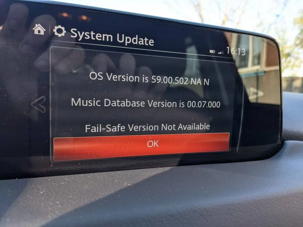

Hi! Today I have almost bricked the system. Started reinstall from 59.00.502 to 70.00.367A, to get Android Auto working, and during "Preparation for update" stage accidentally turned the ignition off. Fortunately the system was able to recover and works fine. But fail-safe is missing now. Can someone share fail-safe for 59.00.502 NA N?
