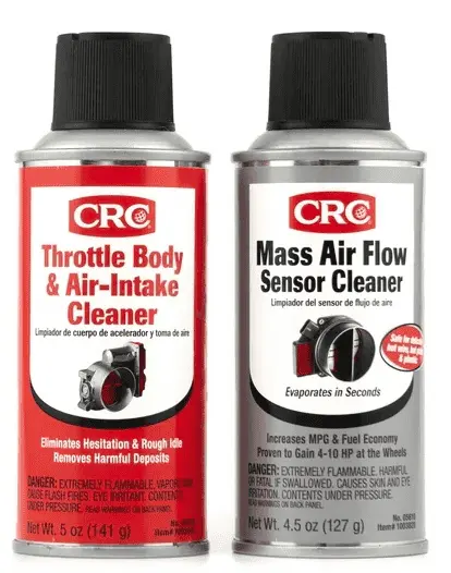

Many years ago I had a car that started doing this. First thing I would check is to make sure there are no leaks in the air intake system - check the piping and the clamps to make sure they are tight. Check for any holes or cracks in the tubes. After that I would try cleaning the MAF sensor (use the correct product for this). If that didn't work, I might consider a replacement MAF sensor.
The throttle body can use a good cleaning occasionally. This is an example of one brand.
https://www.wikihow.com/Clean-Mass-Air-Flow-Sensor
https://www.wikihow.com/Clean-Throttle-Body
