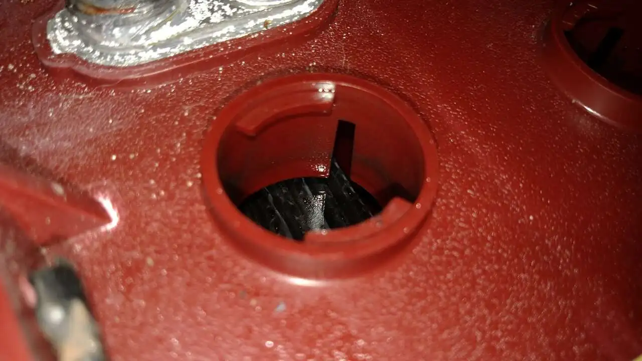

The new, Mazda OE battery has since leaked all over the battery tray and made a crusty mess. I assume it was over-filled at the factory. It's worth mentioning that the original battery never leaked though it did fail a battery test when it was 4 years old.
For this reason (the leaking), I'll likely go sealed / AGM next time.
It's hard to make a good photo of a properly filled battery cell. The new battery should have been correctly filled with dilute sulfuric acid electrolyte before it is sold. After that the water does vaporize slowly out of the dilute acid and needs to be replenished with distilled or demineralized water. Open the cell caps. You'll see a tube going part way down, and the tube has a slot across its bottom. When the fluid level is right at the bottom of the tube you'll see the meniscus of the fluid, a curve of the upper surface. This is the correct level; touching the end but not up in the tube. Any amount of electrolyte above the plates is OK. Exposed plates will shorten the battery's life; it needs water now. Bringing the level up to the bottom of the tube gives some reservoir for the normal loss of water.
