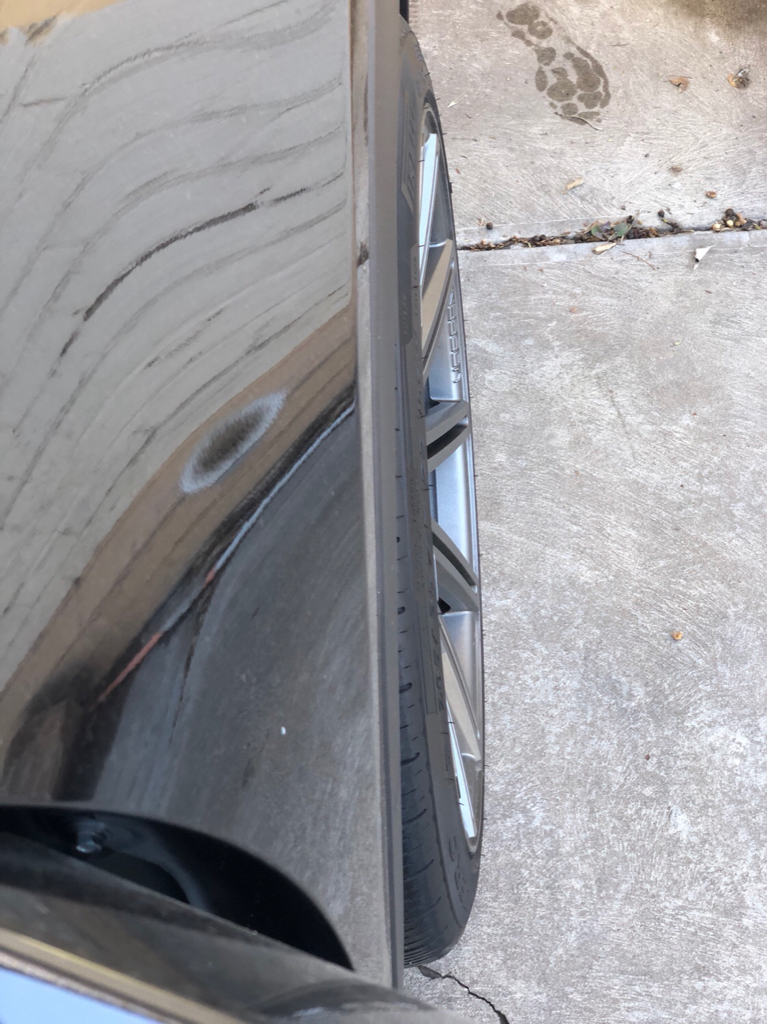

Go for it but the lower the offset the better because them guards can swallow!
2016 Mazda CX-9 Azami (AUS)
Hi Edgar, bumping your thread as I have a question about the width of the wheels you chose (10.5") with that offset (ET+30). How close does the inner wheel/tire sit to the suspension assy and inner fender guard? Have you experienced any rubbing? Still able to make full-lock u-turns without issues?

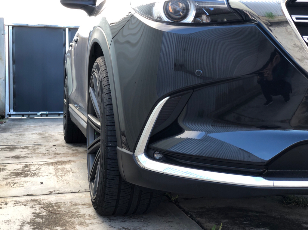

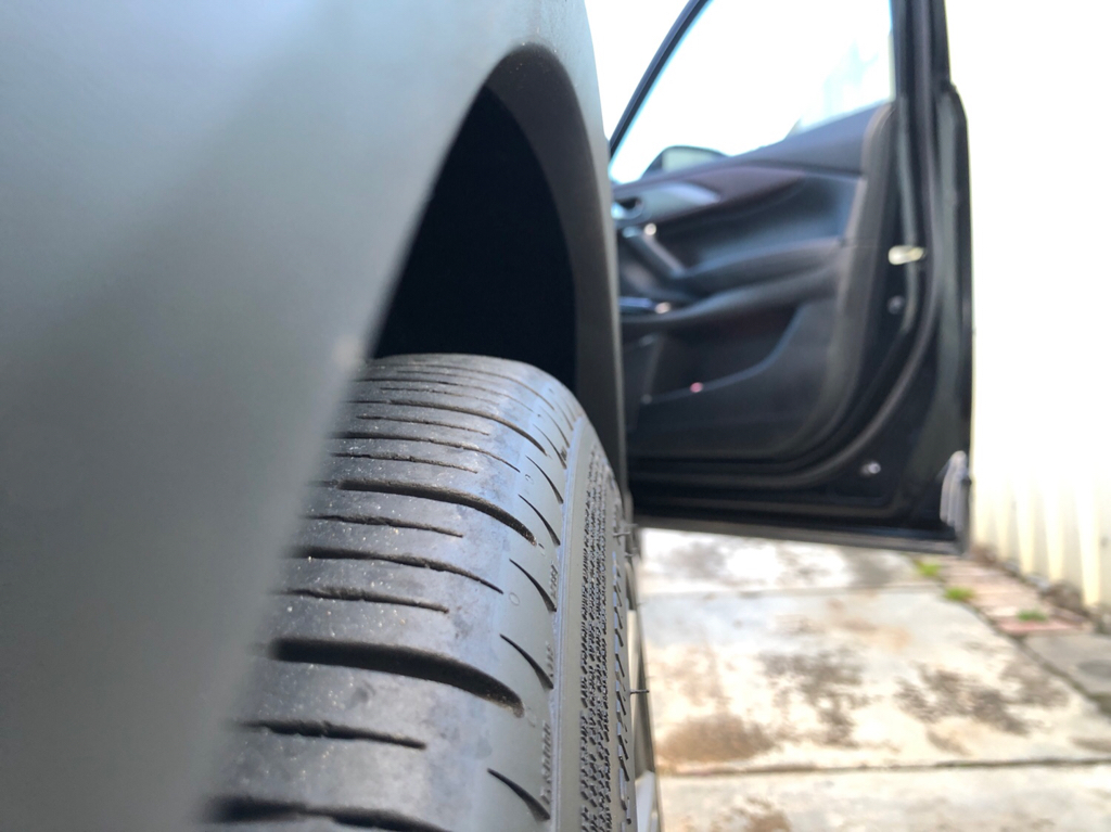

Hey, apologies for the delay, for some reason I didnt get any notification on the new posts.
The lower offset definitely clears the suspension. Ive had no issues with fender/guards and full-lock u-turns.
But this is because Im running on stock suspension, if youre thinking of going for a lowered suspension setup, then it will definitely rub against the plastic trim on the fenders/guard
All I can honestly say is, this car loves wide and low offset wheels, the wheel well is so huge anything less looks kinda soft, if you look at the stock wheels, its probably the one thing that really let the look of the car down.
So the wider the wheels and the lower the offset it makes the car look a lot more proportioned (like its meant to be) and made it looks more Euro

Hope this helps with regards to the perspective on where the wheels sit relative to the guards/fenders
Front Wheels
Rear

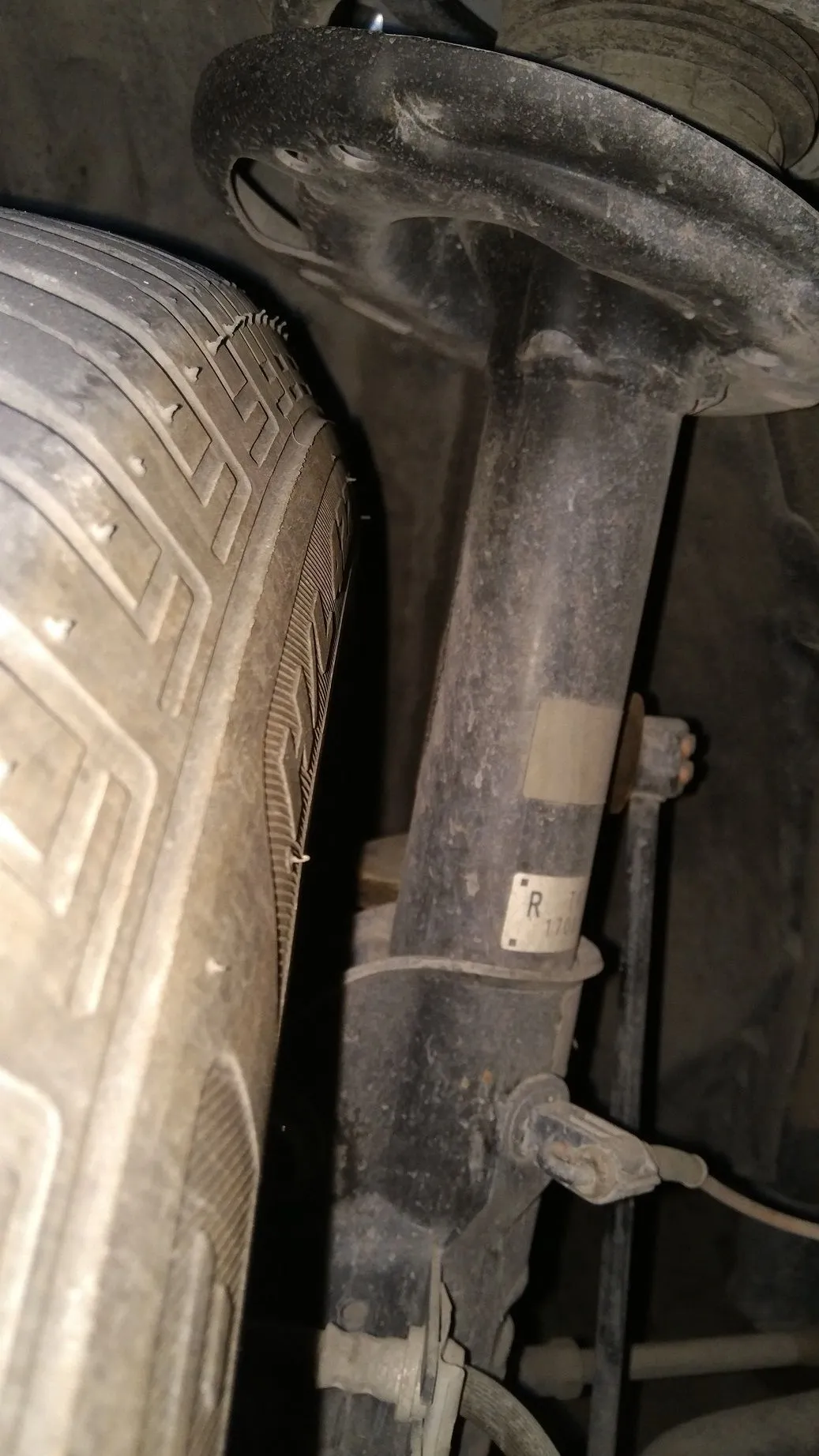

I went with the same sizing as Edgar on my wheels (22x10.5 +30). Like you ZackAttack, I wanted to be sure that they would fit with no issue, so I took a photo of the space between the OEM inner rim/tire and the suspension and brake components behind the wheel. Here's the photo.
attachment.php
Based on this, I estimated 20 mm of clearance. The 10.5 +30 setup puts me 10.4 mm closer to the strut, which is fine. With a 10.5 +42 setup, you'll be sitting 22.4 mm closer to the strut. I think the brakes on this car are small enough to clear a +42 offset no problem, but the strut is too close to call just by eyeballing it. I would try and measure the space somehow before committing to a 10.5 +42. A 9" width with a +32 offset should work without issue.

The clearance on the other side of the wheel for my set would be exactly the same as Edgar_C's setup (I haven't installed my set yet, waiting for summer). Comparing 22x9 +32 and 22x10.5 +30, the only real difference is the 1.5" difference in width. So, the 22x9 would sit about 0.75" more inboard than Edgar's setup. It's a nice, conservative setup that should work just fine. Comparing with the 8.5" +45 of the OEM wheel, the 9" +32 will sit 0.25" plus 13mm (or 19.35mm total) further out than the OEM setup.

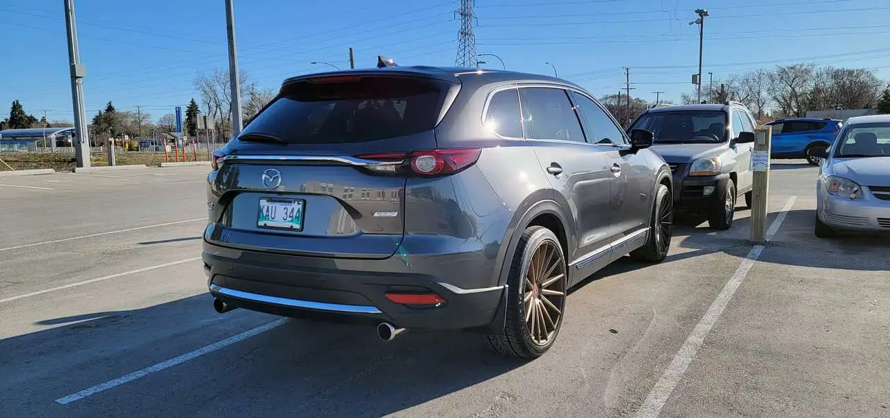

So regarding offset, the lower the number, the more the wheel will "stick out". With the OEM 20x8.5 wheels which have a +45 offset, if you were to switch to a 20x8.5 wheel with a +30 offset, the new wheel would stick out 15 mm more than the original wheel. If you were to add a 10mm wheel spacer to the mix, it would push the wheel out more, as if you had used a wheel with a +20 offset.
In my case, with my 2018, I swapped the OEM 20x8.5 +45 wheels with 22x10.5 +30 wheels. Disregarding offset for a second, the change in width means that I would have 1 extra inch of width on both the front half of the rim and the rear half of the rim, meaning the front face would be 1 inch closer to the fender liner, and the rear face 1 inch closer to the suspension. When you factor in the difference in offset, because the new wheels have a lower offset (by 15mm), the entire wheel is shifted 15mm outwards, making it 15mm closer to the fender liner, but 15mm further from the suspension.
Let's use my wheels and fitment as an example (sorry not the best pic to illustrate).. this is 10.5 wide with +30mm offset, with a 5mm spacer on the rear. With regard to how the wheel looks on the car, its like having wheels that are now 10.5 wide with +25mm offset.
If the Curva wheels you're considering are the same width at 10.5, but have an offset of +40mm, that means that they will sit 15mm further in compared to what's shown above (40 - 25 = 15).
