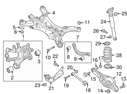

My rear upper shock mount broke. I purchased an aftermarket shock and an upper mount from Mazda. The shock was seized on the lower mount. After a fight I heated it thus destroying the rubber bushing. The shock came off leaving the lower stud with an about 3/4" metal bushing on the stud. It's too large to fit into my lower shock. Do I have the wrong shocks, does the bushing come off the stud? I tried removing the bushing from the stud without luck. I welcome any advice.

The metal bushing should be off from the stud. BTW there’re many different versions of rear shocks from Mazda for gen-1 CX-5. You could get wrong rear shocks. And I really doubt you can get a correct aftermarket rear shock top mount as Mazda doesn’t sell it separately (comes with the OEM rear shock) for gen-1 CX-5.
KDY5-28-910C Shock absorber for 2013 ~ 2014 Mazda CX-5 to 5/13/13.
KR27-28-910H Shock absorber for 2014 ~ 2016.5 Mazda CX-5 from 5/13/13, Type 2, without AWD.
KD35-28-910K Shock absorber for 2014 ~ 2015 Mazda CX-5 from 5/13/13, Type 1, with AWD.
KA0G-28-910G Shock absorber for 2015 ~ 2016.5 CX-5 from 11/03/2014, with AWD.
