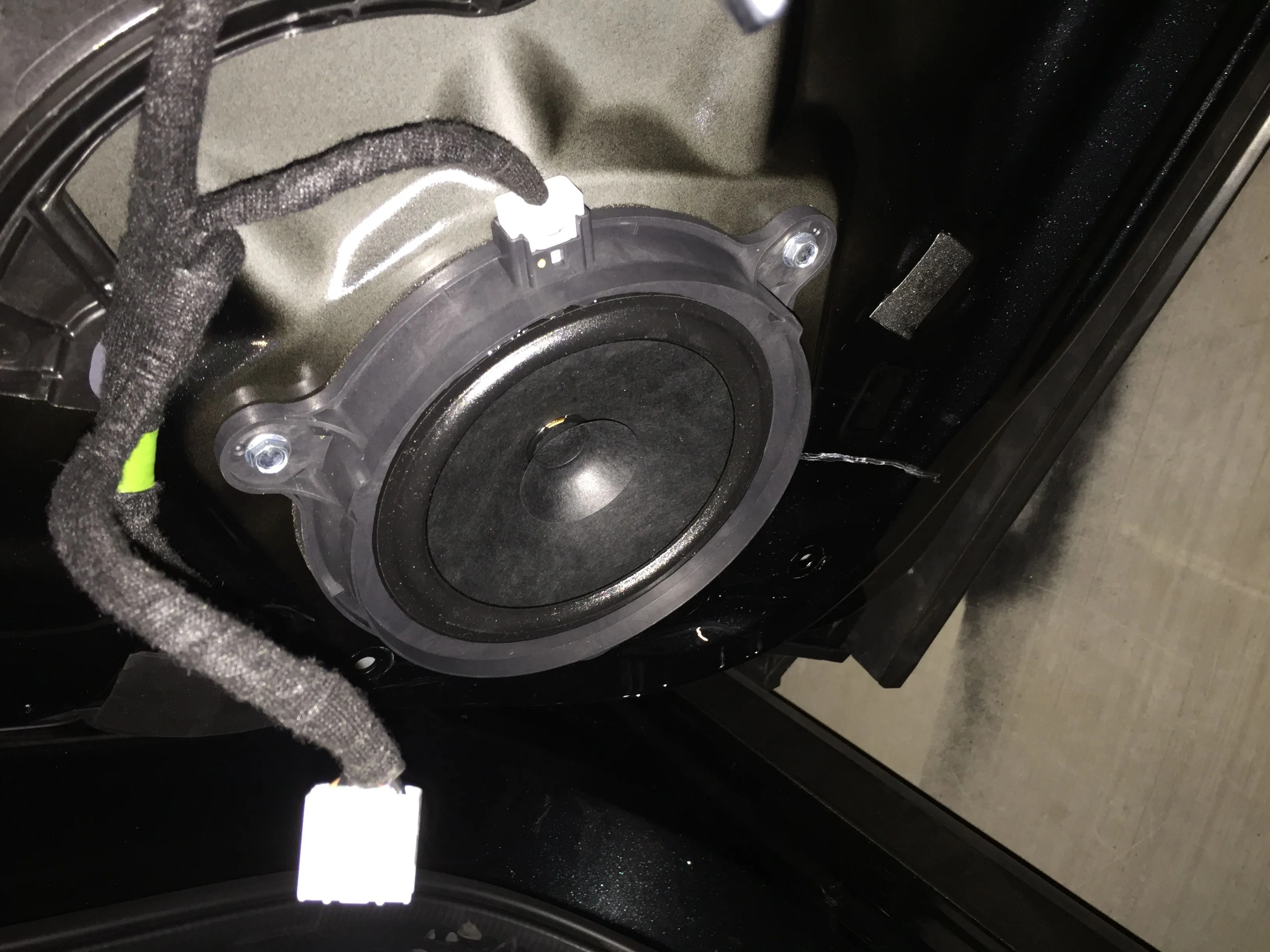

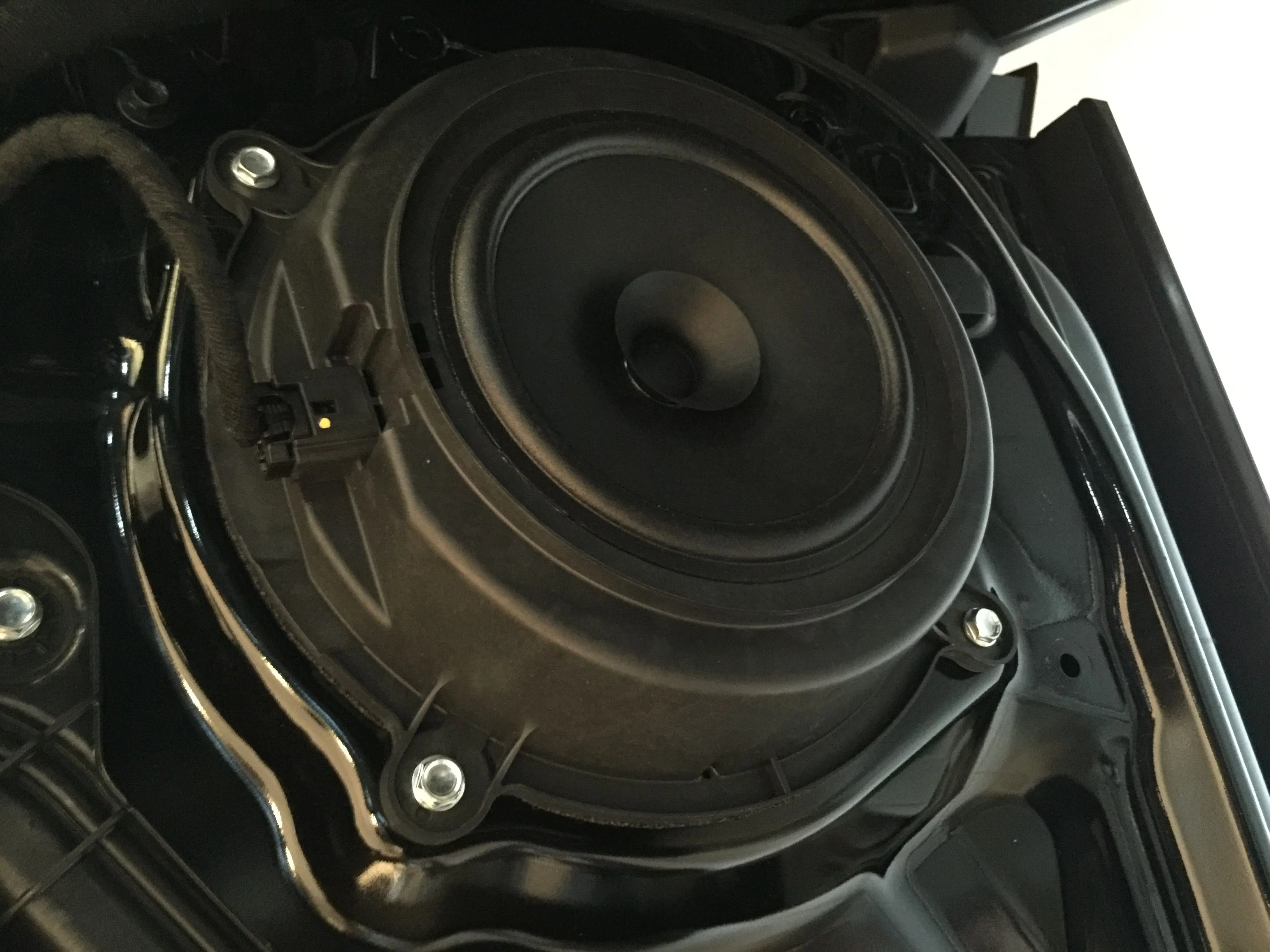

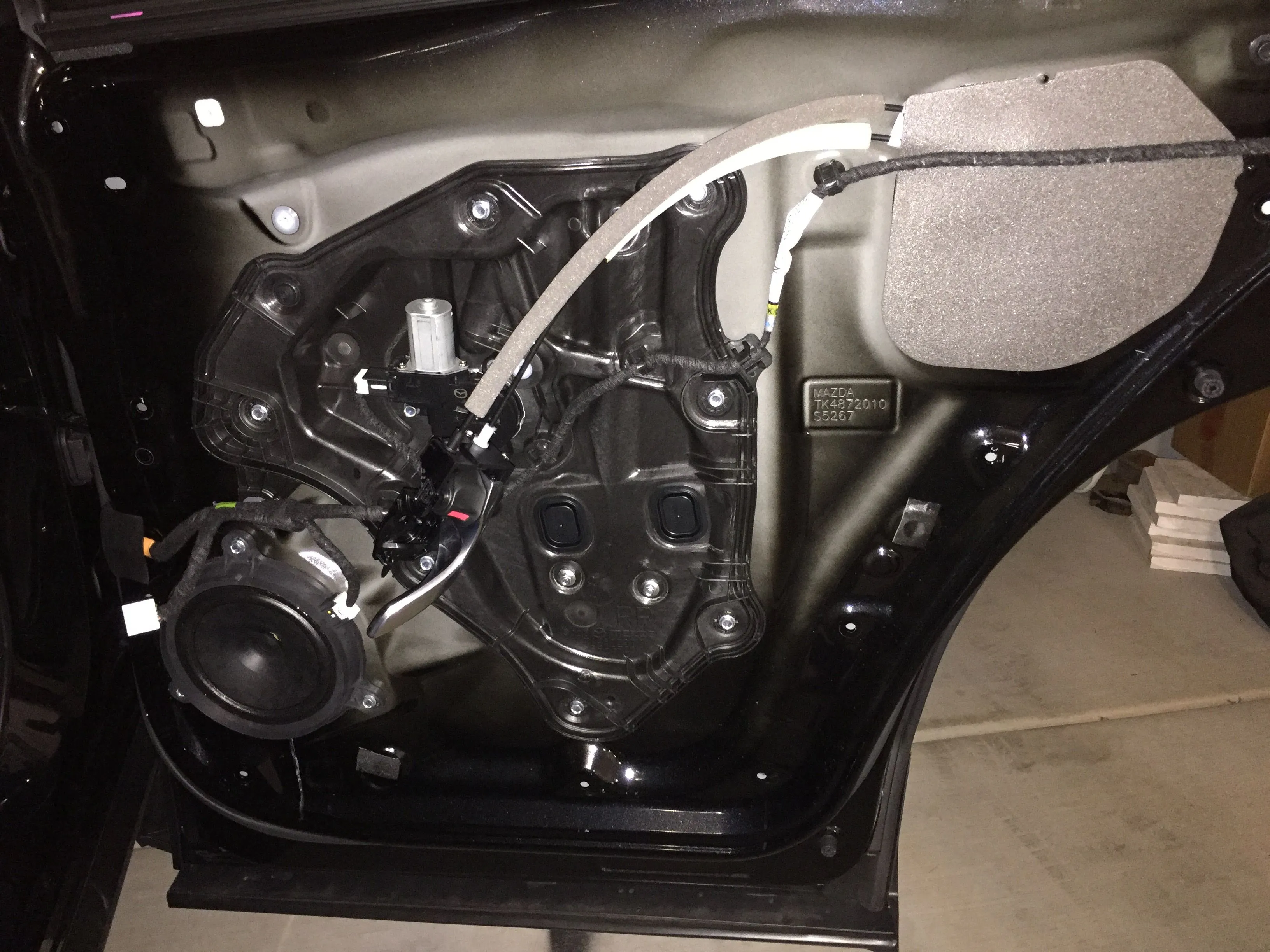

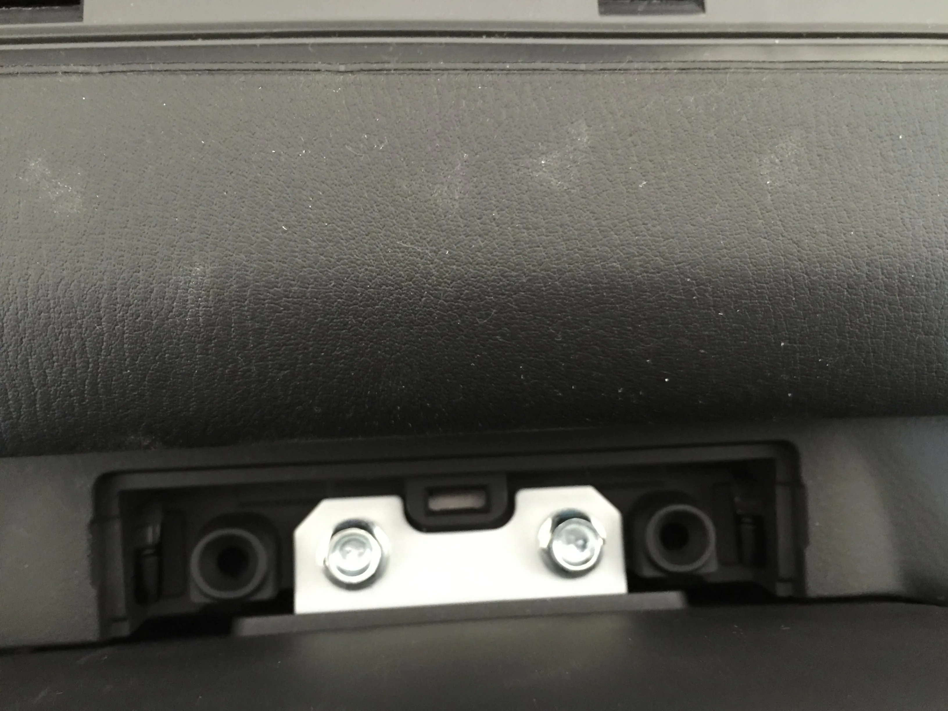

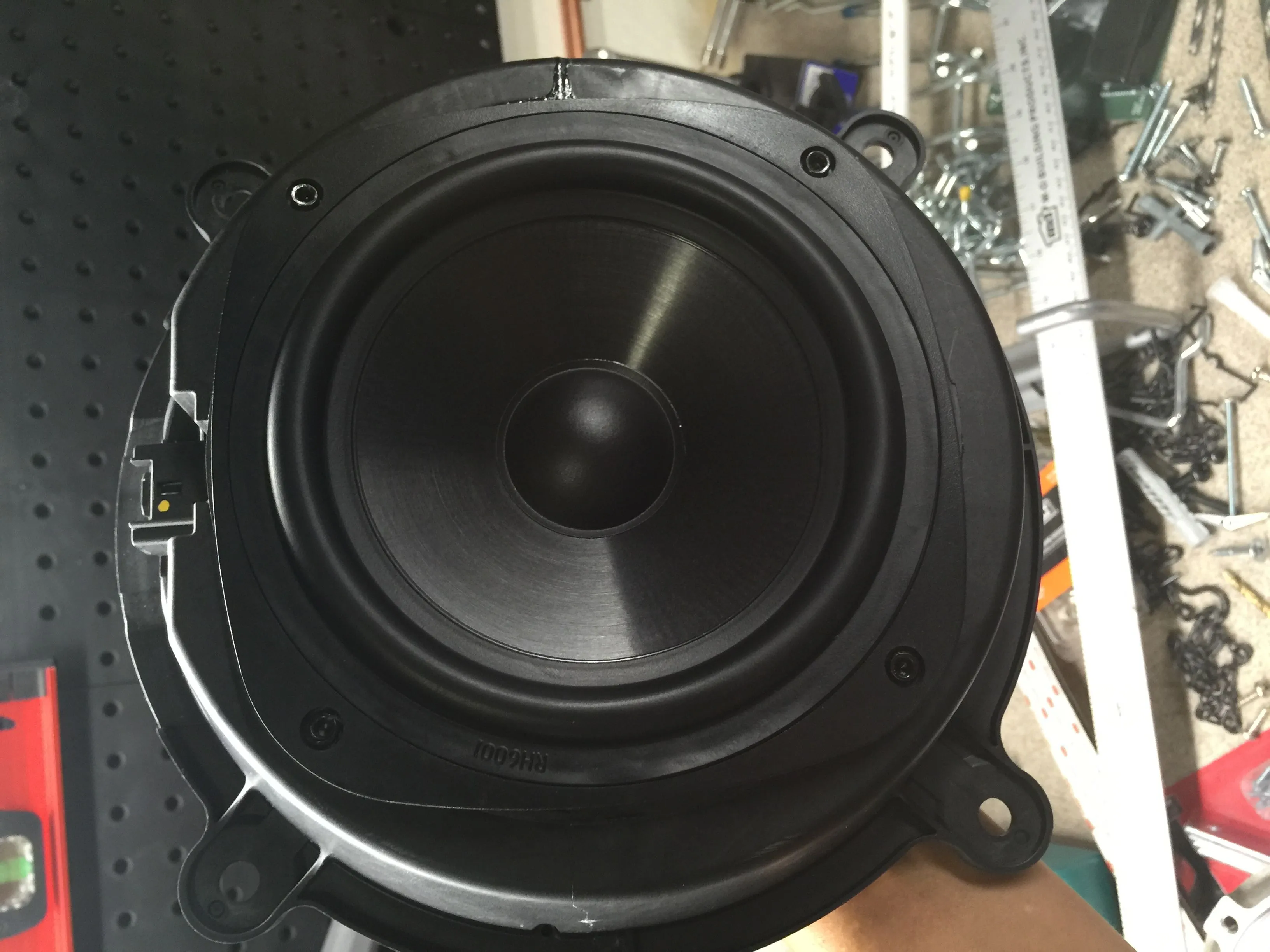

The factory base audio system is a 6 speaker setup, with 1/2" tweeters in the corners of the dash, and 6 1/2" mids in each of the doors. The dash locations have mounts for 3 1/2" mids also, but have blank plates screwed in. The center grill also provides blanks for an addition tweeter and 3 1/2" mid for the Bose system in higher range models. The Door panels each have three phillips head screws, and a bunch of standard door panel rivets around the perimeter. One screw lies behind the door handle cover, and the other two are at the top and bottom of the door pull under a snap on cover that makes the top of the door pull itself.
The head unit is two pieces, with the screen separated from the amp / head unit mounted below the center grill. This is easily accessed by removing a small screw cover plate behind the screen, and removing two 10mm bolts. The screen can then be lifted straight up, and two harness disconnected which attach to the head unit. The head unit can now be accessed and removed by an additional two more 10mm bolts, and then sliding it towards you and up out of the dash.

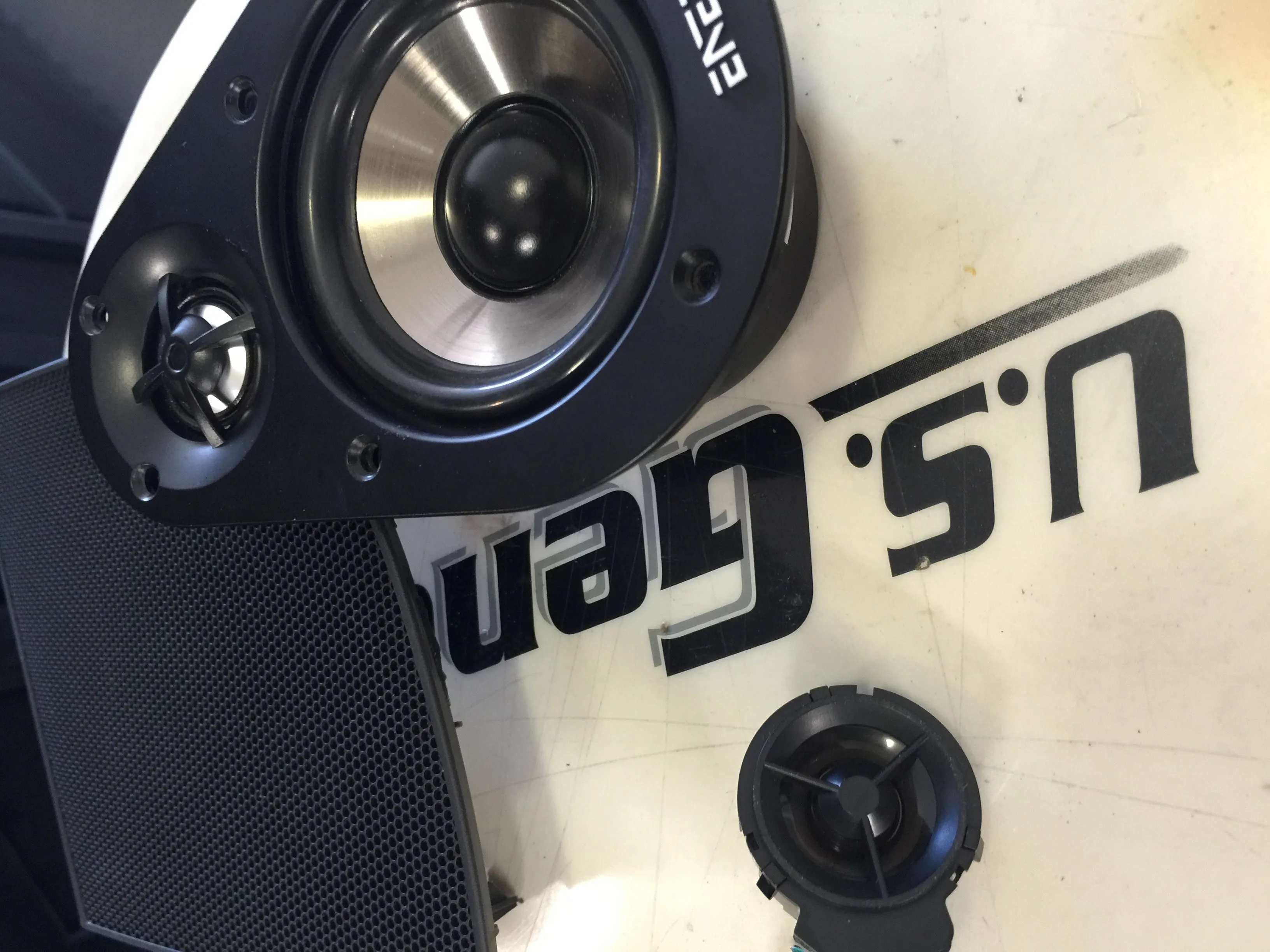

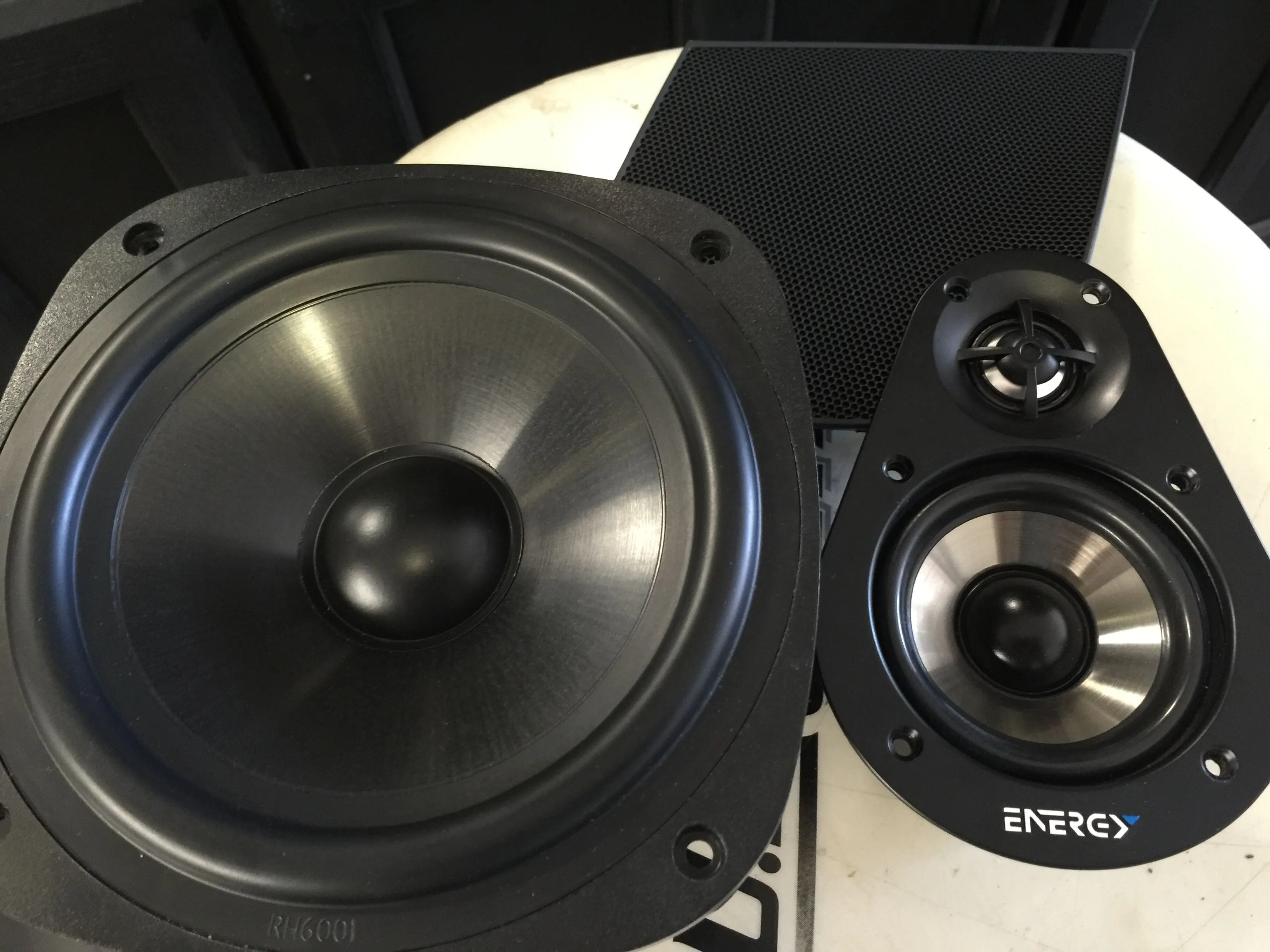

First audio upgrades were to replace the stock speakers. I have spent alot of money over the years on high end audio gear, but decided this time I was going to do something a little different. My home theater is built using Klipsch speakers, and I like their sound and presence. A little while back, I scored a brand new set of replacement Klipsch 6.5" mids, 3.5" Mids, and 1" tweeters from their Synergy and Energy Line at a local shop. I paid a whopping $25 for them all! They did not know what they were obviously :)
I placed the 1" Tweets and 3.5" mids in the dash corner locations, and the 6.5" mids in the front doors. They are crossed over at 2900hz and 50hz at 4ohms.
The rear doors were upgraded using a pair of Kicker KS series coaxial 6.5" speakers and are playing full range above 50hz.
Using stock head unit power, I was very amazed at just how well this setup sounds already. The sound imaging is outstanding, and feels like the band is playing right in front of the car. The speakers play all the little nuances that were missing from the same tracks before, and I can't wait to amplify them and turn them up even more!

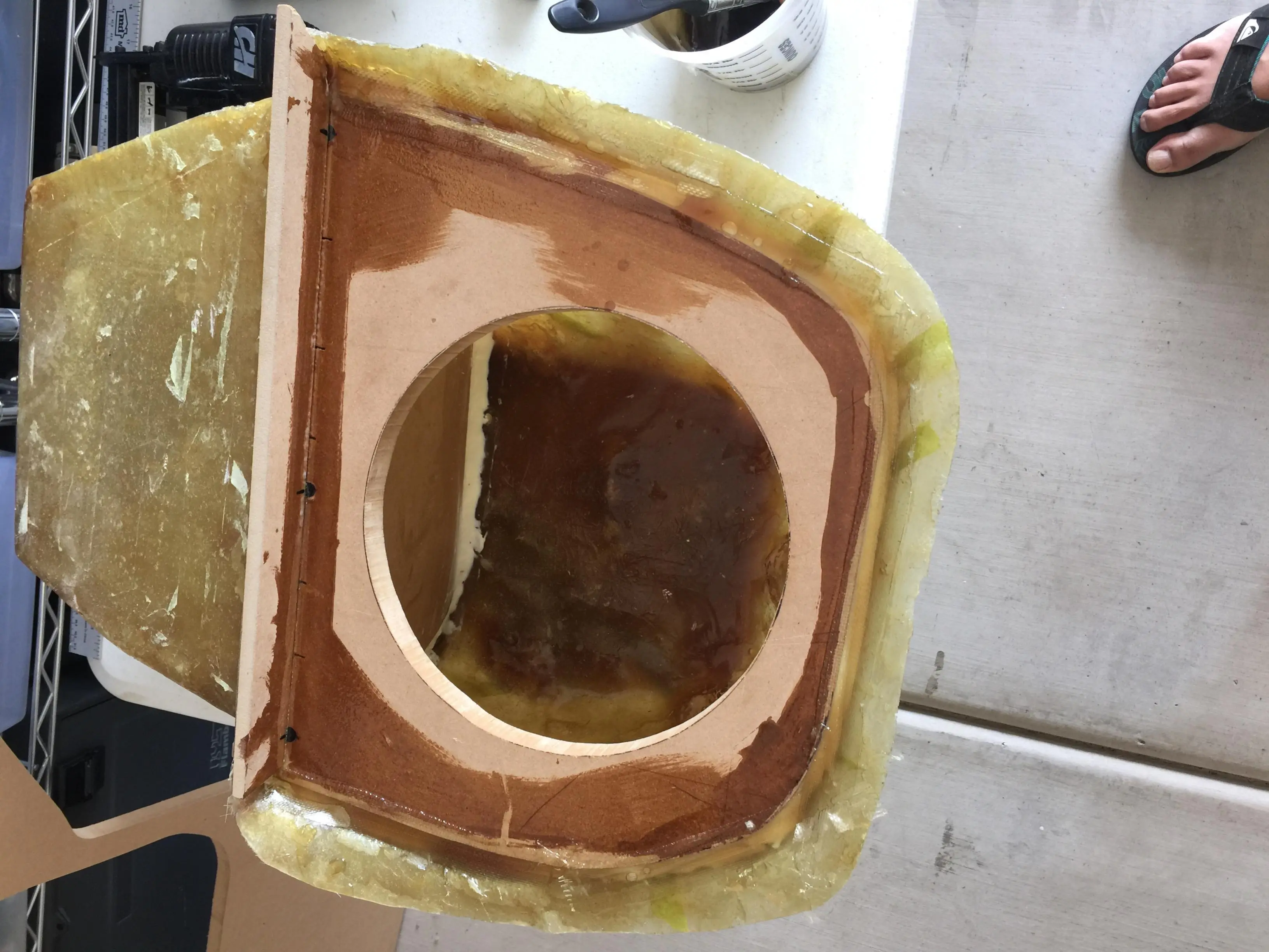

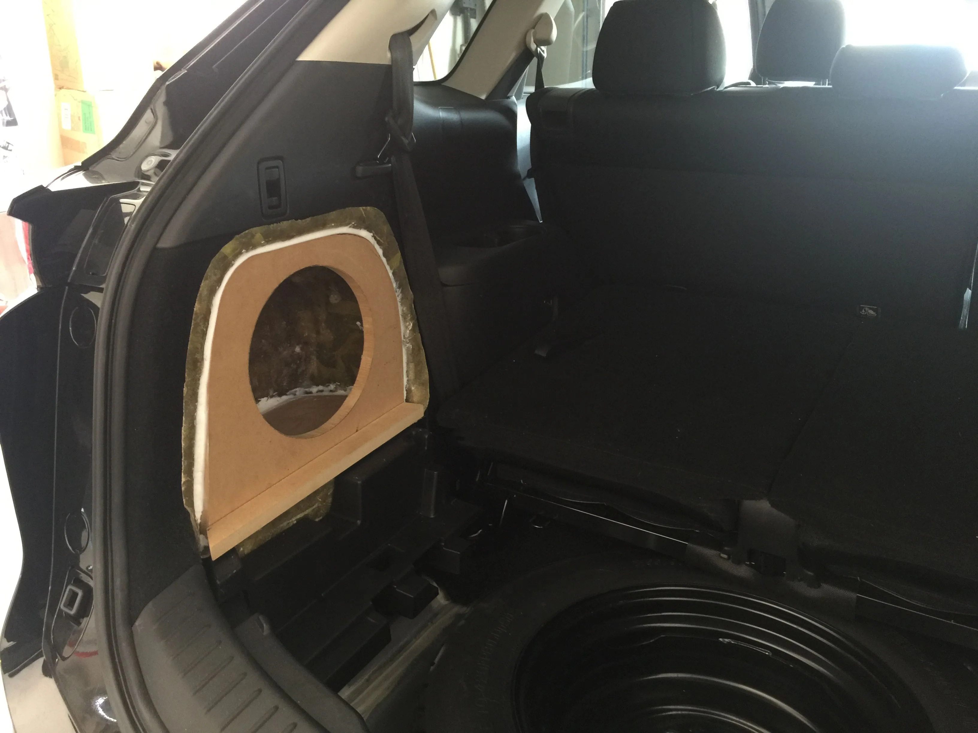

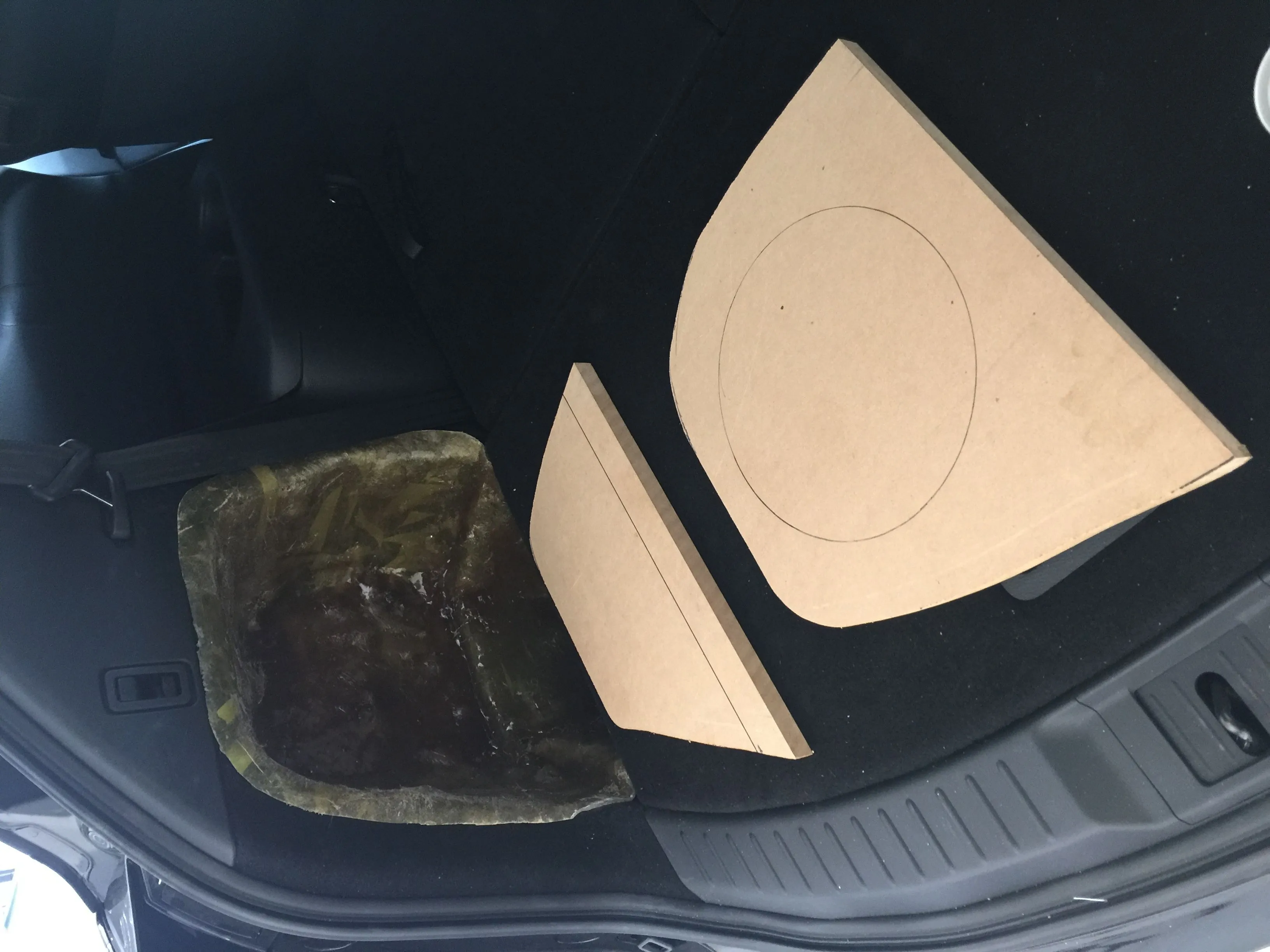

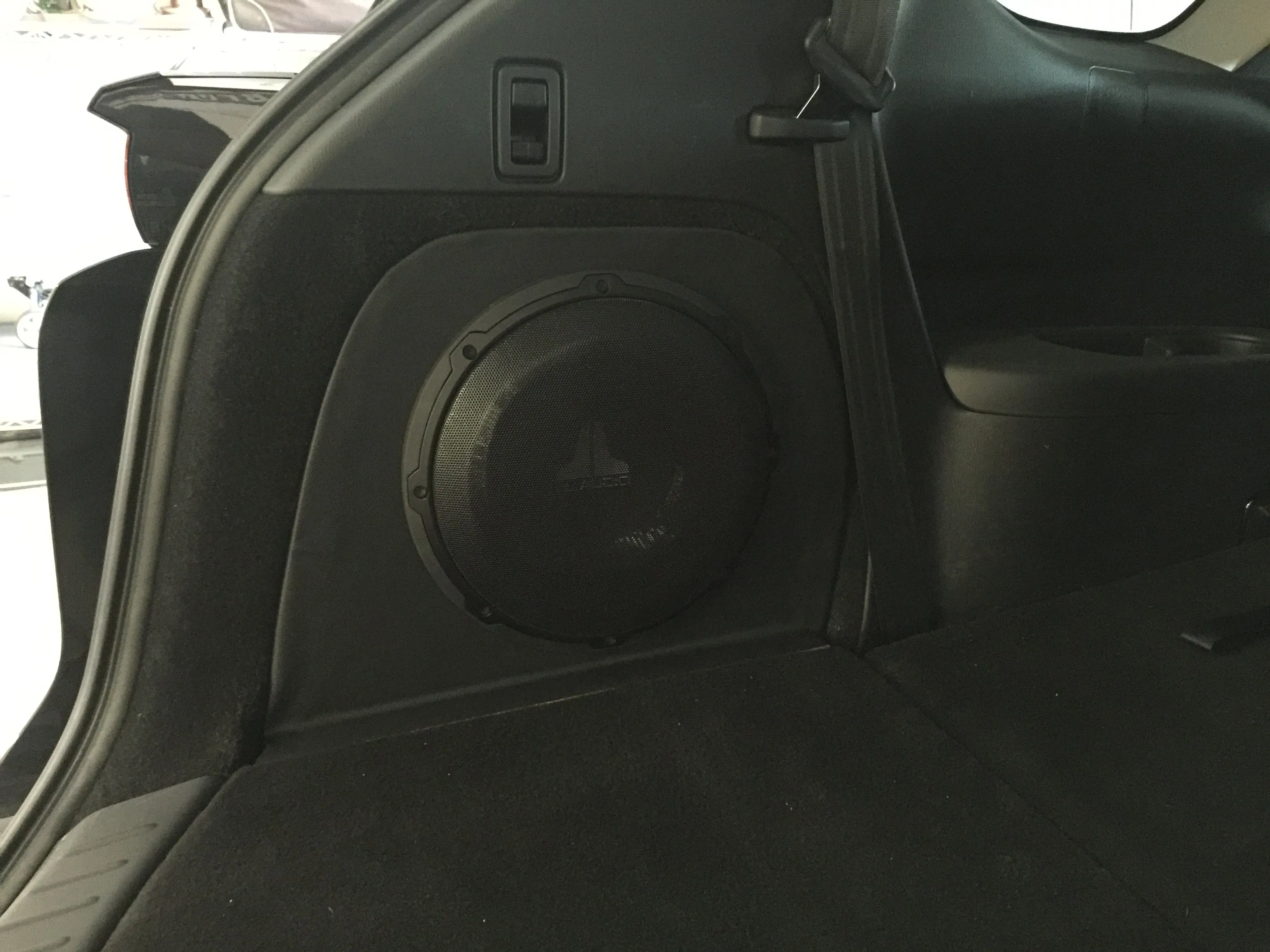

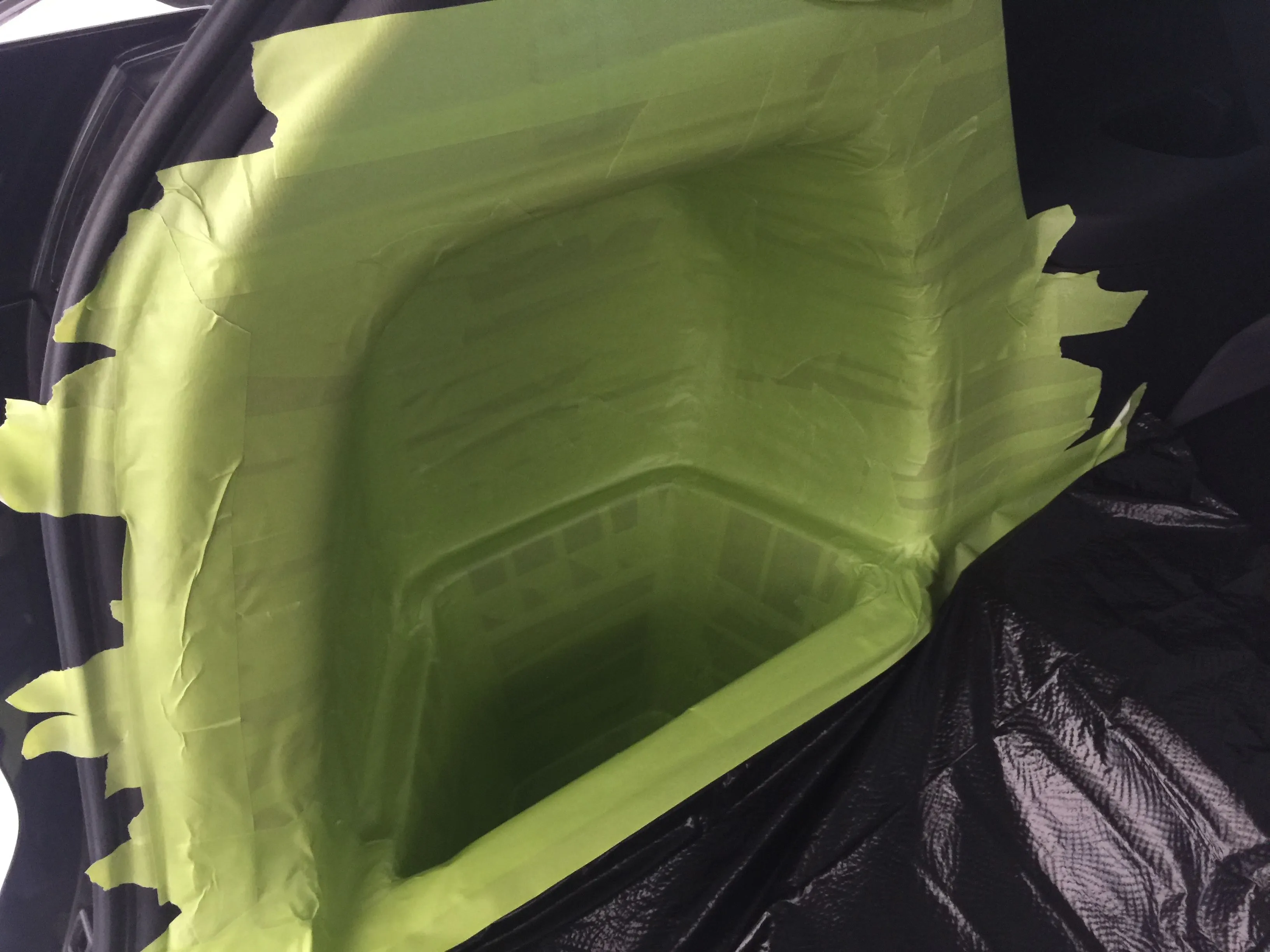

Next I am constructing a custom fiberglass sub box for the rear left cove to house a JL Audio 10W1 V3. I chose this spot as it still allows full access to the spare tire, and the jack / tools are under the passenger side cove. The JL sub only uses 0.55 cu/ft of space in a sealed enclosure, so there is plenty of airspace in this location. I will be installing a Precision Power 5 channel amp that will push 90 watts to each door, and 350 watts to the subwoofer. This should provide a decent setup and has only cost me $500 so far including installation materials!

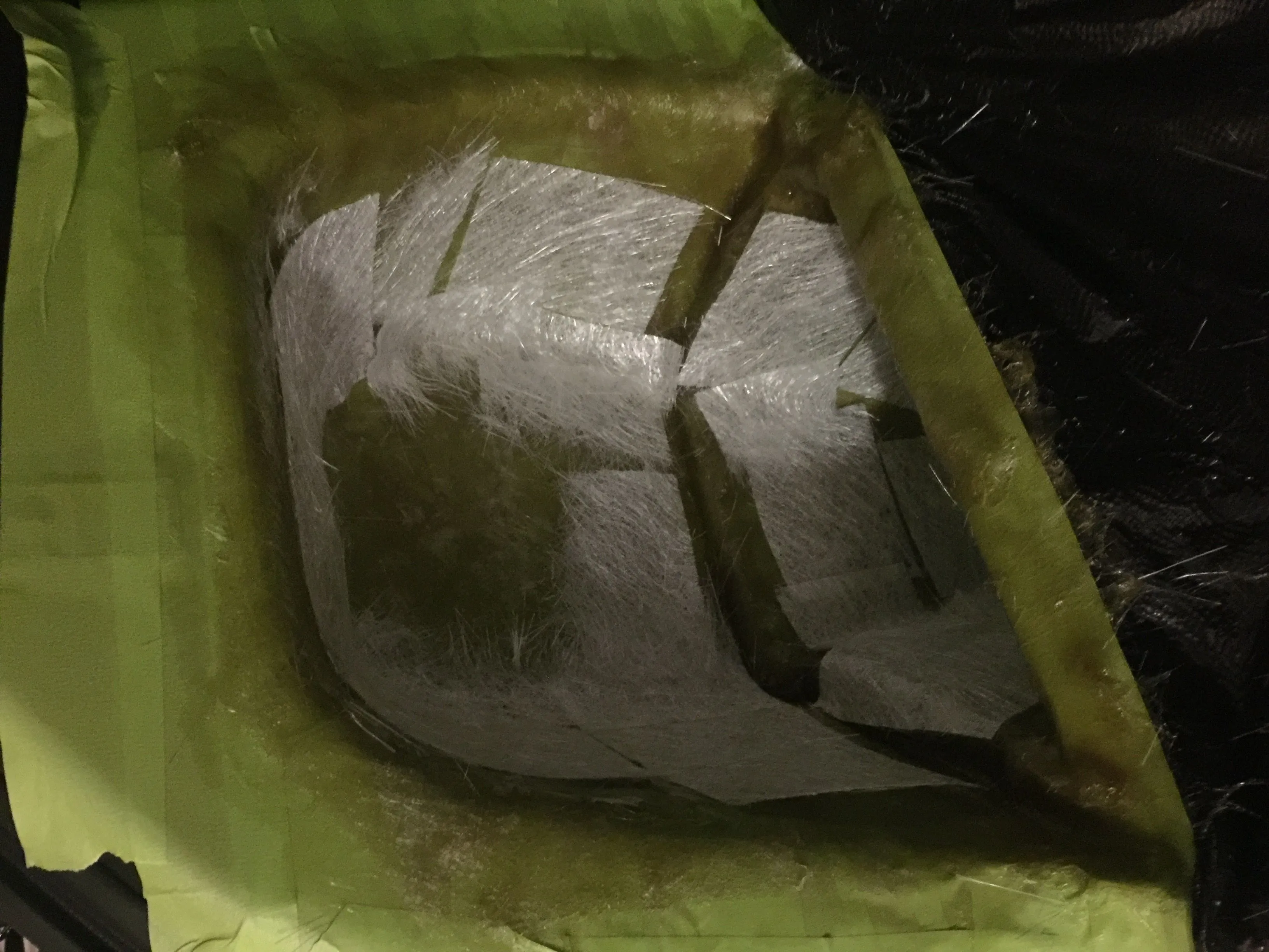

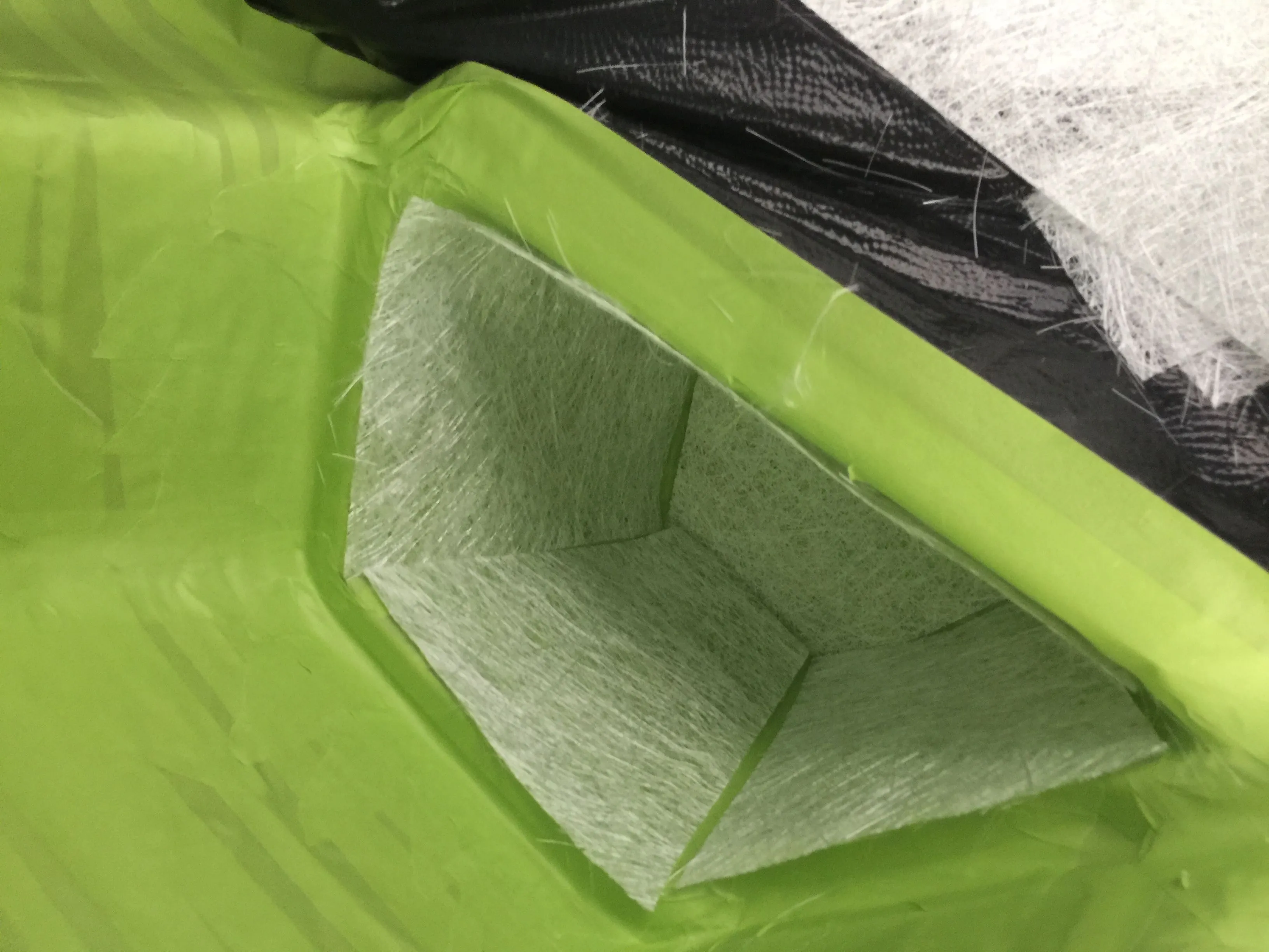

More pics of the custom fiberglass enclosure for the subwoofer

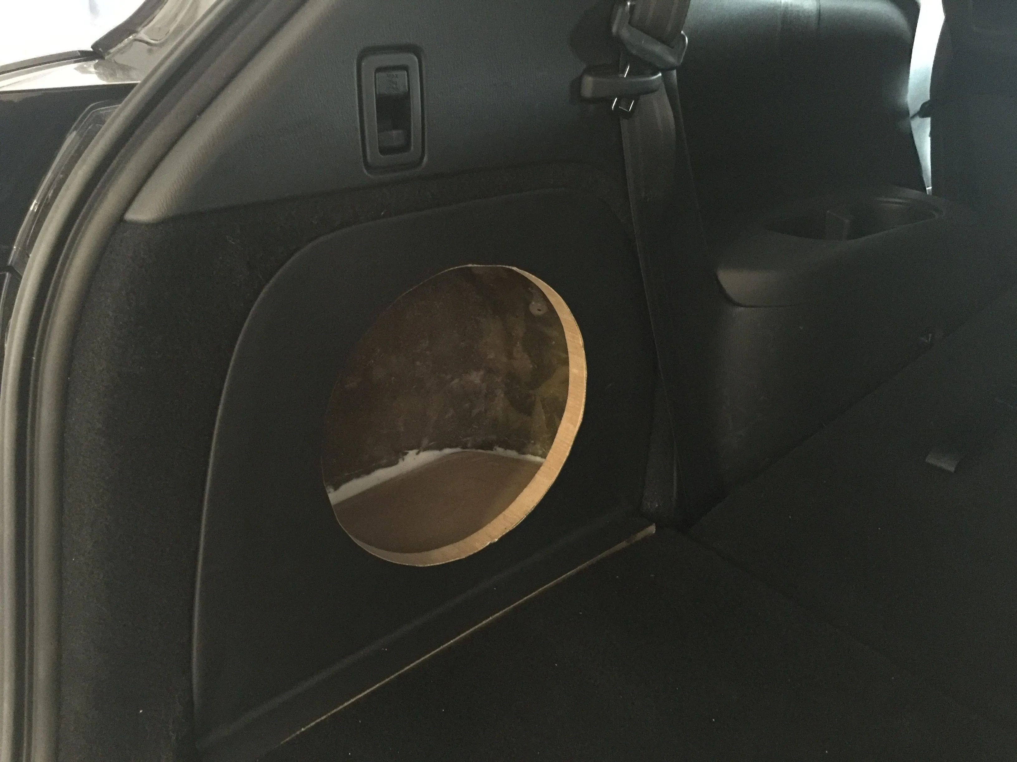

Sub box finished pics

Mine was a non-Bose model, so the front and rear door speakers were 6.5". Without the 9" "Woofers" that the Bose system has in the front doors, the stock bass was lacking. Now with the JL 10" sub, the system is outstanding with true home theater clarity and that immersive sound.
