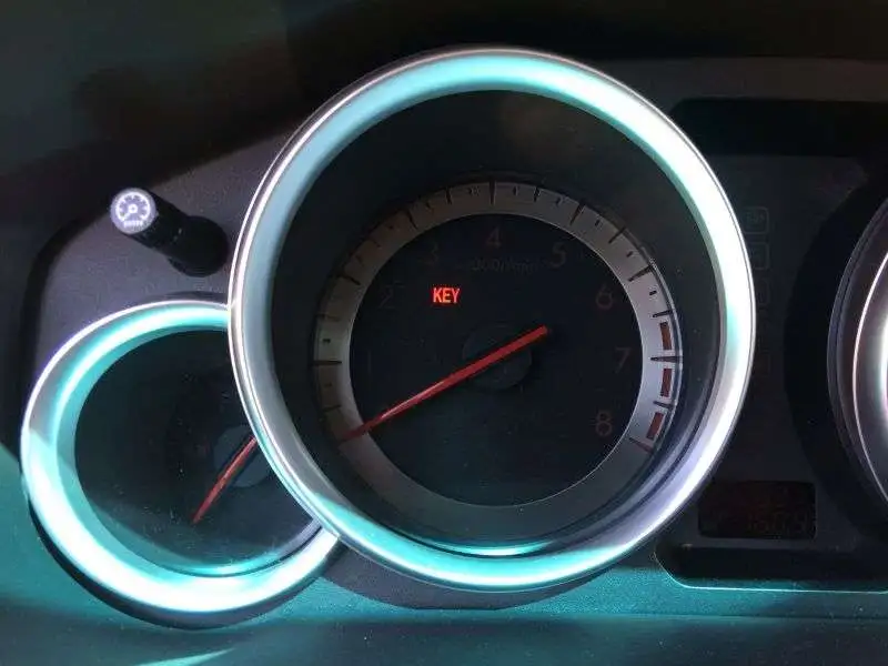

Ok. Any lights on the dash (not the normal icons)? Possibly the "key"?

All the normal lights
Dunno then. The fact that there are no dash/security lights on, and you can turn the ignition to "run" or "start", would lead me to believe that this is not keyfob/immobilizer related.

On your fob, when sitting in the vehicle, is the red light flashing every 5-6 seconds? If so, the battery is fine and the fob is communicating with the vehicle.
