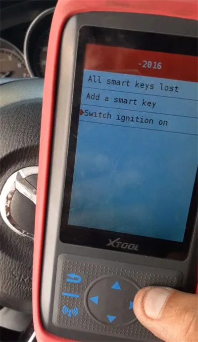

Select immobilizer-> Mazda V26.79-> Select by vehicle-> North America-> Mazda CX-5-> Smart key-> -2016
There are 3 functions supported: All smart keys lost, Add a smart key and Switch ignition on.
1. Switch ignition on
Follow the instructions on the screen to do.
Make sure all keys are taken out of the car.
Press and hold the start button for 10 seconds, the start button lights from green to yellow.
Then release and press the start button.

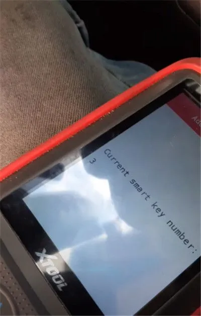

Configure out the current smart key number is 2.
Use a new smart key to contact start button.
Automatic step on the brake pedal, manual transmission step on the clutch pedal.
Configure out the current smart key number is 3.
Then switch ignition off. Next, complete the following steps in order to start the engine:
- Switch ignition off
- Slam the brake pedal, the key against the start button to start the engine 3 seconds, then turn off the ignition switch.
Finally, use the new key to test the remote and start the car.
