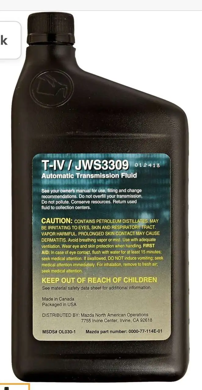

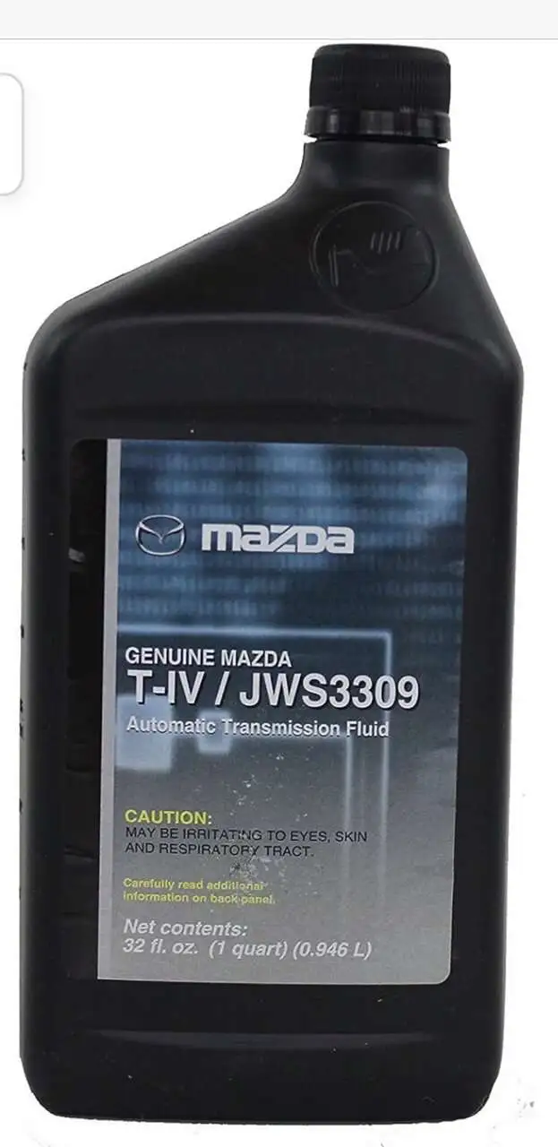

Vegas, what fluid is specified for your 2014? Is that a Ford transmission? If so, does it take one of the Mercon fluids? The 3309 is the spec that is also known at Toyota T-IV. You want a fluid that either IS the original spec or listed by the fluid maker as "suitable for..." that spec fluid. Valvoline Maxlife is one highly regarded multi-vehicle ATF that is suitable for many fluids.

These are made in Japan and use Aisin transmissions with the T-IV fluid. Fords use Ford transmissions that use Mercon fluid. They also have a dipstick and normal drain plug. When I took out the small drain plug the trans was at operating temp but a lot of fluid came out. I'm wondering if it was over filled at the factory. My moms Sienna has an Aisin and I was able to do a fluid exchange using the cooler lines but I couldn't fine and similar info for Mazdas. I think I'll do another fluid change.

You’re correct. The owner’s manual of 2014 Mazda CX-9 states that the ATF uses Mazda Genuine JWS3309.
And “Mobil ATF 3309 is recommended for use in transmissions requiring fluids of JWS 3309 or GM 9986195 quality levels. It is also recommended for service fill applications where Toyota T-IV or T4, T-III or T3 are called for.”
