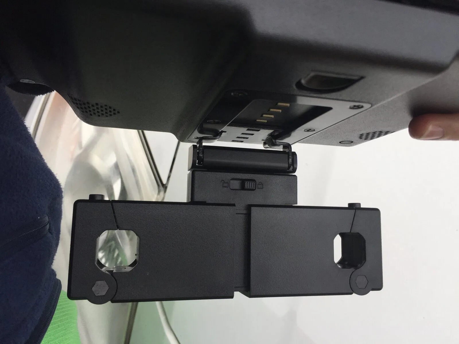

Greetings all and thanks in advance for the help.
I have searched through the forums and tried to find an answer to these questions (posts are either old or not quite the same). I have a 2013 CX-9 Grand Touring (just purchased today), and it did not have the headphones or remote for the factory overhead entertainment system. I have done some searching and the replacements seem well overpriced and not available through Mazda's parts store. So, with that in mind I have a few questions.
-Are the remotes programmed the same? (i.e. can I purchase something like this on ebay and use the headphones and remote right out of the box, or would I have to replace the whole unit?)
-Has anyone replaced the entire overhead unit with a more up-to-date overhead entertainment system and can offer some advice? Would the one linked above work? Is there one that fits the existing mounts and has better features (i.e. HDMI input, better screen resolution, headphone pairing options, etc.)?
Thanks again for any help. I am quite new to in car entertainment systems.

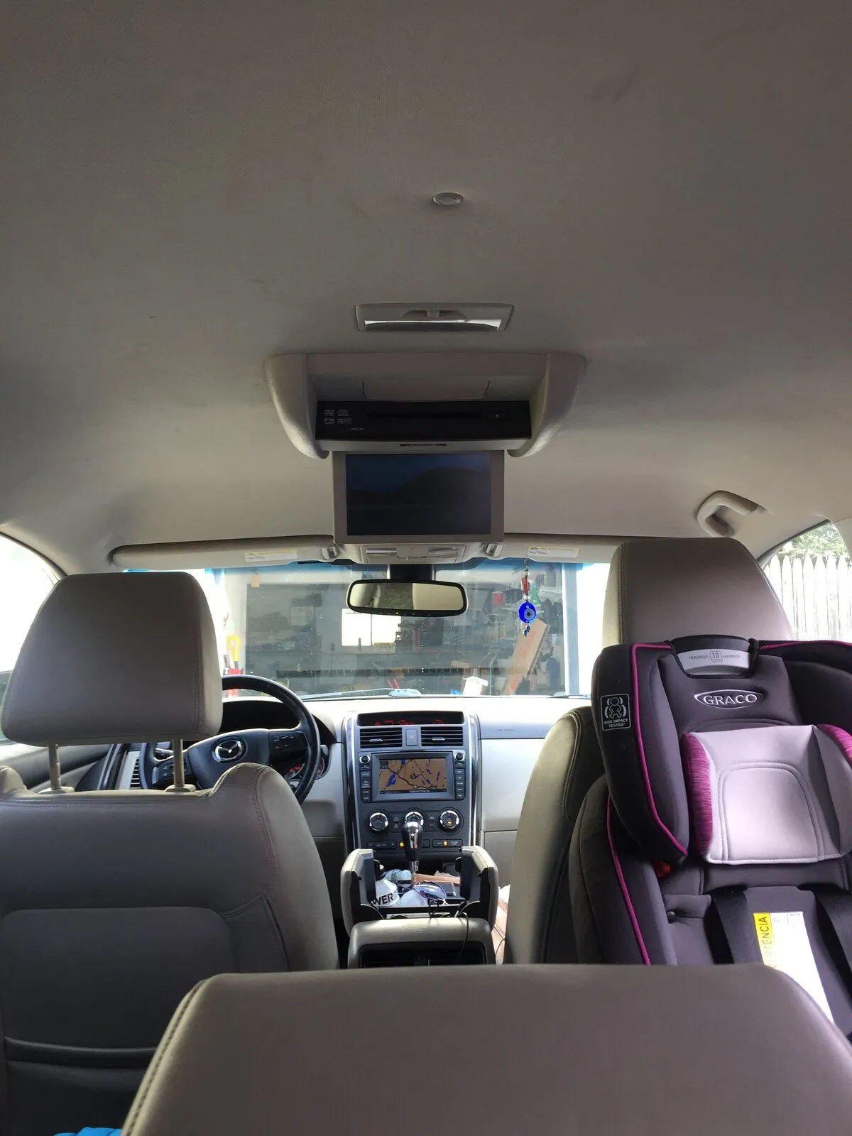

I have 2011 CX9 GT and planning to convert RCA port (video in-sound L-R) to HDMI in trunk.
My project is installing additional display (10") for my daughter. She is in car seat and facing to rear. So she can not see the ceiling unit.
Ceiling unit does not have any port so far I have seen on youtube videos. Only 2 sokets.

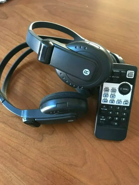

I bought a pair of used headphones and remote off e-Bay for $150. Put batteries in and voila.

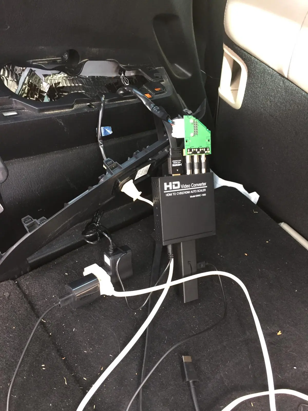

Finally, I had free time on weekend and tried to my project on the car. It worked great for me.
Why did I need this project? Because of the position of my daughter's car seat. She can not see the ceiling unit.
She likes mickey mouse clubhouse and it moved on Disney+. So, I use my spare amazon stick for this project. If I did not have spare one, I could buy apple tv .

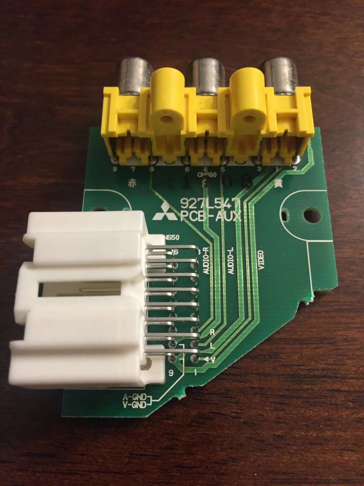

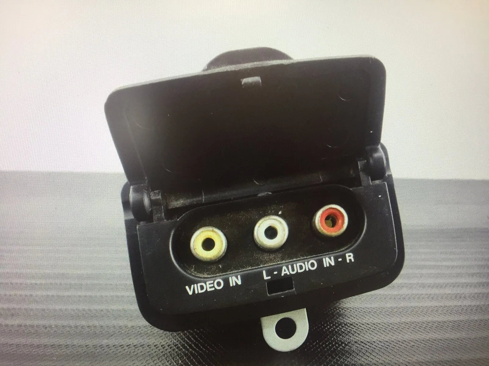

Original RCA Input in trunk

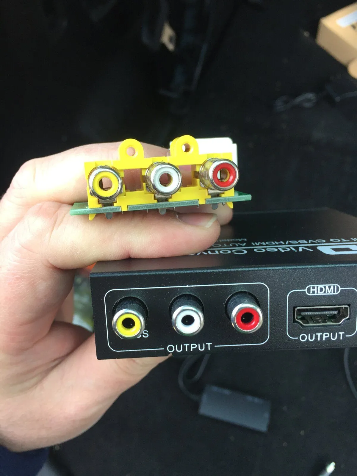

If you would like to modify the original adapter, this is the inside of the port.

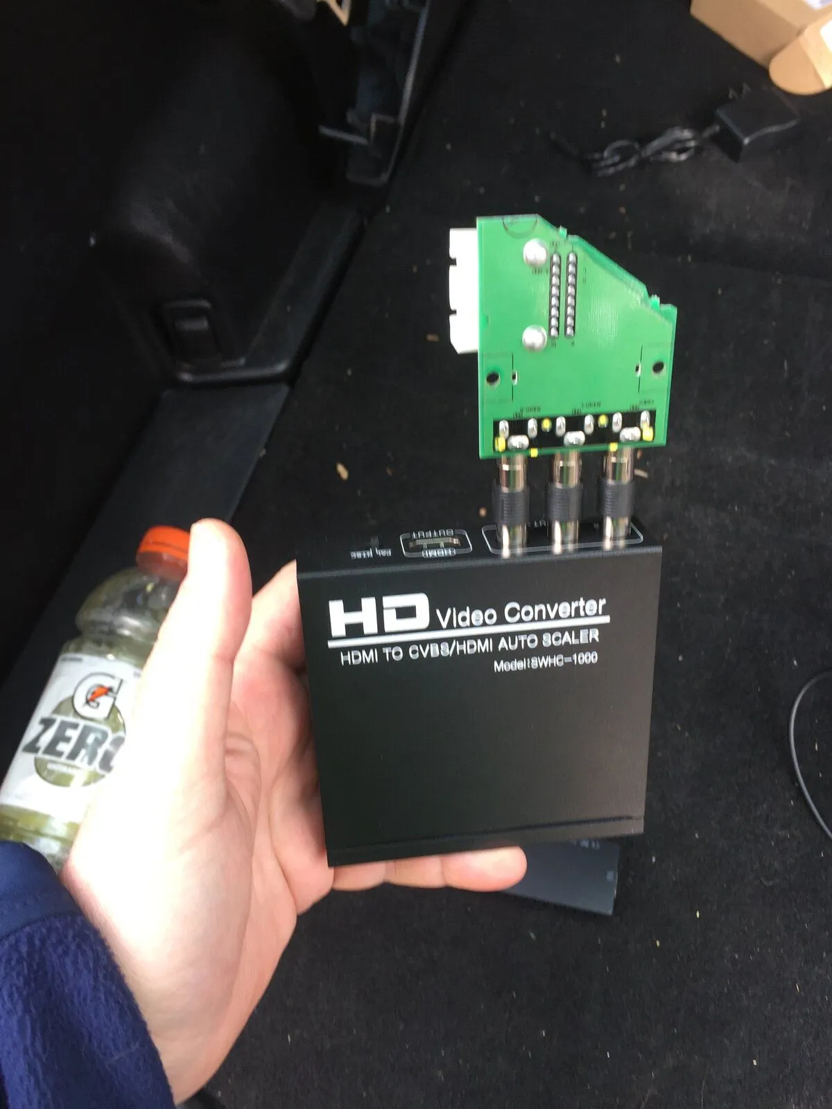

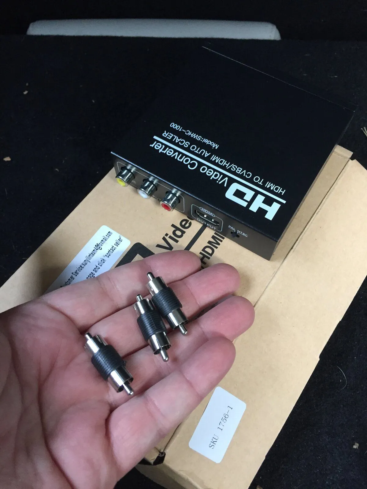

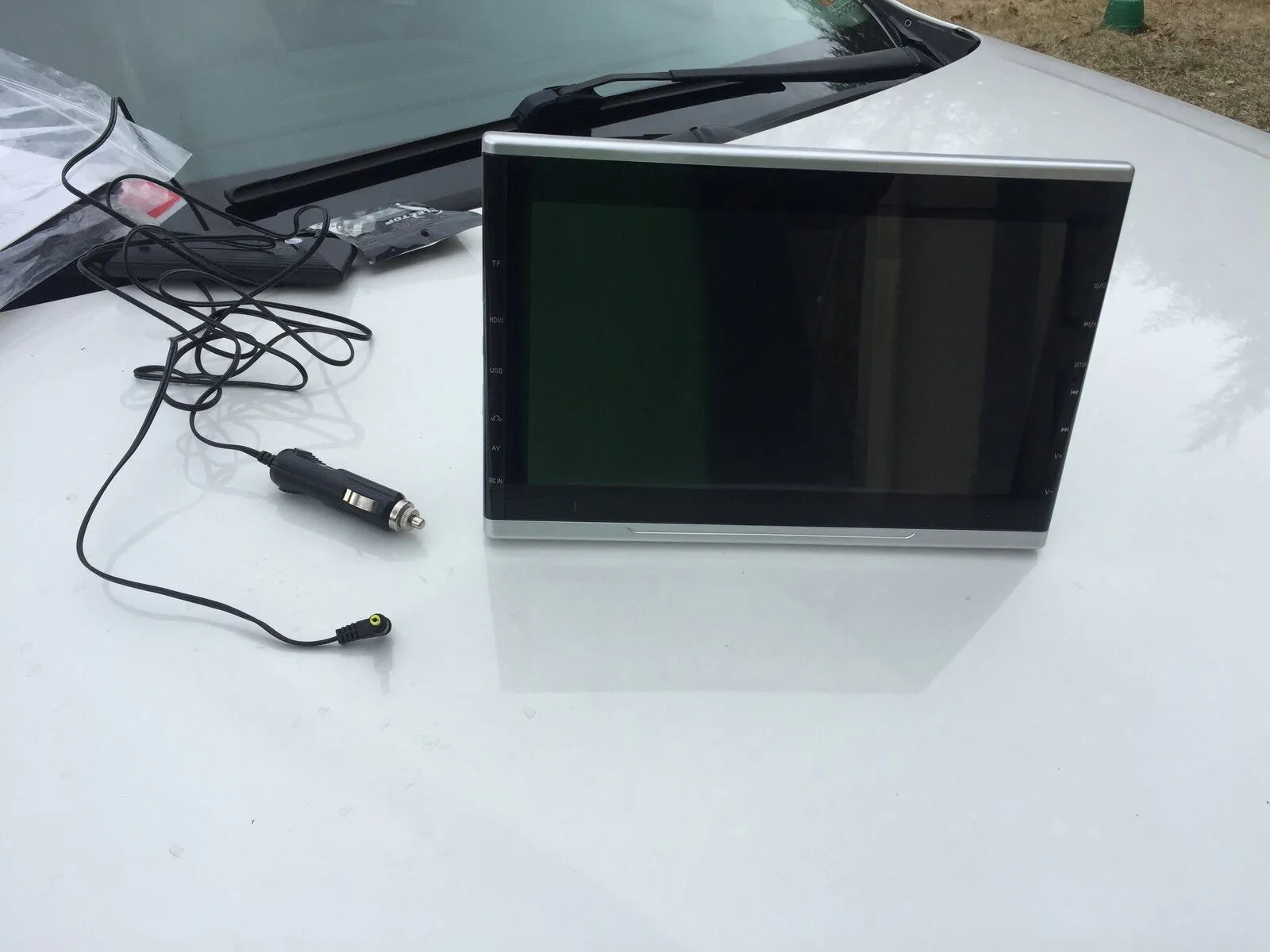

Part List:
1- 10.1" HDMI-in, DC input Display. ( DVD player and head rest bracket integrated)
2- HDMI to HDMI&RCA adaptor.
3- RCA coupler (male to male)
4- 10ft flat HDMI cable ( I need longer than 10ft. I could not install it under the floor liner)
5- Power strip ( I am still searching compact strip for making extantion for invertor)

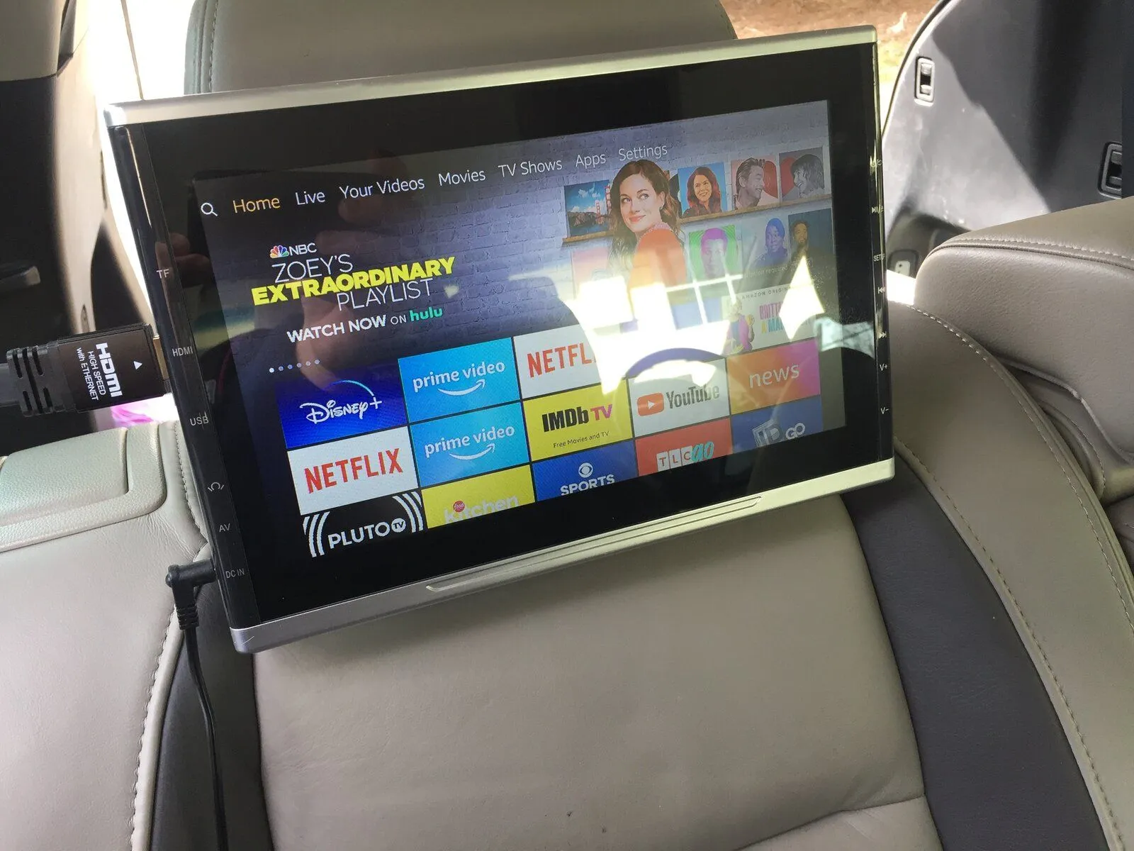

Result:
Additional display unit has built in speaker. It is enough loud. If I connect the firestick in trunk, It works on the bose and I can control it on the navigation display. If i want to listen music while my daughter watches cartoon, she can listen on the additional display.It has a remote.
