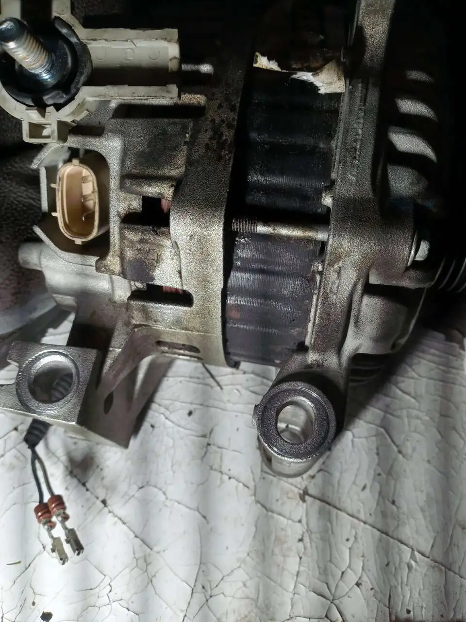

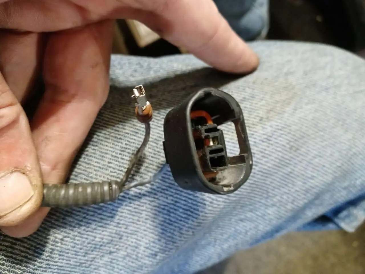

Alternator and battery are good.
Heavy gauge wire on alt is good.
2 wires (blue and grey) on alt connector have communication at fuse box plug, but are now a different color (blue/green and black). They also both show communication with a heavier red wire. I just want to run 2 new/separate wires, but not sure which is which.

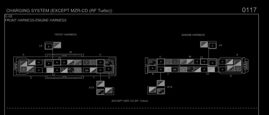

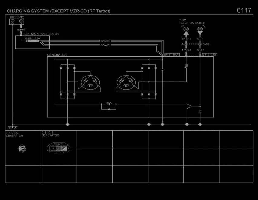

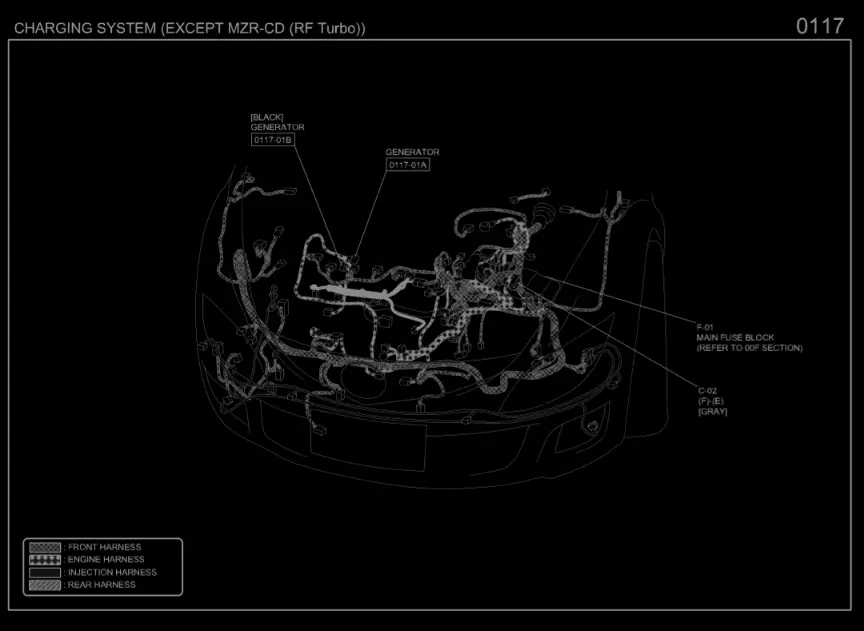

Wiring diagrams I found
Red/yellow and green wires shown

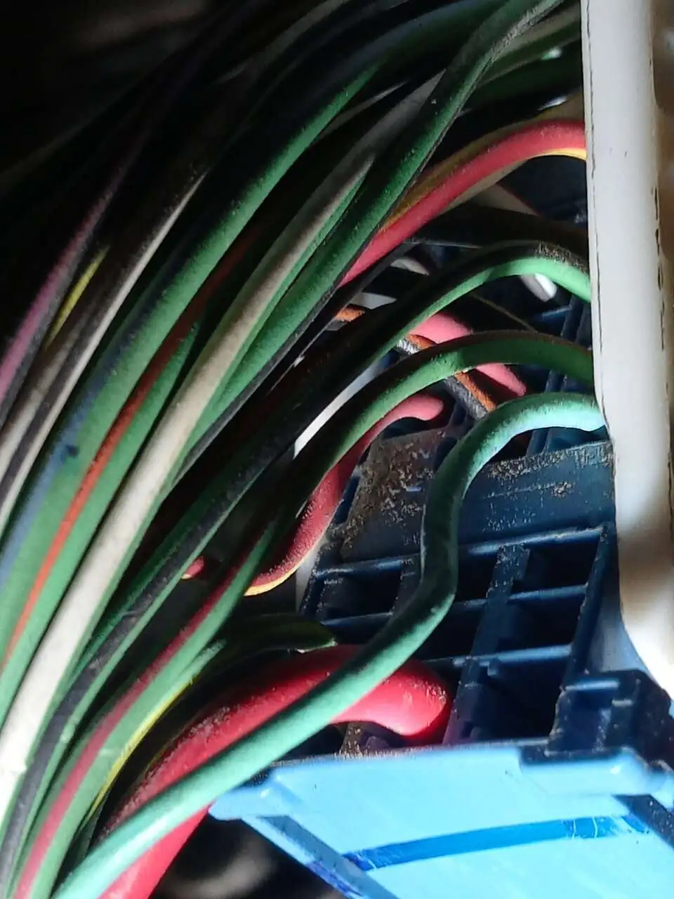

Photo of wiring harness connector at fuse box
Turns out it is not black like I stated. It is red/yellow.
The blue/green could actually be a lighter green than the other green wires nearby.
