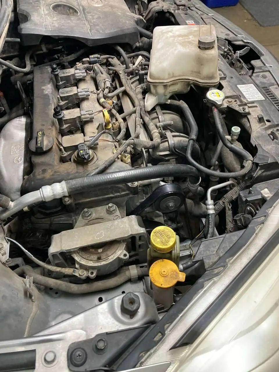

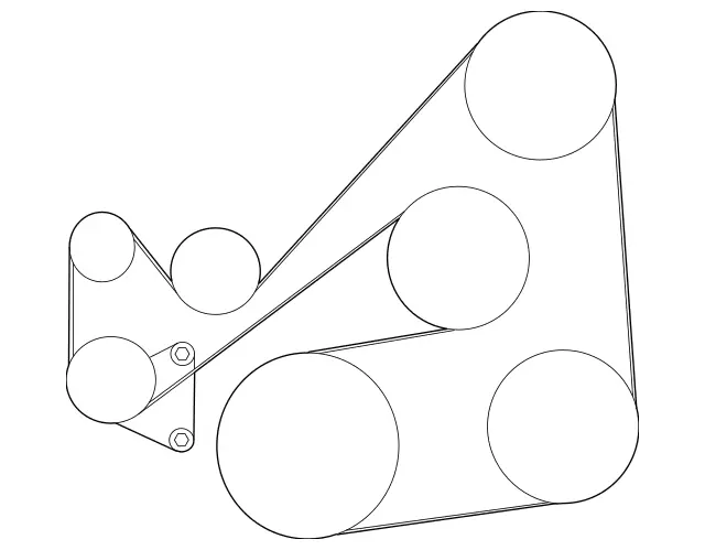

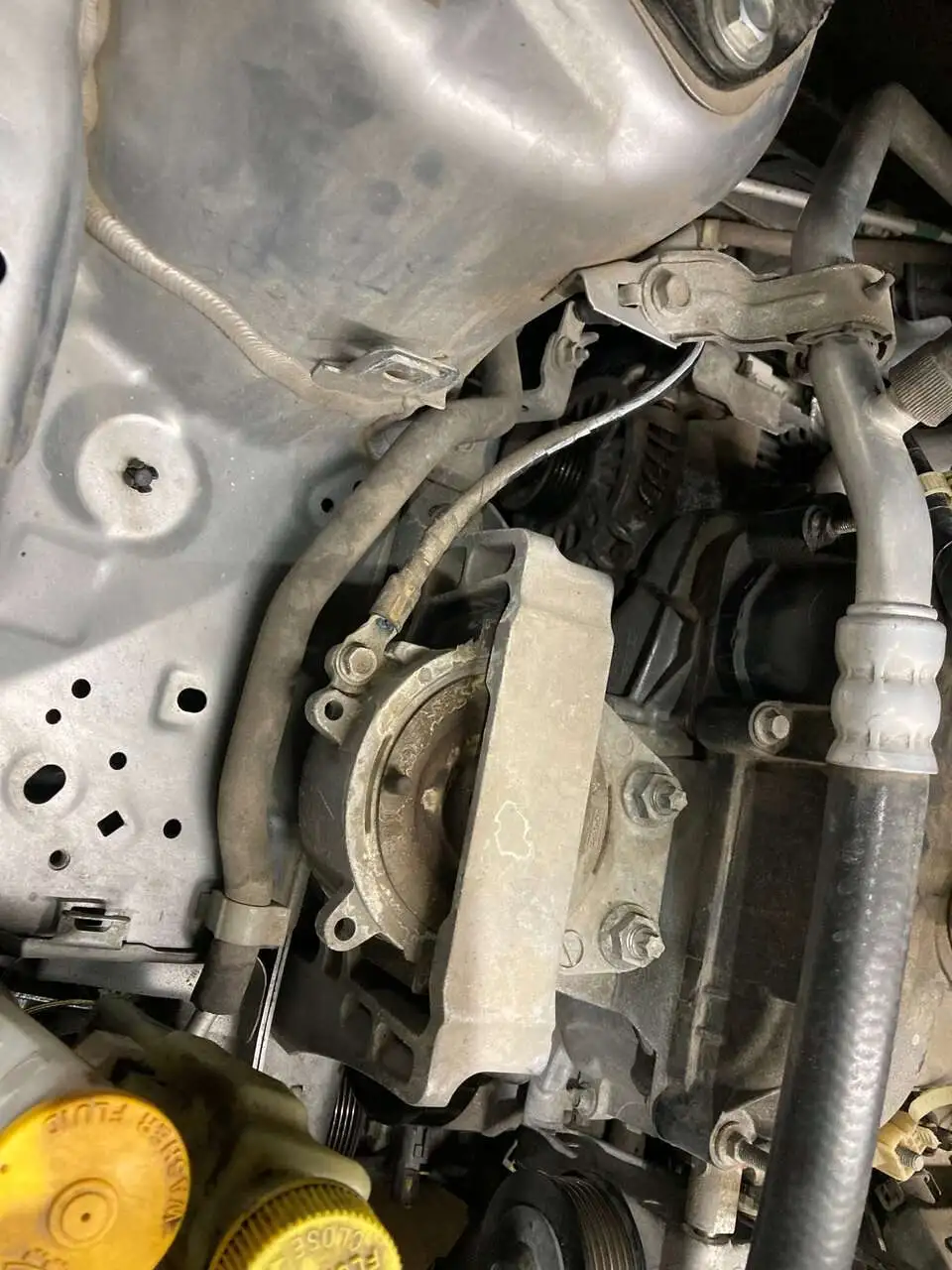

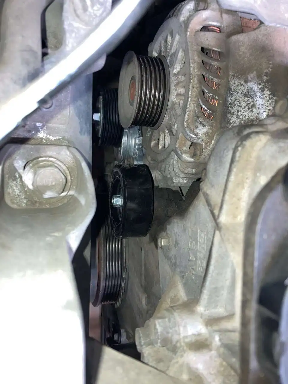

Parts finally showed up, so I did the serpentine work last night. Here are my notes:
  • I jacked the passenger side of the car so I could remove the passenger wheel and then the splash guard behind it. Looking back, there would be more room under the car if I had put it up on ramps, and I think the splash guard could still be removed with the wheel on.
  • I also pulled the full undercover/Air Dam, however I'm not sure how necessary that was, I suspect one could leave it hanging and still have enough room.
  • The tensioner bolts do not stand proud of other parts in the area (Crankshaft position sensor!) so a standard depth socket doesn't get your handle out far enough to turn. A deep socket is too much. A Swivel Head Ratchet would go a long way here. I made do by disconnecting the nearby hose mount and wrestling around/through the hoses with an additional 3/8" extension.
  • There is not enough room between the engine and wheel well to fit a 1/4" drive ratchet and 10mm socket to get the Smooth Idler off. It has to be done with a box wrench or I suspect those sockets that drop into a ratcheting box wrench would work, but I don't have any of those.
  • Getting enough torque to break the smooth idelr bolt with the little 10mm box wrench required a cheater bar. I used a large box wrench as a cheater.
  • I pulled the old tensioner first, then put the new one in. Pretty straight forward. If I was doing this again, I would pull the tensioner, then use the extra space to pull the Smooth idler.
  • I recommend pulling the Coolant overflow tank right out of the gate. It really opens up the access from the top. It snaps into place over some sheetmetal tabs, I used a flathead screwdriver to open the plastic slots to get it back off the tabs.
  • I highly recommend the tip mentioned in an earlier post for popping the belt back on using the grooved pulley rather than trying to use the tensioner from underneath. There is much more space to work up top. This! Just use a pry bar against the frame to push/pivot the pulley into place.
Tensioner pulley bearing was smooth, but bone dry. My smooth idler bearing was pretty rough, not wobbling yet, but it certainly wasn't smooth. Belt had some cracking, so I'm happy knowing I've got new parts in there.
All in all it was about a 5 torn glove job and maybe 2.5 hours total. Not too bad :)
Edit: Added last note.
