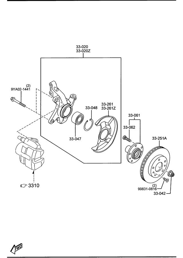

The parts diagram makes it look like you car replace just the bearing. However, getting the assembly apart might prove more trouble than just replacing both the bearing and hub. It I had to replace a bearing, I would do both.
https://www.jimellismazdaparts.com/...odel=14354&modelYear=2012&ukey_category=20263
You still have to press the new bearing into the new hub or spindle. Rock auto has a complete kit for 45 for each side which comes with a new nut and retaining ring as well as the hub and bearing. I would opt for that so that everything can be new.
I agree, but it easier to get new parts assembled, than it is to get old parts disassembled.
