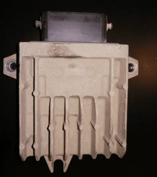

I had the same issue with my 2010 Mazda5 GT 130k km. AT light and Engine warning light went on. Mechanic friend ran diagnostics and thought TCM issue, but wasn't 100% certain but he said a new TCM was $1100. He told me to shop around for used or refurbished online and I found a company in Montreal Canada called Moduelpro (website says they specialize in automotive electronics repair and refurbishing). They sent me a refurbished one for $400 plus shipping and tax. Pleasantly surprised to recieve it within a few days and looking like a new TCM (does he sandblast the heat sink??) Anyway I crossed my fingers and had my mechanic install it and now the car works like a charm... no AT or engine warning lights, no clunking gear change sound.... transmission shifts smoothly now. I mailed back the old TCM by Canada Post ($12) to Modulepro and received a $100 refund by e-transfer the next day.
I had the same issue with my 2010 Mazda5 GT 130k km. AT light and Engine warning light went on. Mechanic friend ran diagnostics and thought TCM issue, but wasn't 100% certain but he said a new TCM was $1100. He told me to shop around for used or refurbished online and I found a company in Montreal Canada called Moduelpro (website says they specialize in automotive electronics repair and refurbishing. They sent me a refurbished one for $400 plus shipping and tax. Pleasantly surprised to recieve it within a few days and looking like a new TCM (does he sandblast the heat sinK??) Anyway I crossed my fingers and had my mechanic install it and now it car works like a charm... no AT or engine warning lights, no clunking gear change sound.... transmission shifts smoothly now. I mailed back the old TCM by Canada Post ($12) to Modulepro and received a $100 refund by e-transfer the next day.
Thanks for sharing. I've got the same issue with my 2010 Touring. Did your mechanic have to do any programming once the refurb unit was installed- or was it "plug & play"?
Rick (Phoenix, AZ)
Rick (Phoenix, AZ)
No programming was required, it came plug and play. A guy named Roman from Modulepro called me (?!) within an hour of purchasing and made sure it was a TCM issue and said no programming was needed and I let my mechanic know. Bonus, he had a return guarantee if it wasn't a TCM issue. I hope that helps.
