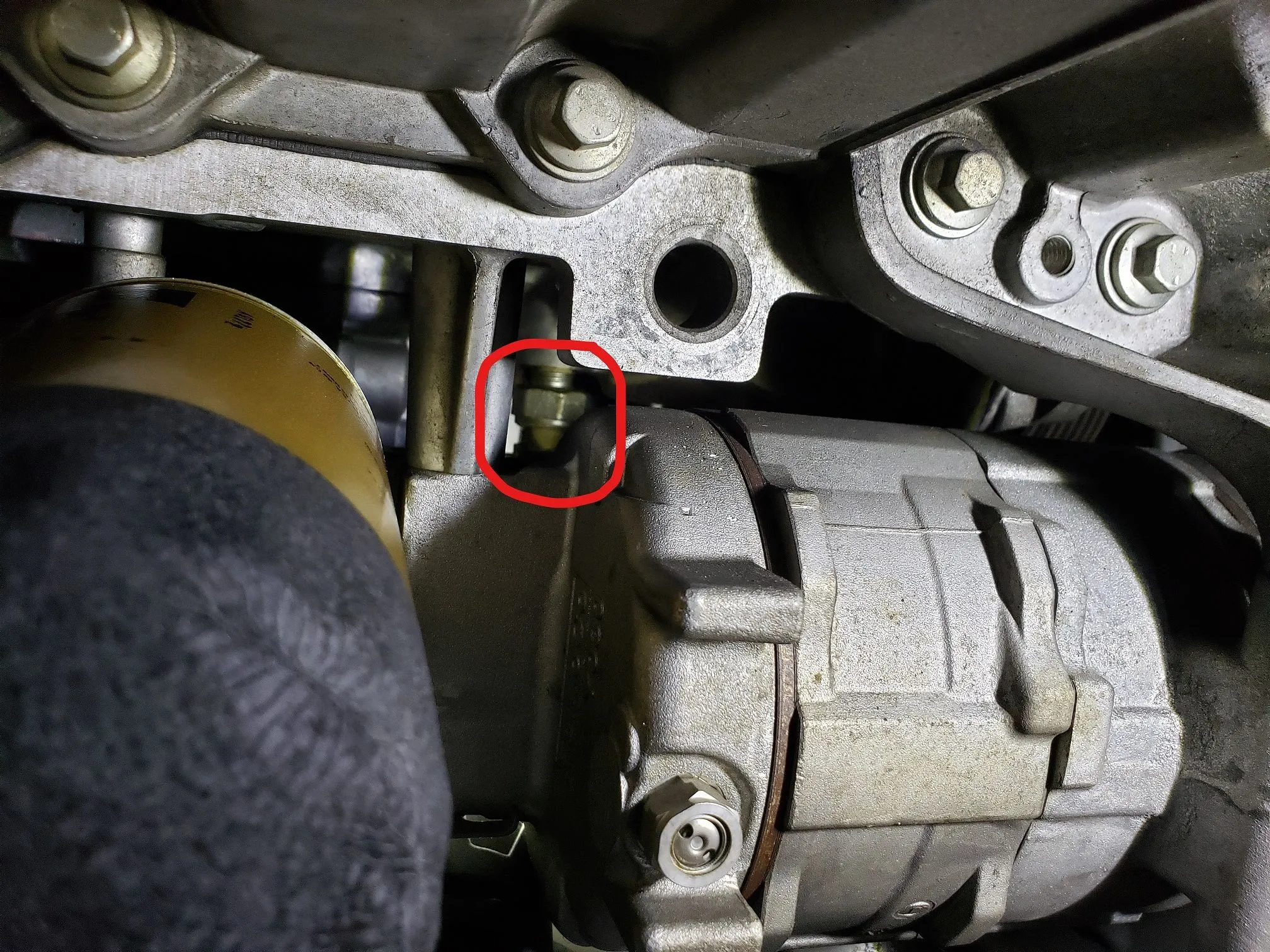

Also, do you, or anyone know where the oil pressure switch is located, is it by the oil filter? I saw a half a$$ drawing when I did a search within the forum, it wasn't very detailed.
Does anyone know if the red circle in my pic ( CX9_Oil_Sensor.webp ) is the oil pressure sensor? The pic is from under the car looking up, to the left in the pic is the oil filter. If that's it, how in the heck do you access it to change it, or even attach a oil pressure gauge to test??
Does anyone know if the red circle in my pic ( View attachment 221711 ) is the oil pressure sensor? The pic is from under the car looking up, to the left in the pic is the oil filter. If that's it, how in the heck do you access it to change it, or even attach a oil pressure gauge to test??
Hard to say if you're right looking from below, but see here:
https://www.mazdas247.com/forum/showthread.php?123864057-2008-CX-9-Oil-Pressure-Switch&highlight=oil+pressure+switch
